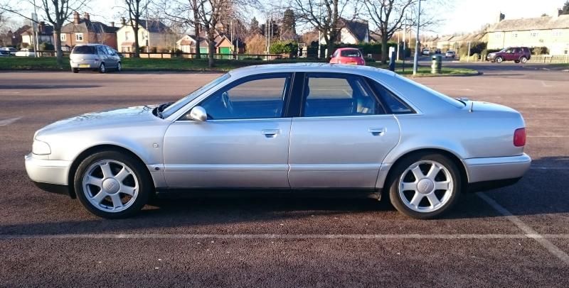

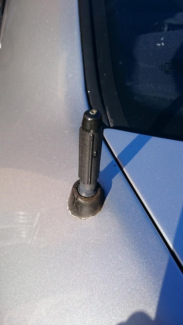

Hi. I have a fixed aerial on the NSR wing and a GSM aerial on the OSR wing. The phone has long since departed.
I believe the radio antenna was the flexible type with a mast length of about 30cm.
This is a side pic of my car.

and the antenna:

The GPS antenna is the lump in the centre front of the boot lid.
The NSR wing antenna looks like it's for a phone (at least) so did your car once have an OEM phone kit?

That's the same what I got, one aerial for phone/GSM and radio. The one on the boot lid is for GPS. Give a shout to forum sponsors they should be able to supply you one, details at the top of page. It should just unscrew from the outside so no need to dismantle anything, but A8parts will confirm how to change it.
