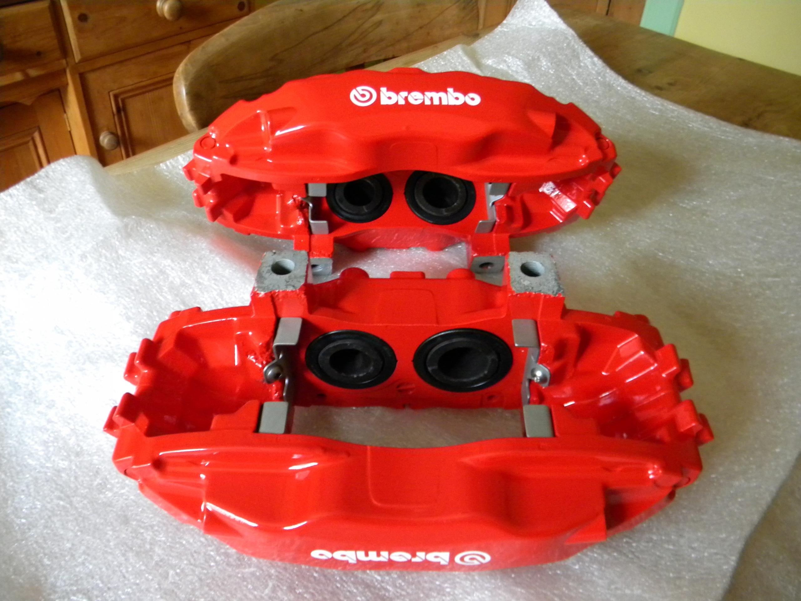

I've done some searching and I've found a couple of options. The first is that the pistons are corroded and I need the caliper refurbished, or a new one. The second is from a comment by Zip in another thread:
"You may well have the classic corrosion problem under the stainless plates at either end of the caliper that the pads track along. The corrosion lifts the plates proud of the caliper body, and can stop the pad fully retracting when you release the brake, causing the pads to drag on the discs and over heating them."
For option 1, would there be any issues with only replacing one caliper (new or refurbed), and for option 2, does anyone have any pictures showing these? I've checked the Service Manual PDF for the braking system, but it doesn't show these plates.

You can see them clearly on the photos of my refurbished calipers: http://forum.a8parts.co.uk/attachmen...7&d=1379181239
...and you can clearly see where the corrosion has been ground away under the stainless plates, where the new finish is "pitted". Those plates need to be absolutely flush and square in the calliper, or the pads will not retract properly. Indeed, if too much is ground off, the pads will rattle around in there once the plates have been screwed back in. I'm not sure I have photos of mine, but I'll have a look. They were pretty bad pre-refurb.
