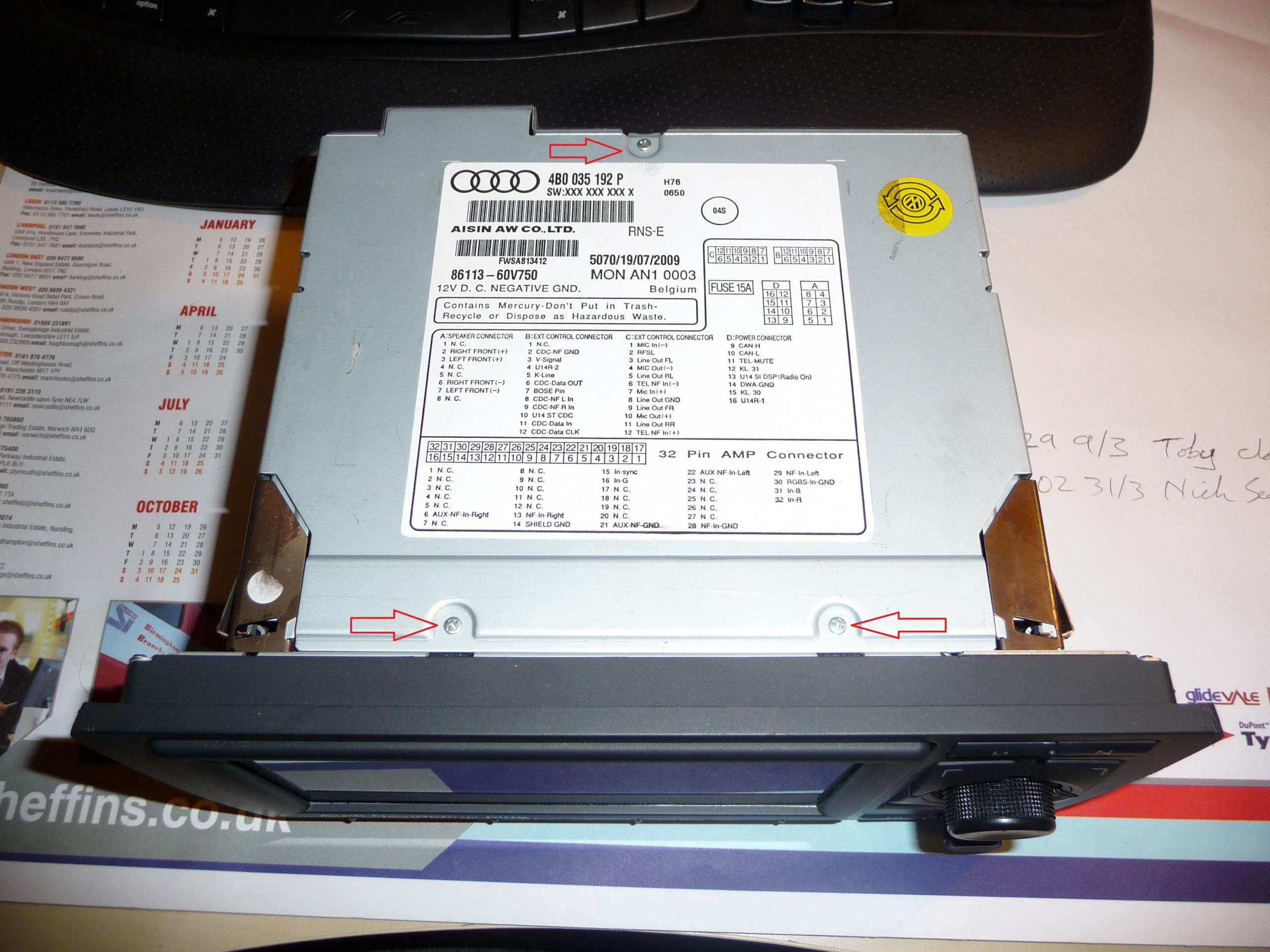

With the RNS-E removed and on the bench, getting access to the laser and transport for cleaning is really easy:
Remove the 3 marked screws from the top
Then remove 1 screw on each side:

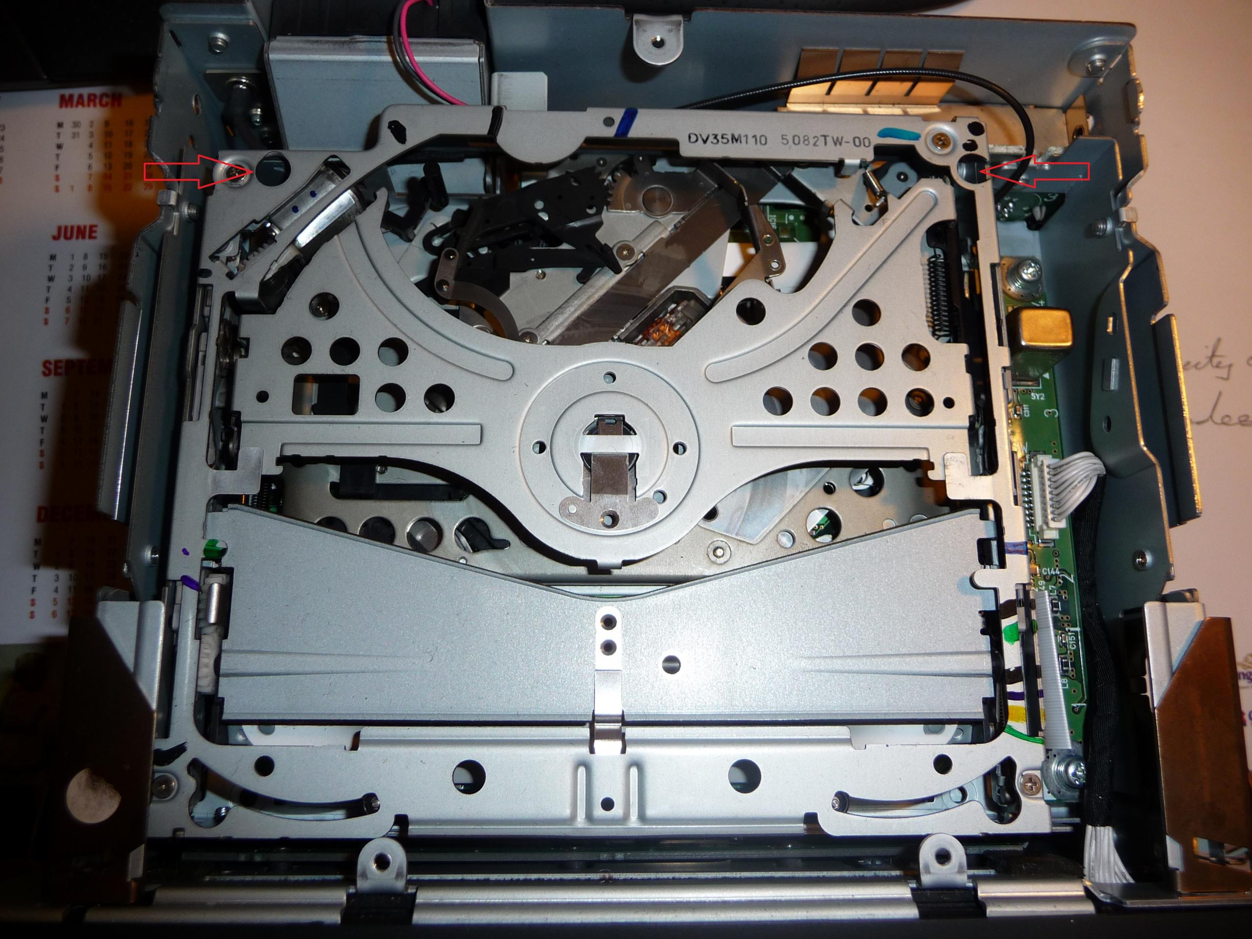

Lift off the lid and this is what you'll find:
The laser head itself is hidden under part of the metal frame, but you can get to it with a cotton bud soaked in IPA if you want to give cleaning it a go - the earlier the better if it's showing signs of weakness.

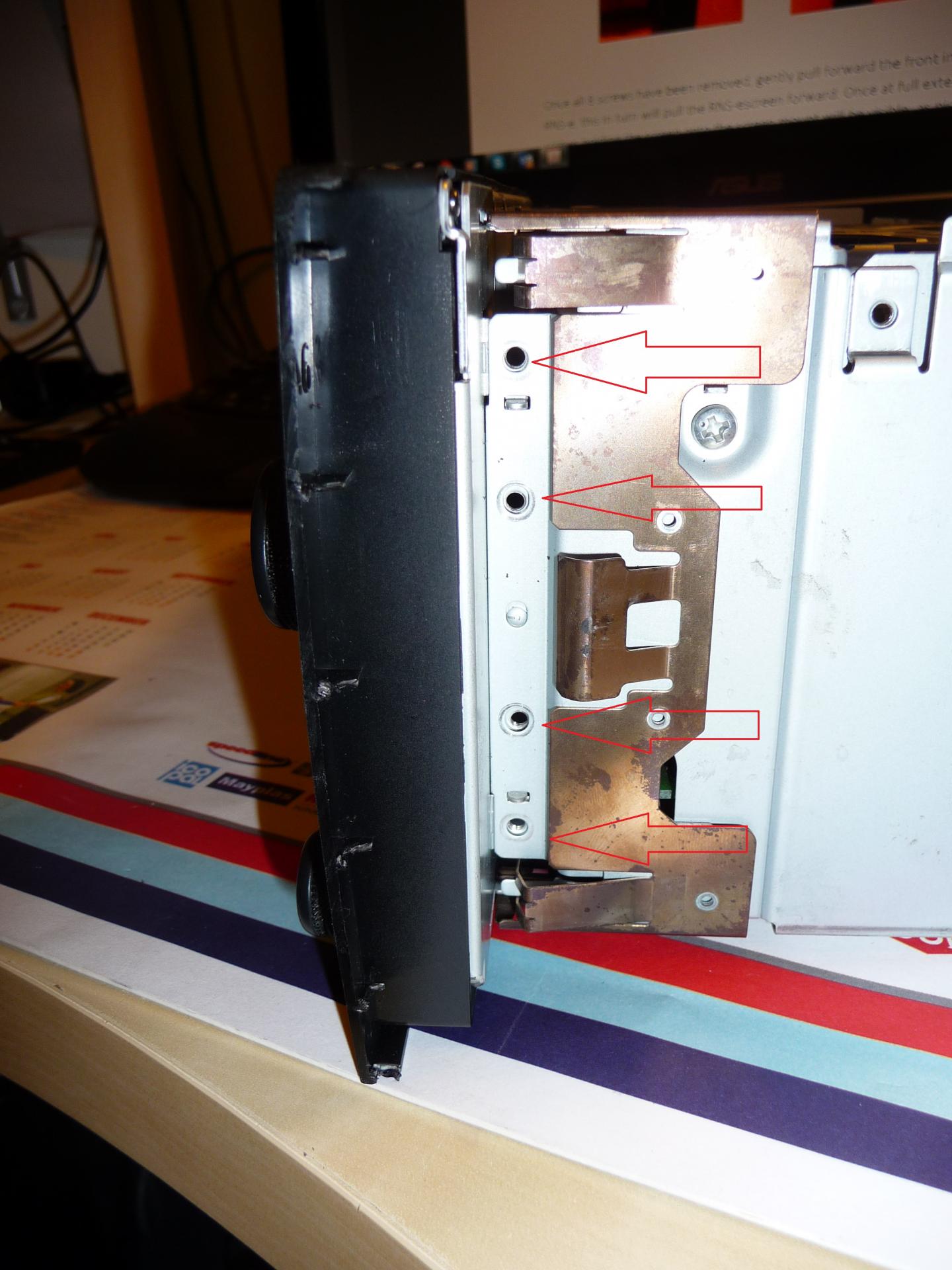

To remove the drive you then need to free up the faceplate by removing 4 screws on each side:
You can then very carefully work the fascia forward a little - this will pull the screen forward as well. You're not trying to remove the fascia at this point, so once you've pulled it forward a little if you push it back you want to be able to get hold of the bottom of the screen and then pull the screen forward on its mechanism. Watch out for the spring underneath which you really do not want to break!

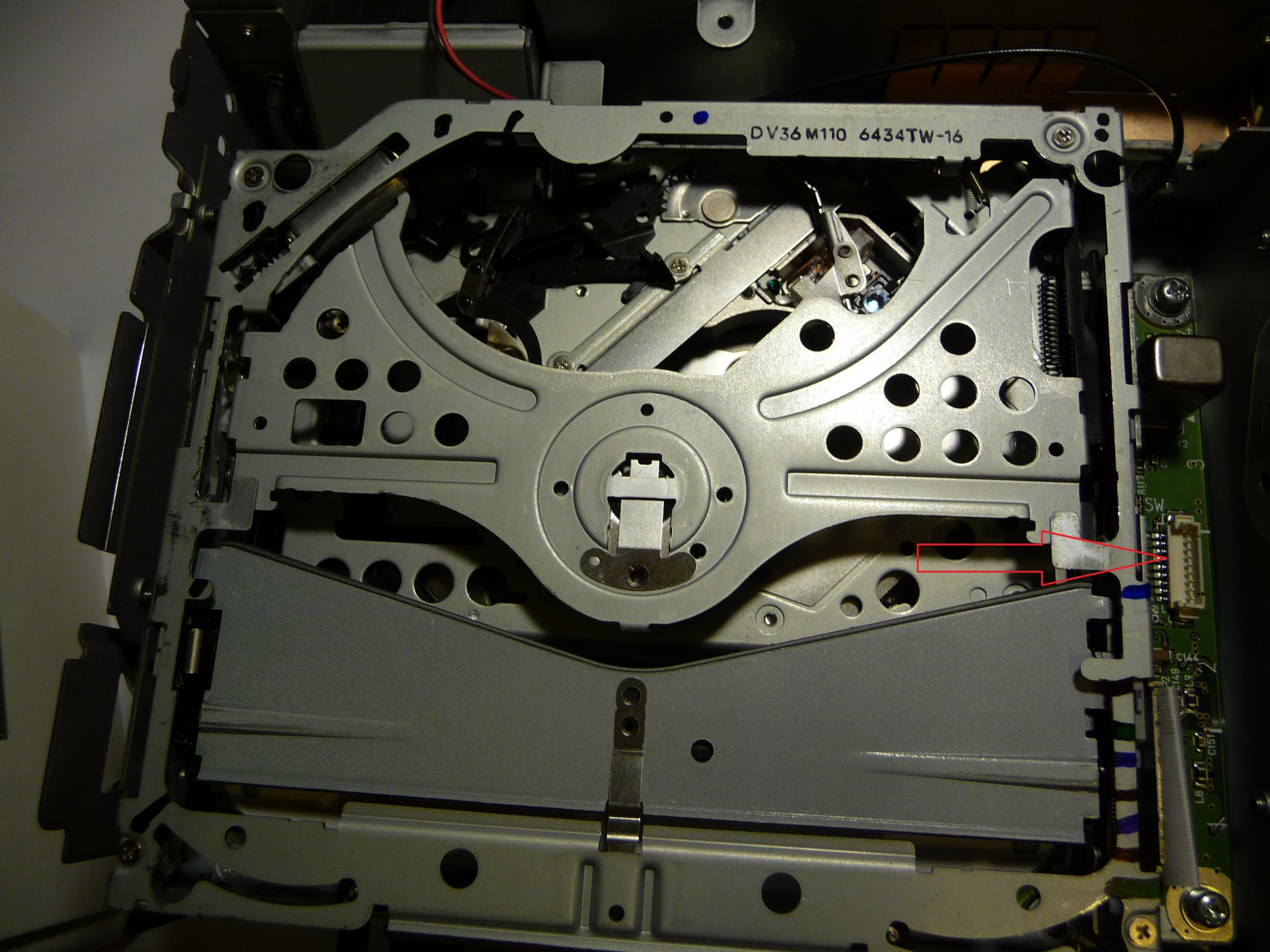

To get the disc transport out you only need to remove 4 screws. The 2 on the front:
And less obvious from the guide are the rear ones:
These are fiddly to get to so when I reassembled I put the rear screws into the holes before going near the main unit, to avoid having to try and fish them out of the inner recesses of the main unit!
Once the screws are out you need to release another ribbon connector underneath the drive - this one has 2 plastic clips, 1 on each side, which release with finger pressure.
