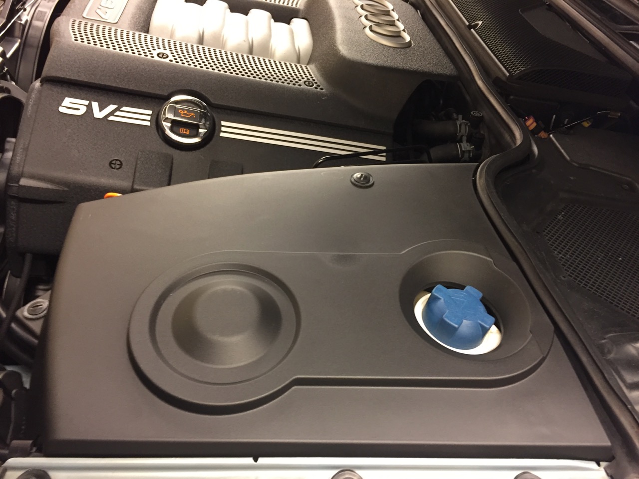

Now this is just another example of 3.3 V8 treasure -- decorative cover for coolant and steering fluid tanks. Audi calls it sound deadener.
It neatly hides both reservoirs and creates a nice balanced picture under the bonnet, decorating the horrible unused space on the nearside (left side).
The cover can be fastened and unfastened real quick with a coin.
In unfastened position the fasteners won't be lost since they are held in place by nice rubber washers.

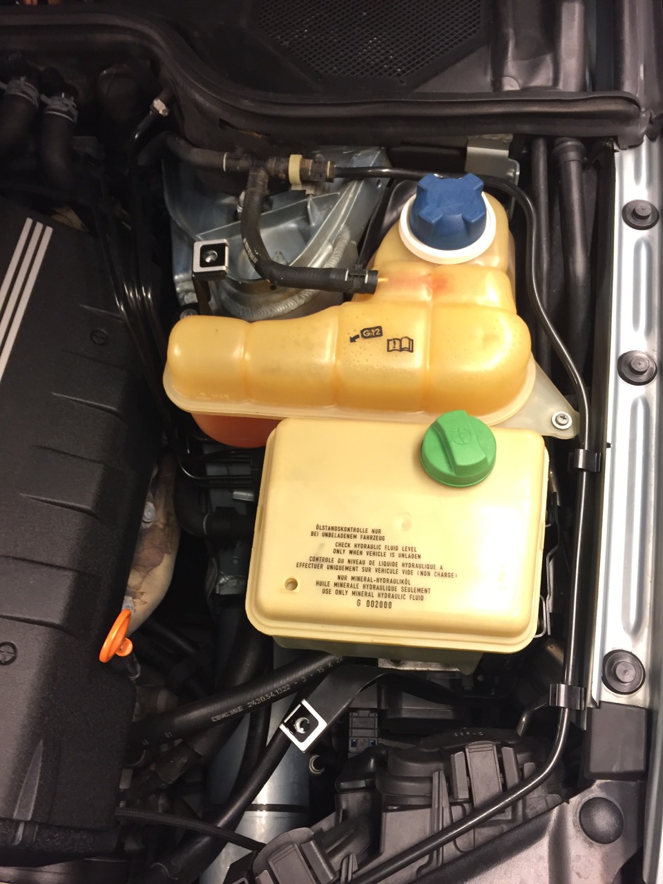

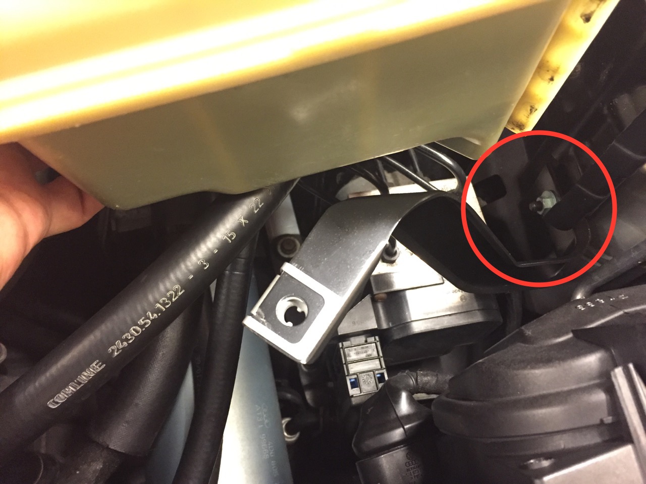

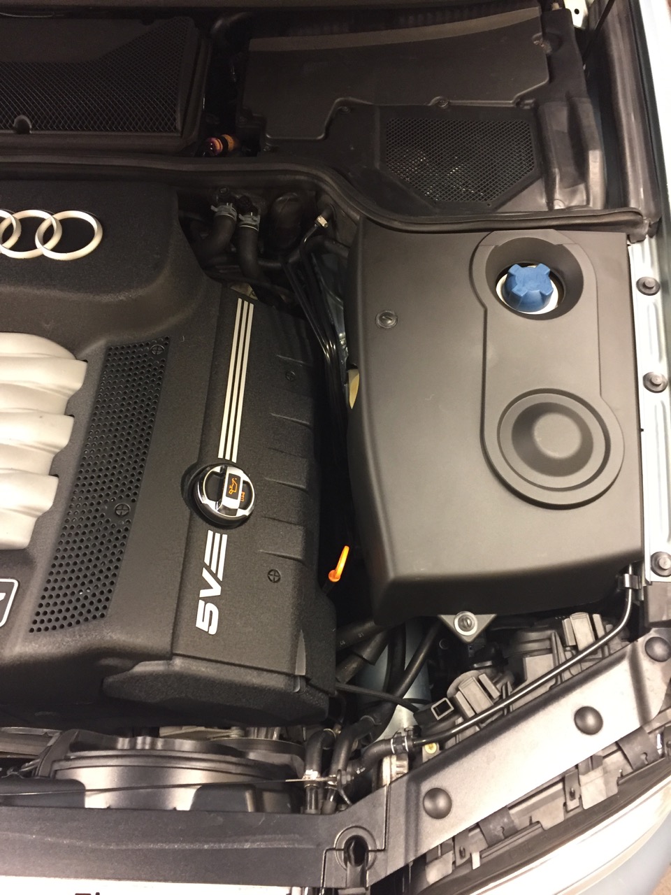

One thing you need to add to this list is one M6 nut (ideally 'washer nut' with a bit of a shoulder or simply a nut and a washer, don't know part number).
Audi or TPS will be more than happy to supply.
This M6 nut attaches the front bracket to pre-existing black bolt that sticks out of steering fluid reservoir bracket and is specifically designed to hold the cover bracket.
I believe that black bolt pre-exists on all facelift D2s (perhaps pre-facelifts will need a hole to be drilled in the bracket for the bolt, but I'm not sure).
That M6 bolt and M6 nut are clearly shown on 1st picture.

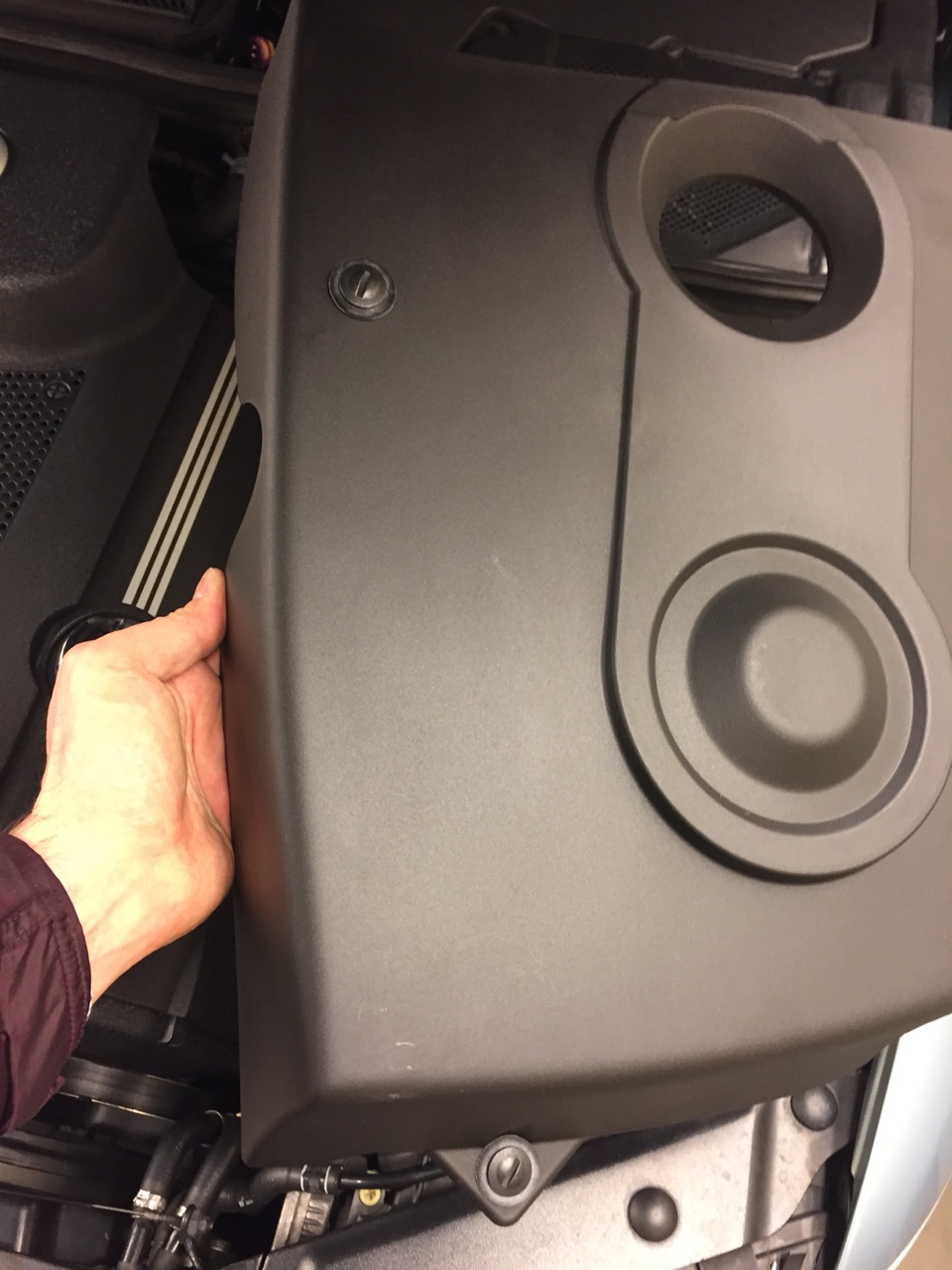

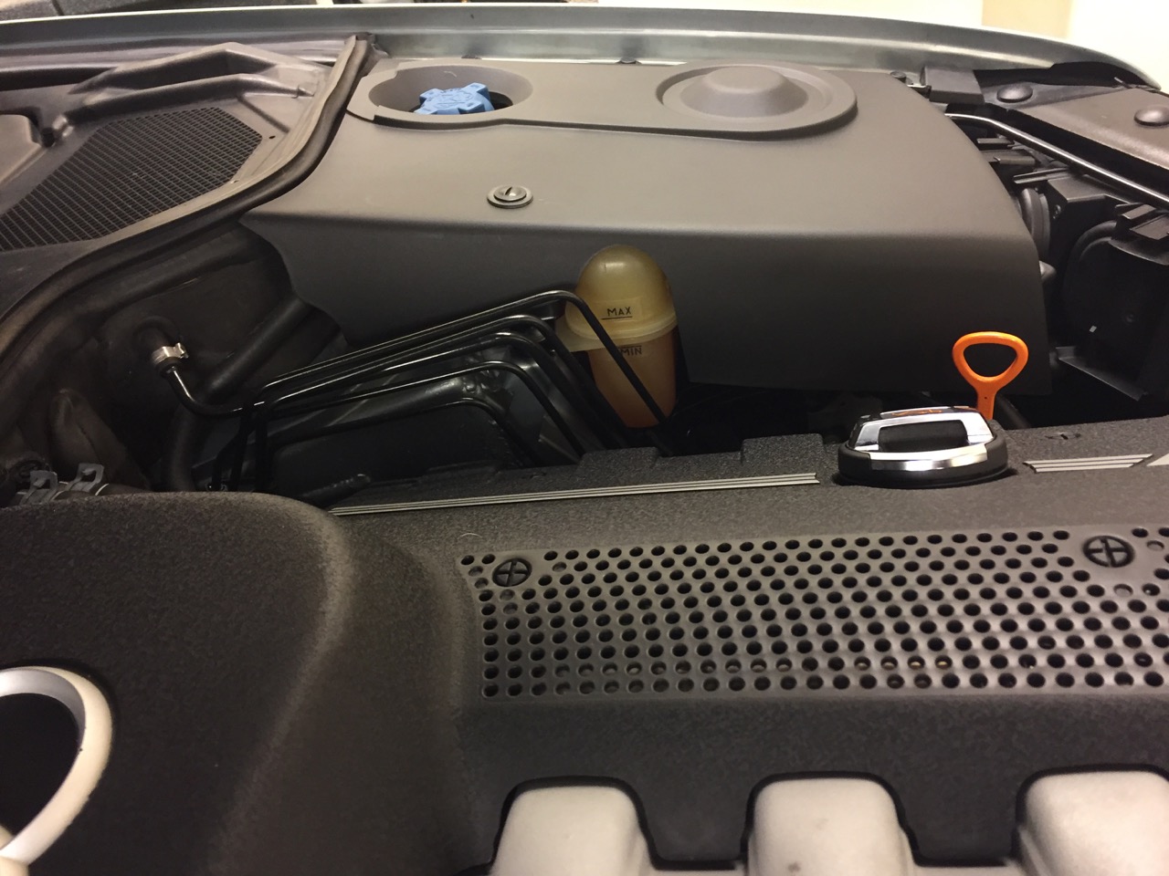

Second (rear) bracket is attached via existing Philips screw that holds coolant reservoir. Can be seen on picture 3.

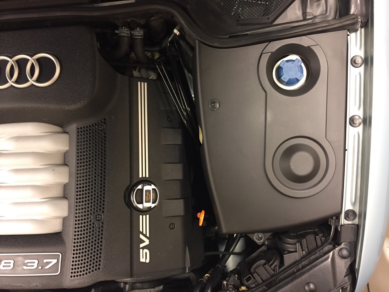

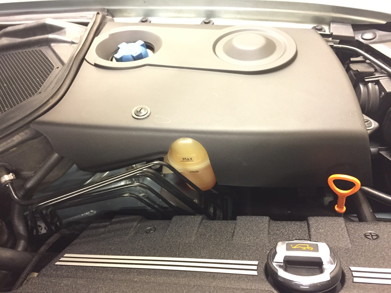

The 3rd fastening point is a clip on the back of cover panel that attaches to air conditioner pipe.
Not clearly seen in the corner of picture 5, but it'll be bleeding obvious when you install the whole thing.
Everything fits nicely. Parts are pleasure to work with.
