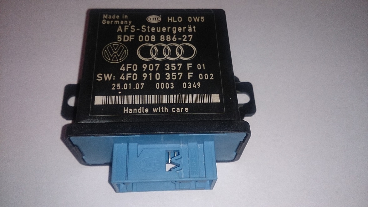

Just managed to get latest (blue connector) Xenon Range control unit for £35 !!!

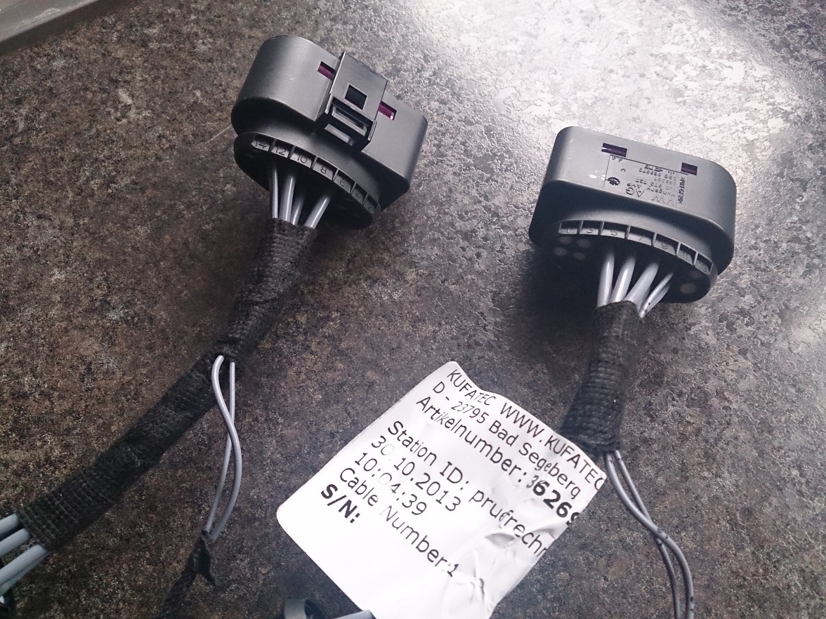

What you will need:

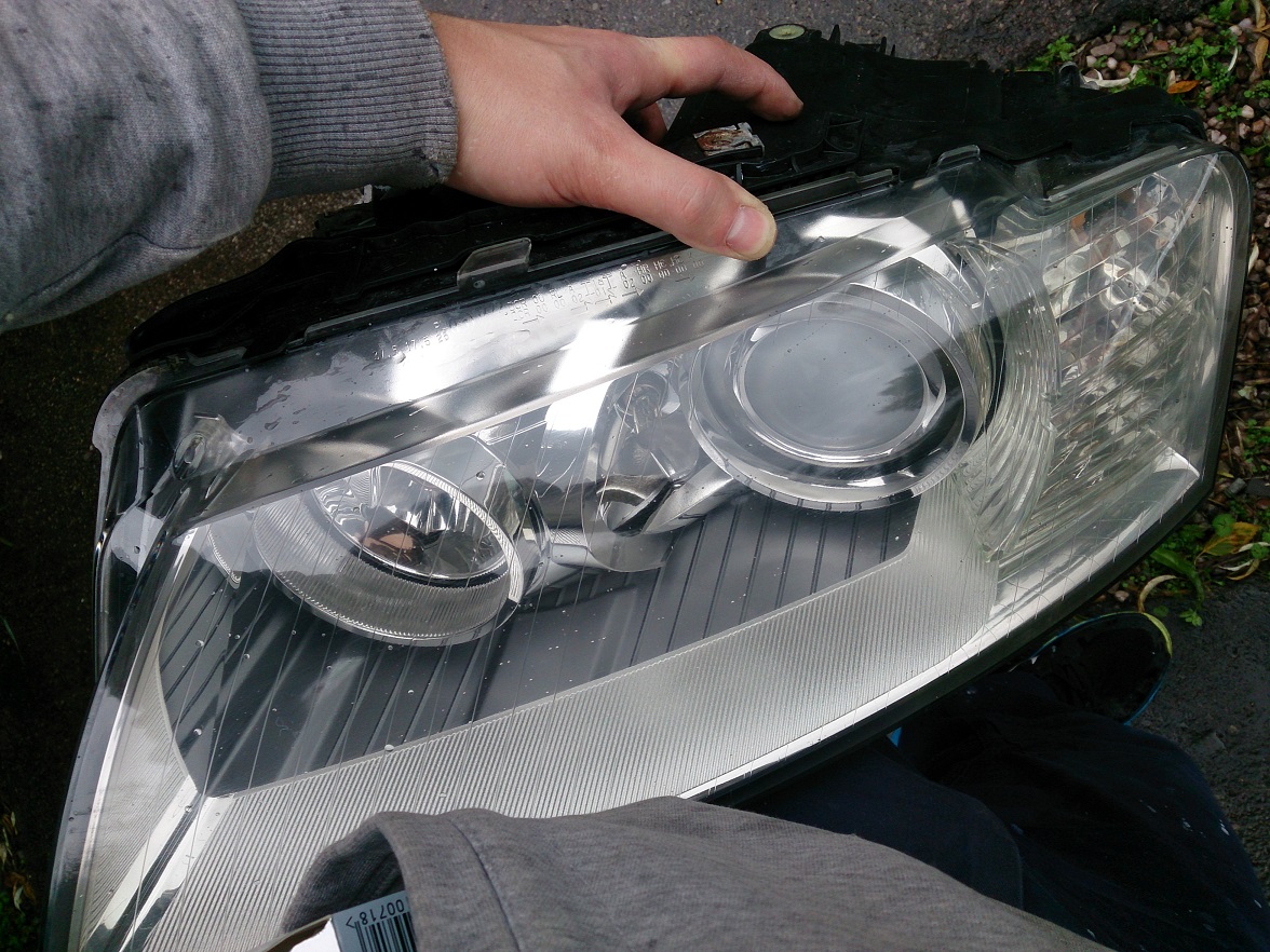

Bi-Xenons AFS headlights of course
Kufatec harness, product no. 36269 - £50

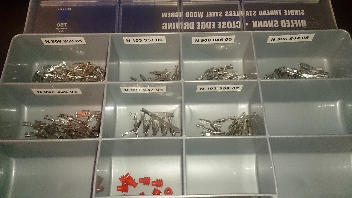

Various terminal connectors, approx £30-£40, see another reply for prices and PNs, exact quantity and PNs not know at this point hence I purchased a variety of them
2x rolls of cloth tape, £6
Xenon range module, eBay - £35-£50

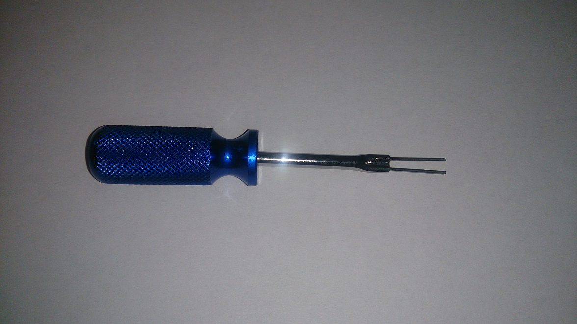

Terminal connector extraction tool, £10

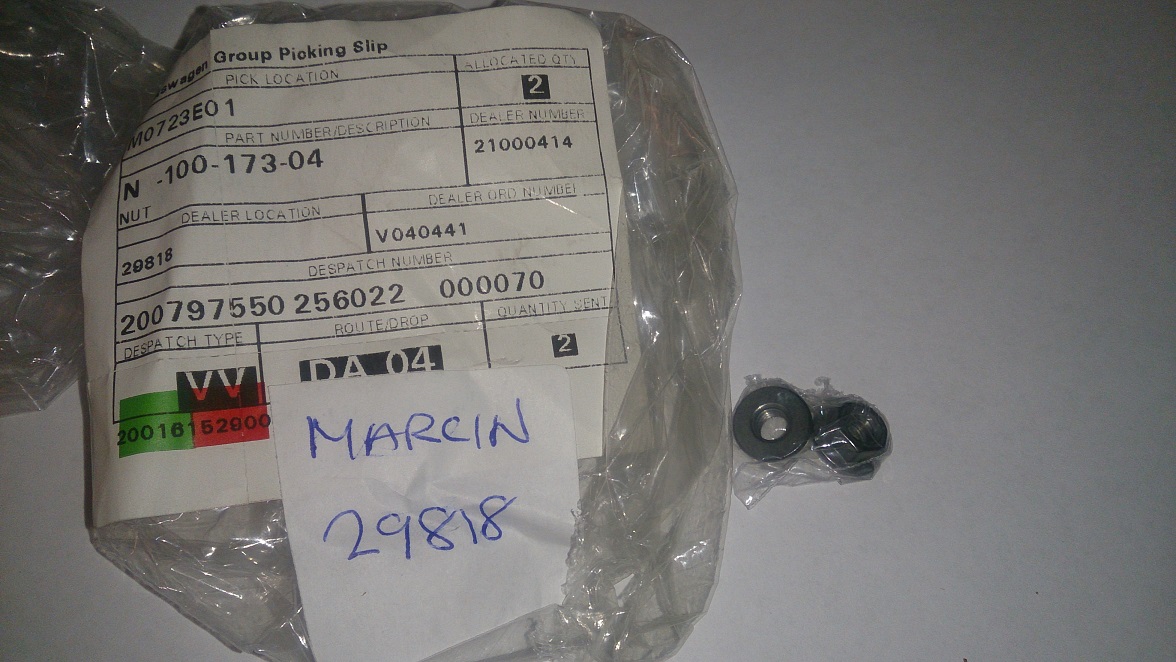

2x nuts, £0.20 +VAT
2x bolts, £0.20 +VAT

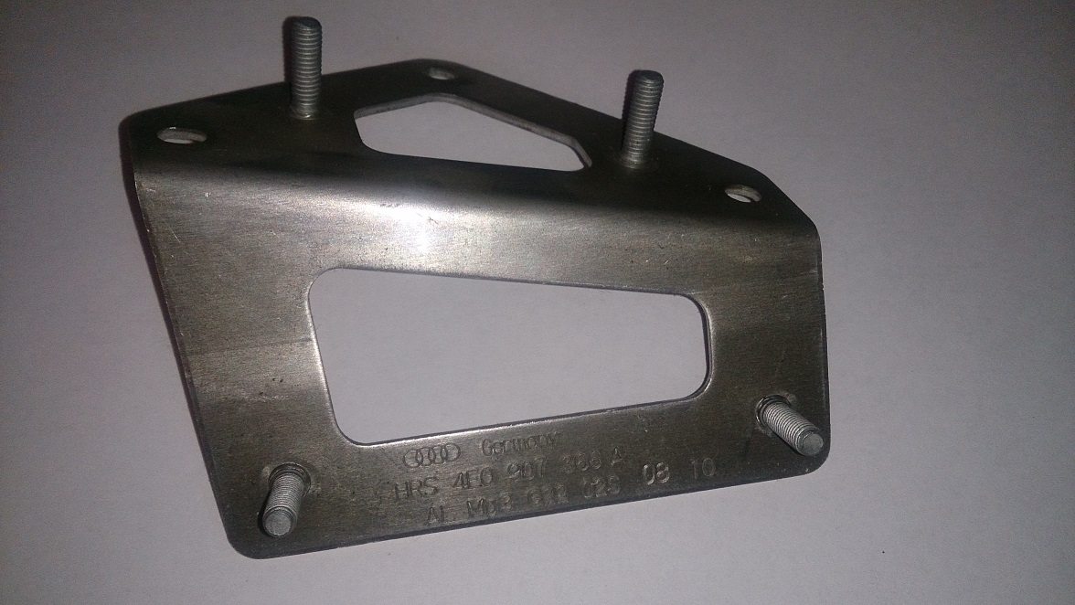

Xenon range module bracket, £6.20 +VAT

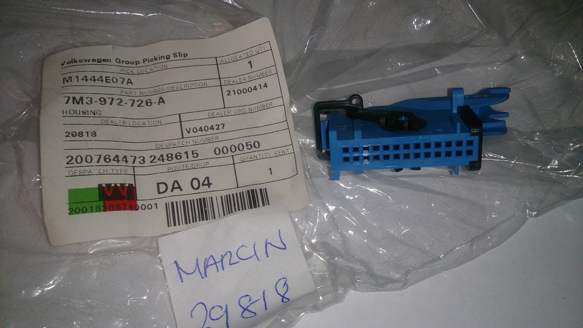

Xenon range connector, £3.30 +VAT

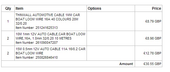

1mm and 0.5mm cable (black, brown, grey, dark green, bright green, purple), approx £30

Fit new headlights.
Important!!! Halogen headlight use 10pin connectors and Xenon and Bi-Xenons 14pin connectors.
That's why you need a harness from Kufatec

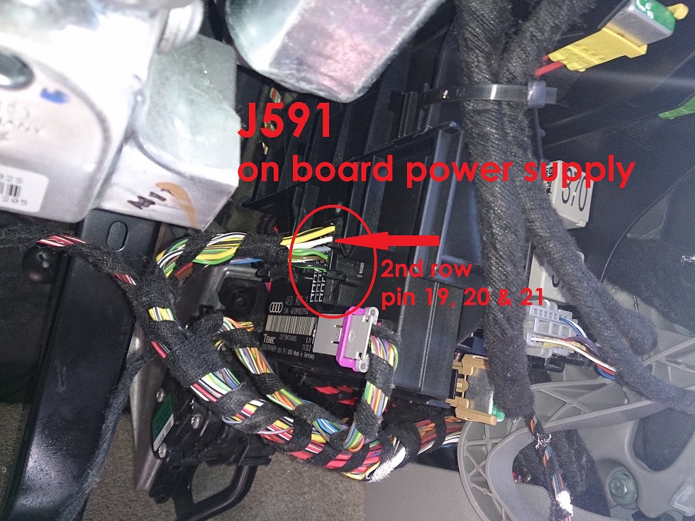

Connect your headlights using the harness and feed the wires as per pictures below.

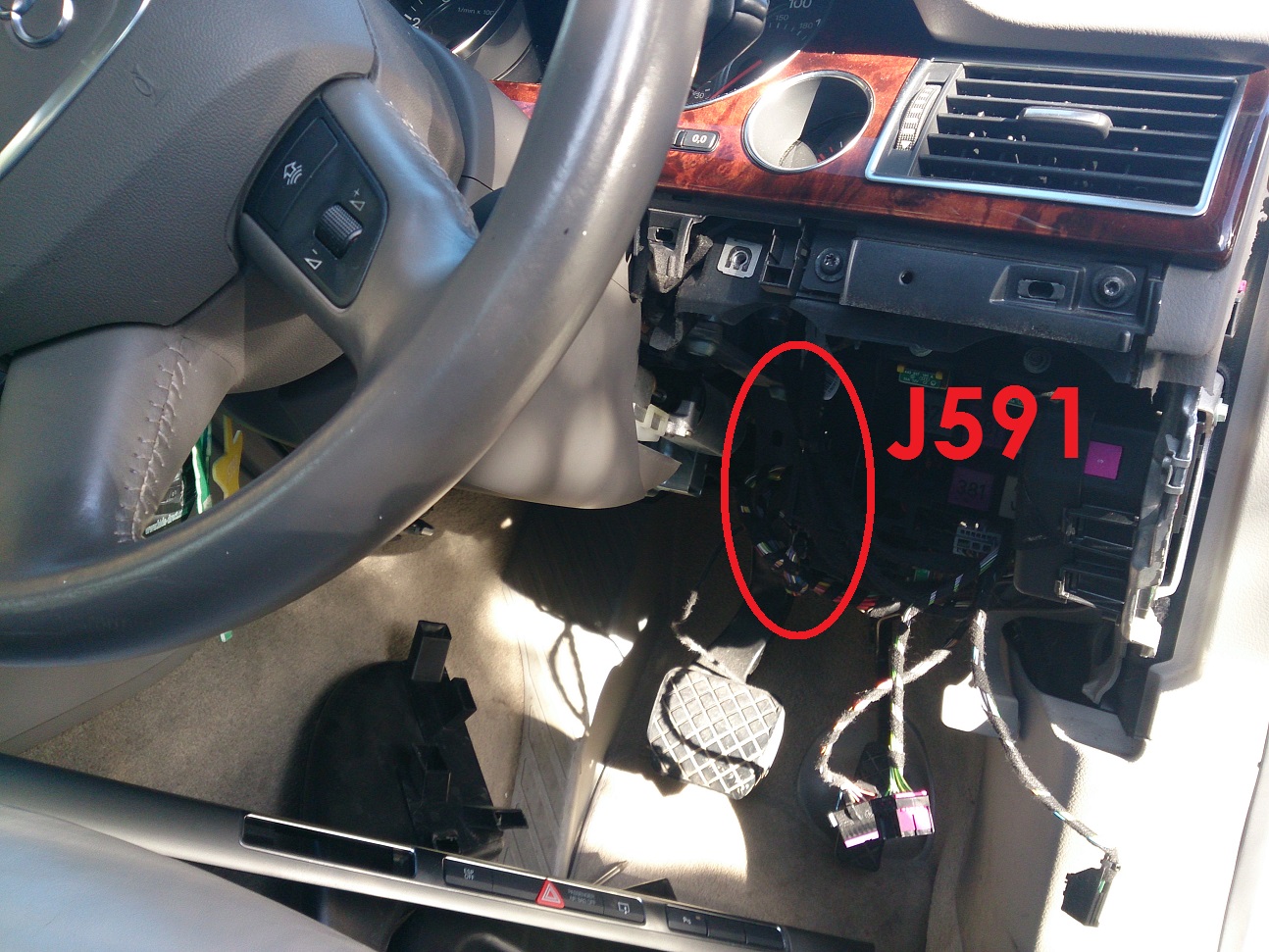

You will need to remove the glove box so you will also need tools to get the CD changer out.
Wires will have to go behind the glove box, behind the central console and under the steering wheel to J591 on board power supply.

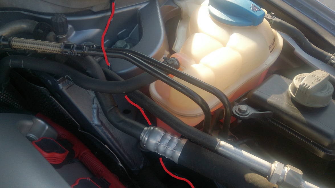

Route for the wires
J591 location and connection
Two wires with one contact are DRLs.
Single wires are Bi-Xenon left and right
24pin connector on J591.
Locations:
19- Left Bi-Xenon
20- DRLs (left+right)
21- Right Bi-Xenon

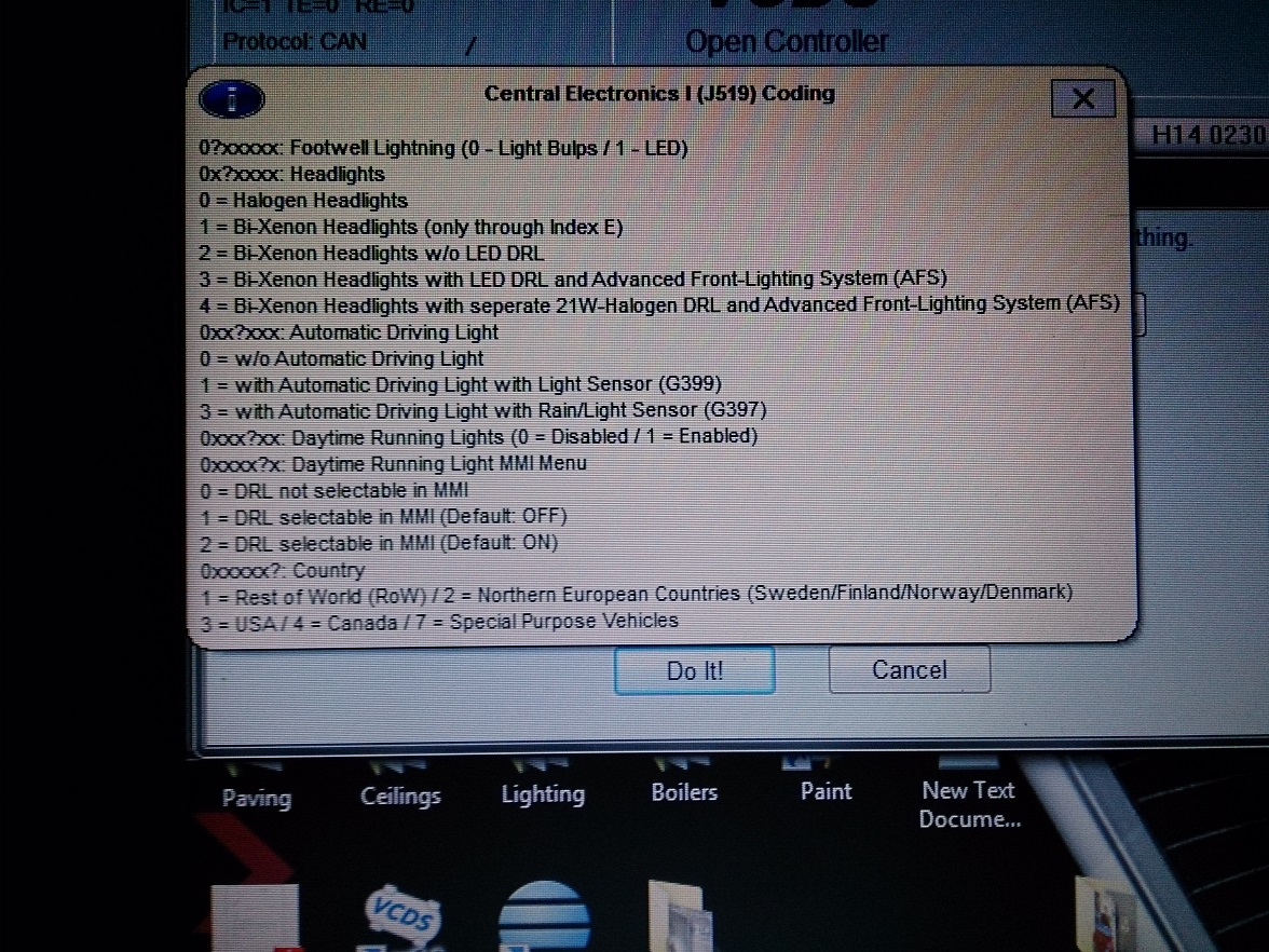

CODING via VCDS
[09] Central Electronics I
[Coding]
[Software coding]
ENTER 0143121 for Bi-Xenons with AFS and separate halogen P21W DRL with Automatic Driving Light with rain/light sensor, ENABLED DRLs and set to default
Change your coding accordingly to set up you have.
If you are going to swap your P21W halogen together with 501s sidelight for LEDs as per this thread
http://forum.a8parts.co.uk/showthread.php?t=7192
...then change 3rd digit to [3] IF you have AFS, but follow the above guide (wiring) so the DRL and sidelight are on the same loop
