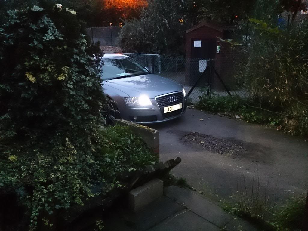

And the effect:
[IMG][/IMG]
[IMG][/IMG]
[IMG][/IMG]
[IMG][/IMG]
[IMG][/IMG]

Check the pictures again, both bulbs are always on and no matter if it's night or day you can't see any yellow light whatsoever.
