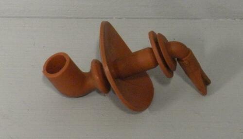

1. Orange drains from aircon condenser tray, one each side of the transmission tunnel behind interior trim (which needs care and knowledge to get out undamaged)
- Full instructions on how to do this can be found at the following link: http://www.audipages.com/Tech_Articl...tordrains.html
- Ensure you have a large enough container to capture the water when you remove these, and prior to refitting, soak them in hot water to make them more pliable. They look like this:

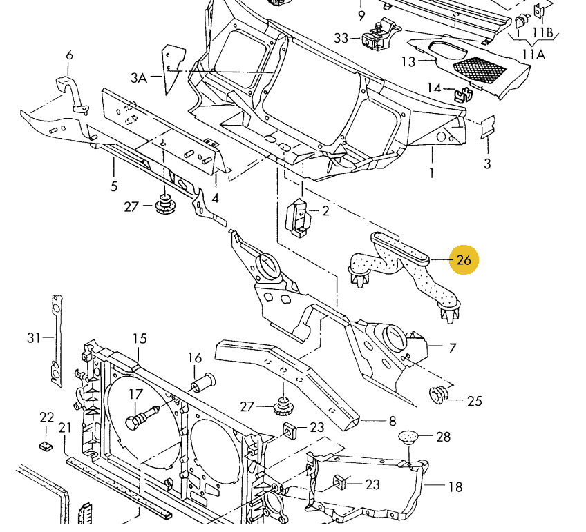

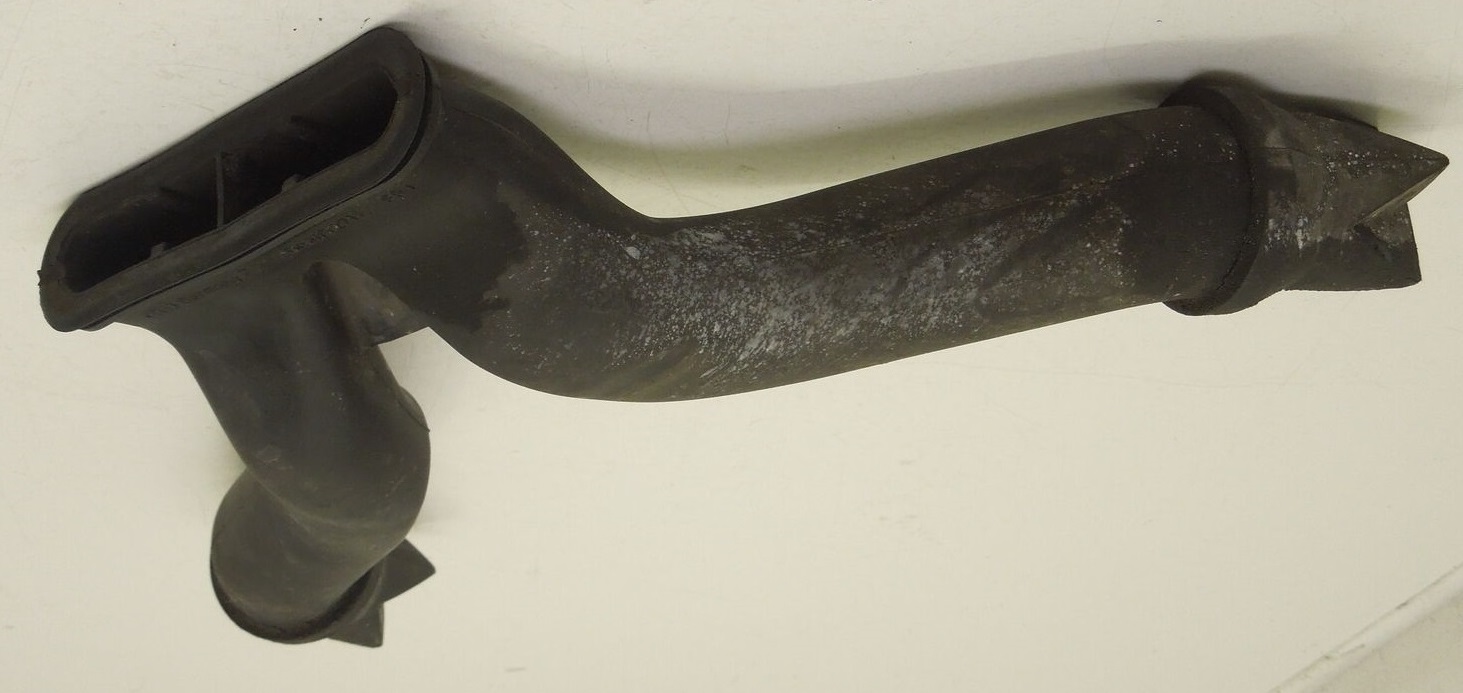

2. Scuttle drains under windscreen scuttle panel. Easily blocked by leaves, difficult to get at. IMHO it's not really the big nipples that are the problem, but higher up in the tray.
- hidden under the HVAC unit and best accessed using something like a piece of copper brake pipe to get it angled correctly to wiggle around, and it exits both sides of the transmission. A combination of hot water and kitchen drain cleaners used to clean them, and then flushed again with clean hot water. Location and image as follows:

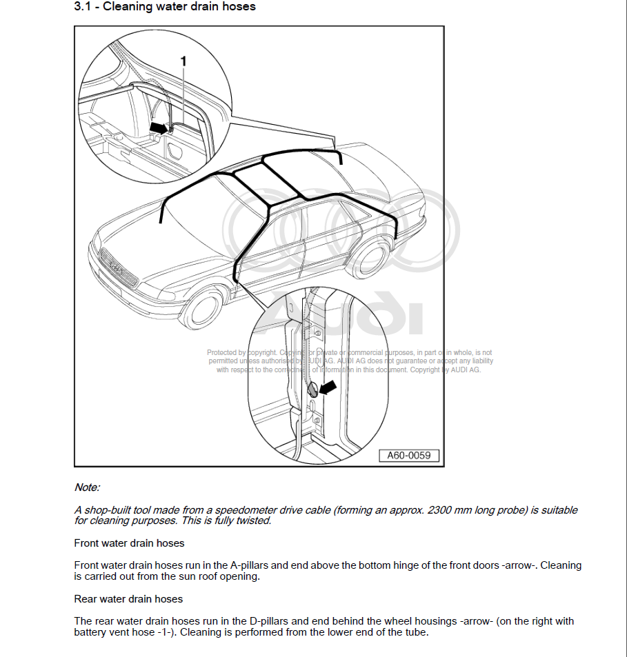

3. Sunroof drains
- Four in total, one at each corner of sunroof frame. Plastic tubing is very pliable so extreme care when cleaning these out. Front ones exit at the base of the A-pillar (you can see them when you open the door), and the rear ones exit behind the back wheel. Illustration of layout as follows:

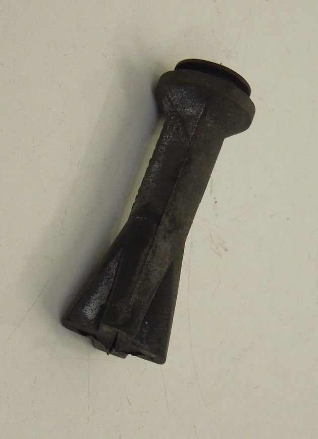

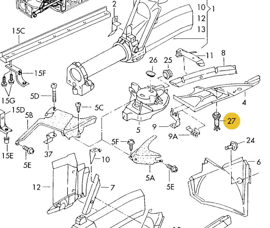

7. Small drains under bonnet, either side close to the wing panels.
- About two inches long and exit at the back of the wheel arch. Location and image as follows:
