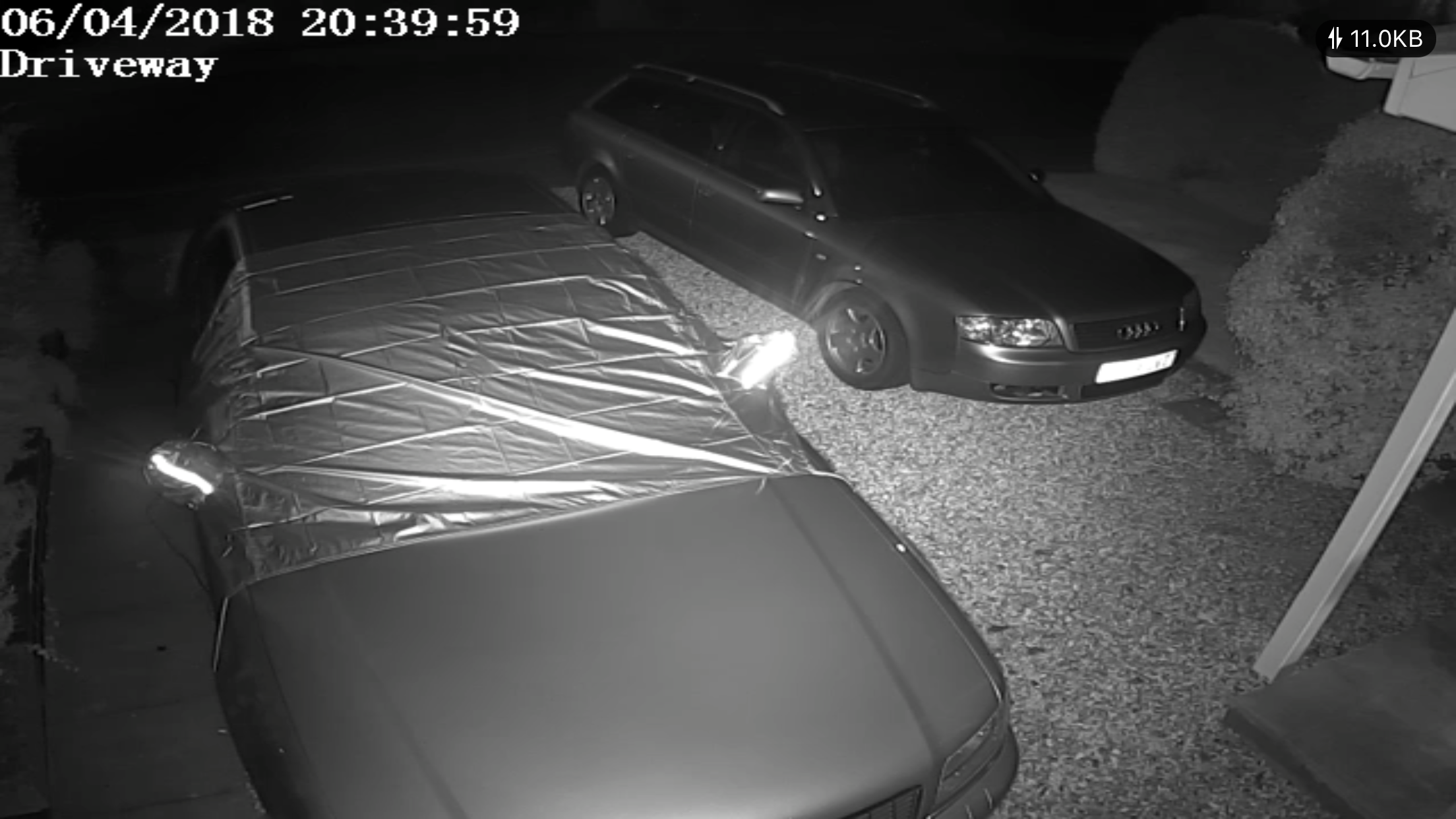

Rain forecast all weekend. Hopefully this will buy me some time
