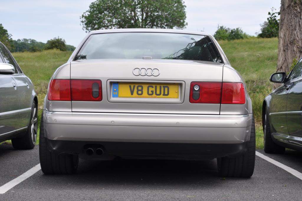

Old 18th August 2016, 12:10 PM
Definitely worth it. They really help fill those wheel arches and give it that wider appearance from the rear.
or get wiiiiddddddeeeee wheels
