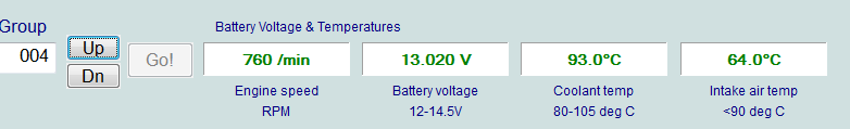

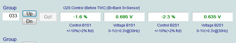

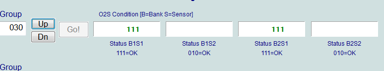

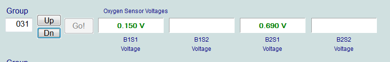

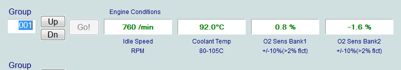

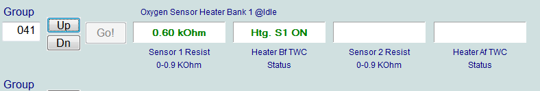

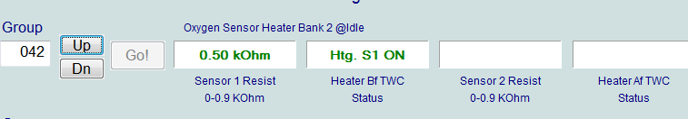

Old 18th August 2016, 06:38 PM
SilverS8 SilverS8 is offline
Join Date: Jul 2011
Location: Norway
Posts: 362
Now we are down to 2 fault codes. 17966 has misteriously dissapeared..
2 Faults Found:
17972 - Throttle Actuator (J338)
P1564 - 35-10 - Under-Voltage during Basic Setting - Intermittent
17521 - Oxygen (Lambda) Sensor; B1 S1
P1113 - 35-10 - Internal Resistance too High - Intermittent
Snipped a few shots from VCDS.
Lambda values seems fine to me?
Is my voltage to low?

Old 18th August 2016, 06:42 PM
Posts: 8,548
How often/when do you clear the fault codes and how soon/when do they reappear?

Old 19th August 2016, 05:22 AM
Posts: 3,854
The lambda error is for the heating element, so it takes a minute or 2 longer for it to heat up and start working. I would not worry about it at all.
Old 19th August 2016, 05:13 PM
Join Date: Jul 2011
Location: Norway
Posts: 362
Hi.
Flaps are working as the should.
Nor sure how quickly the codes return. Was unable to get them to return by idling/reving it in the driveway last night.
On another trip this weekend with the family. so i'm gonna check tonight when we arrive at our destination if the codes are back
