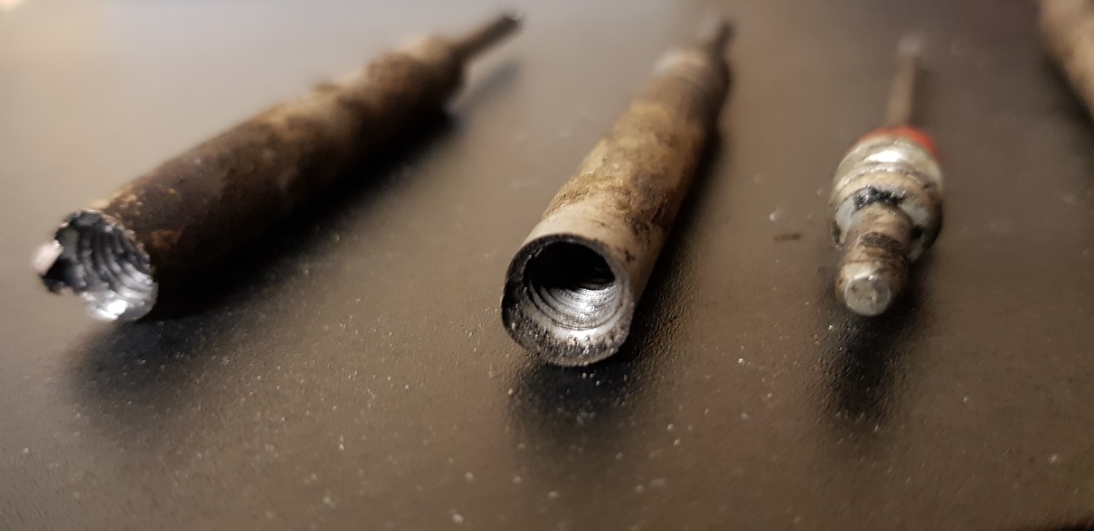

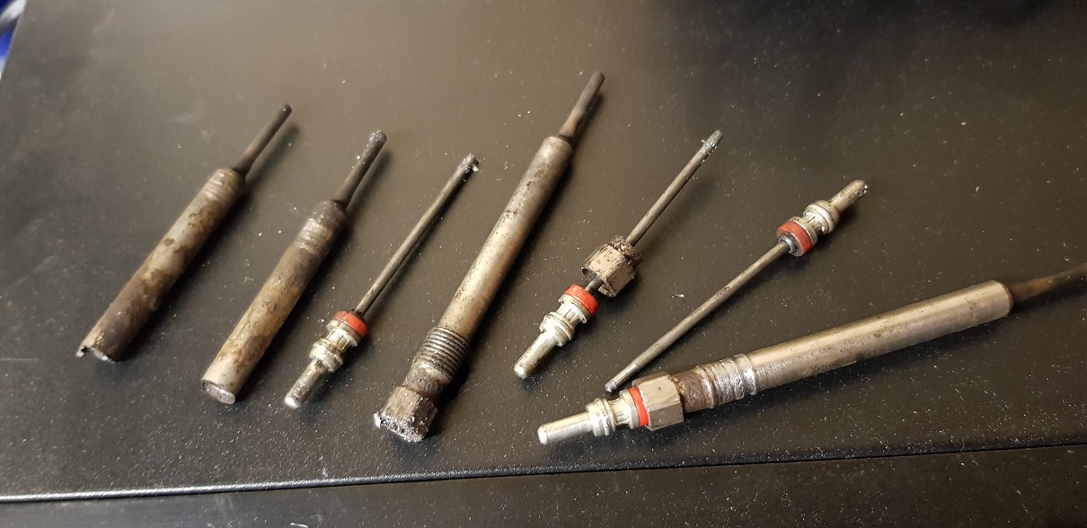

The remains of the old ones. On the far right you can see the one that stripped its threads and left them behind in the head:

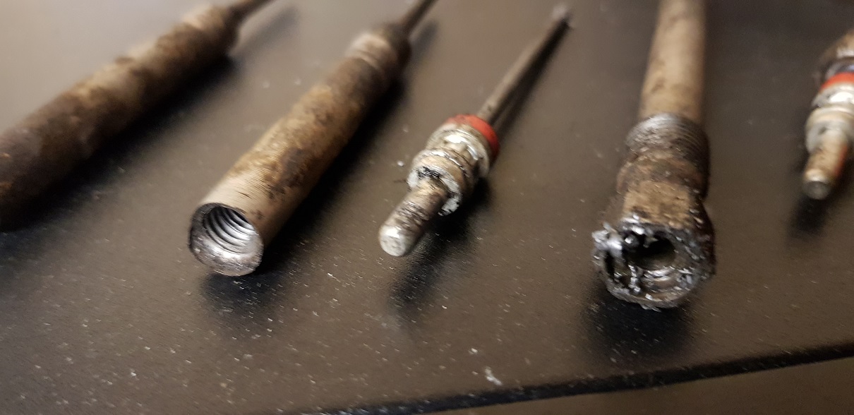

The newly created threads inside as a result of the extraction tools:

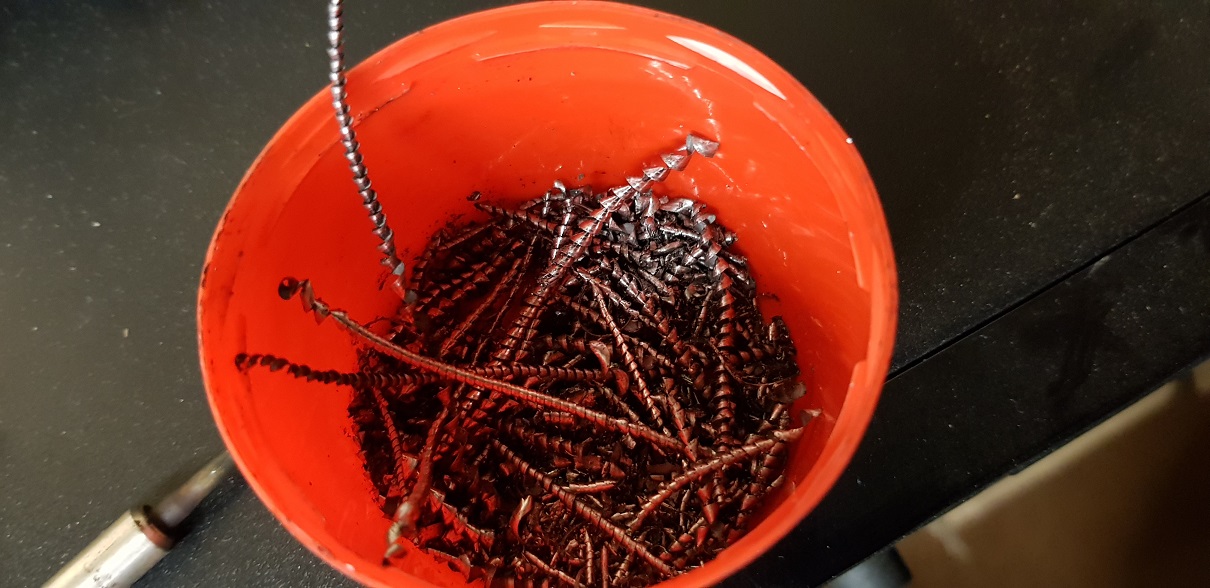

And this tub is full of all the metal parts - Nothing went in the engine, of this he was most certain and proud.....

Good stuff I'm surprised how much swarf can be made from glow plugs!
