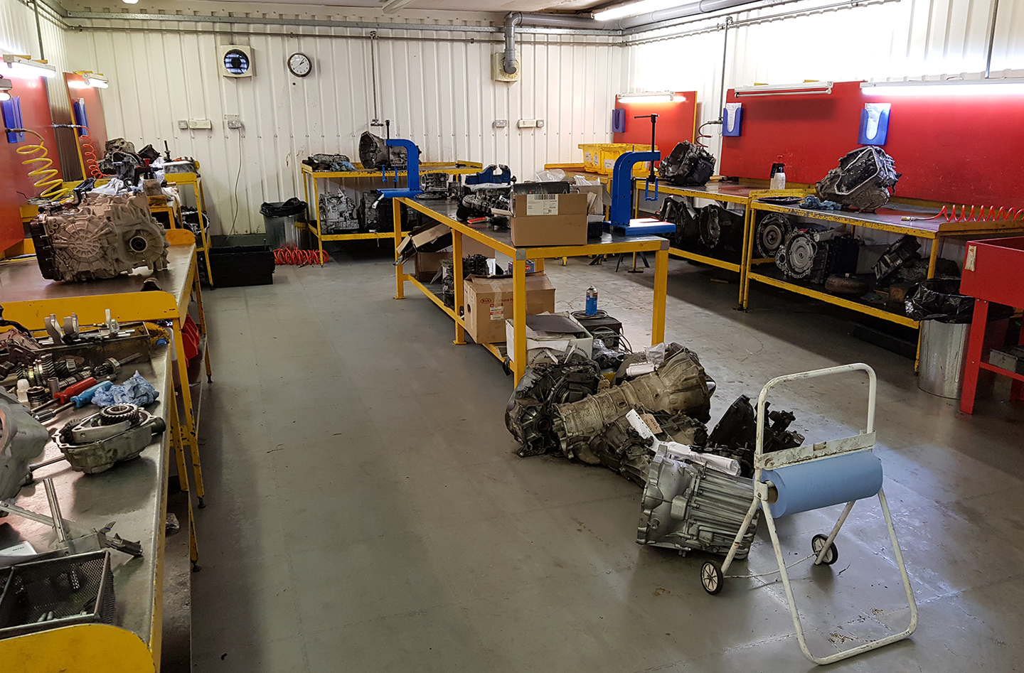

First stop was the booking-in area (I soon found that the place was very compartmentalised).
This is where they book-in and inspect the gearboxes. To the right, just out of shot are the cleaning bays (of which there are many around the huge workshop) and behind me were racks of checked-in gearboxes waiting their turn for treatment.
There were quite a few from Kia and Hyundai as Mackie's have a contract with them.

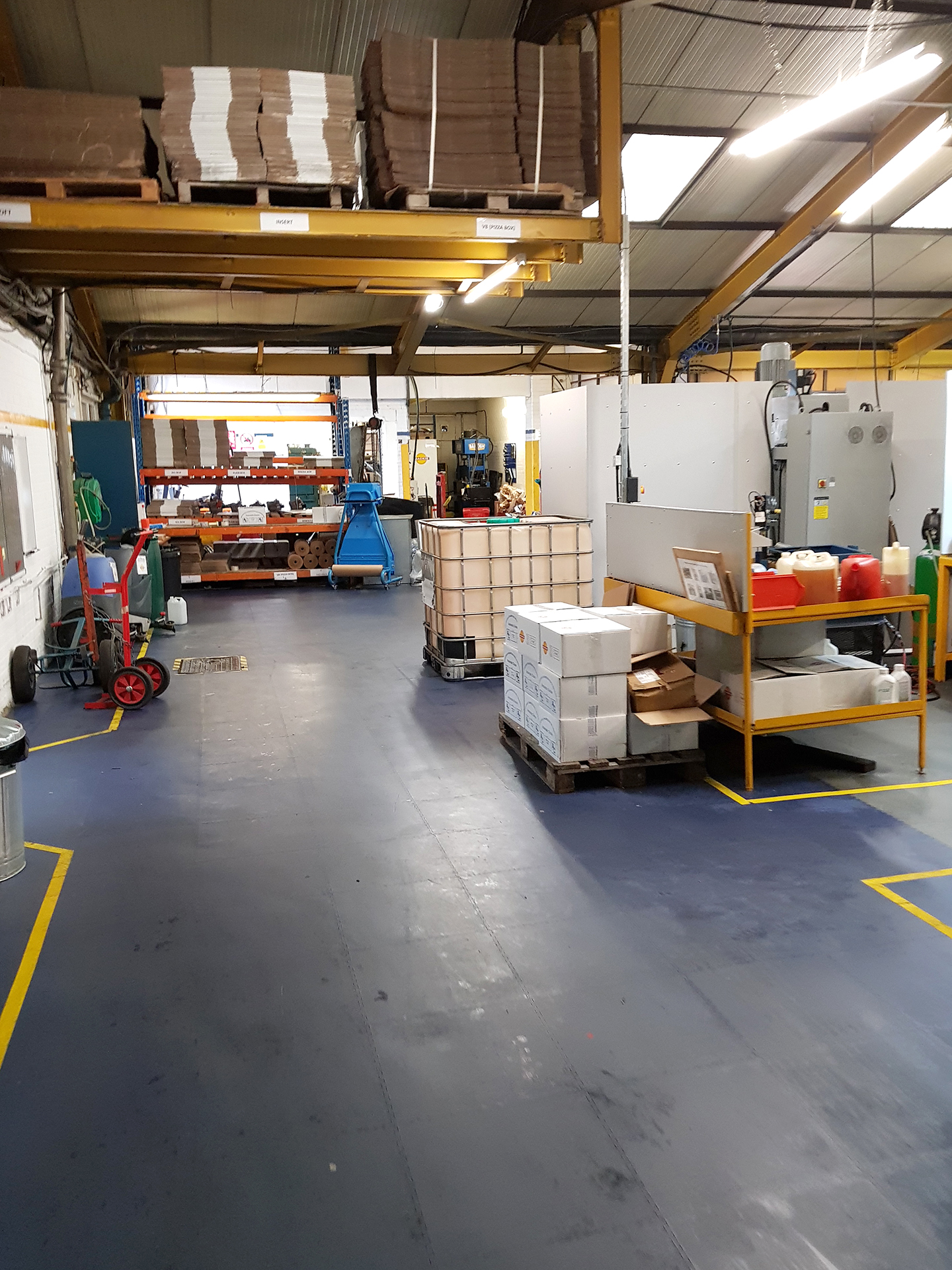

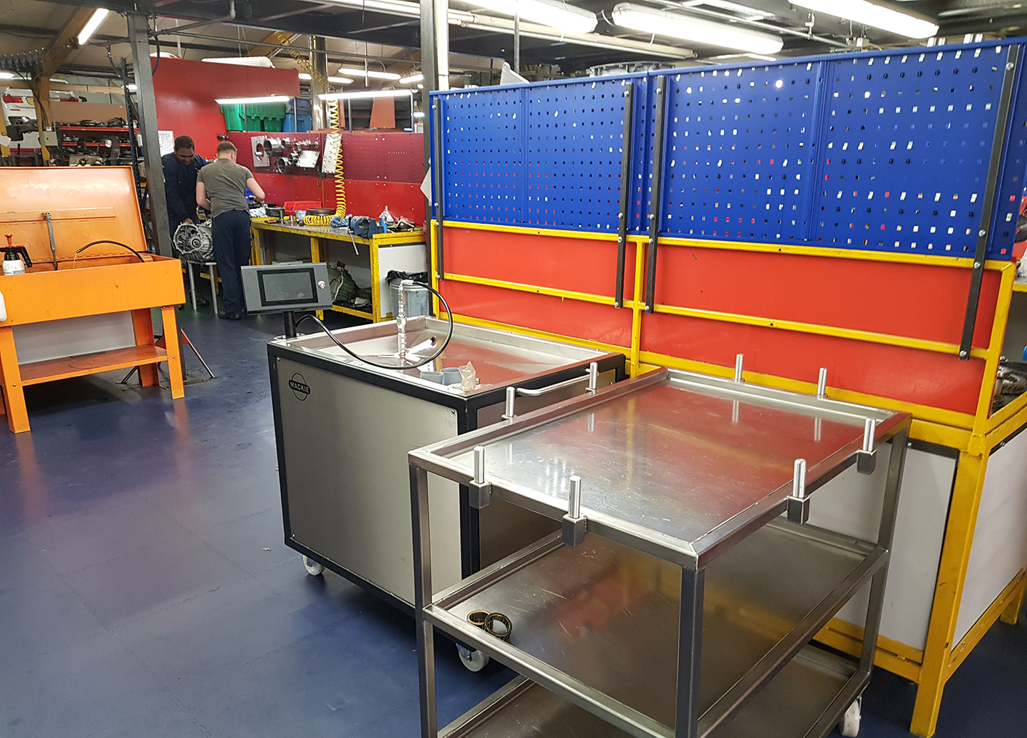

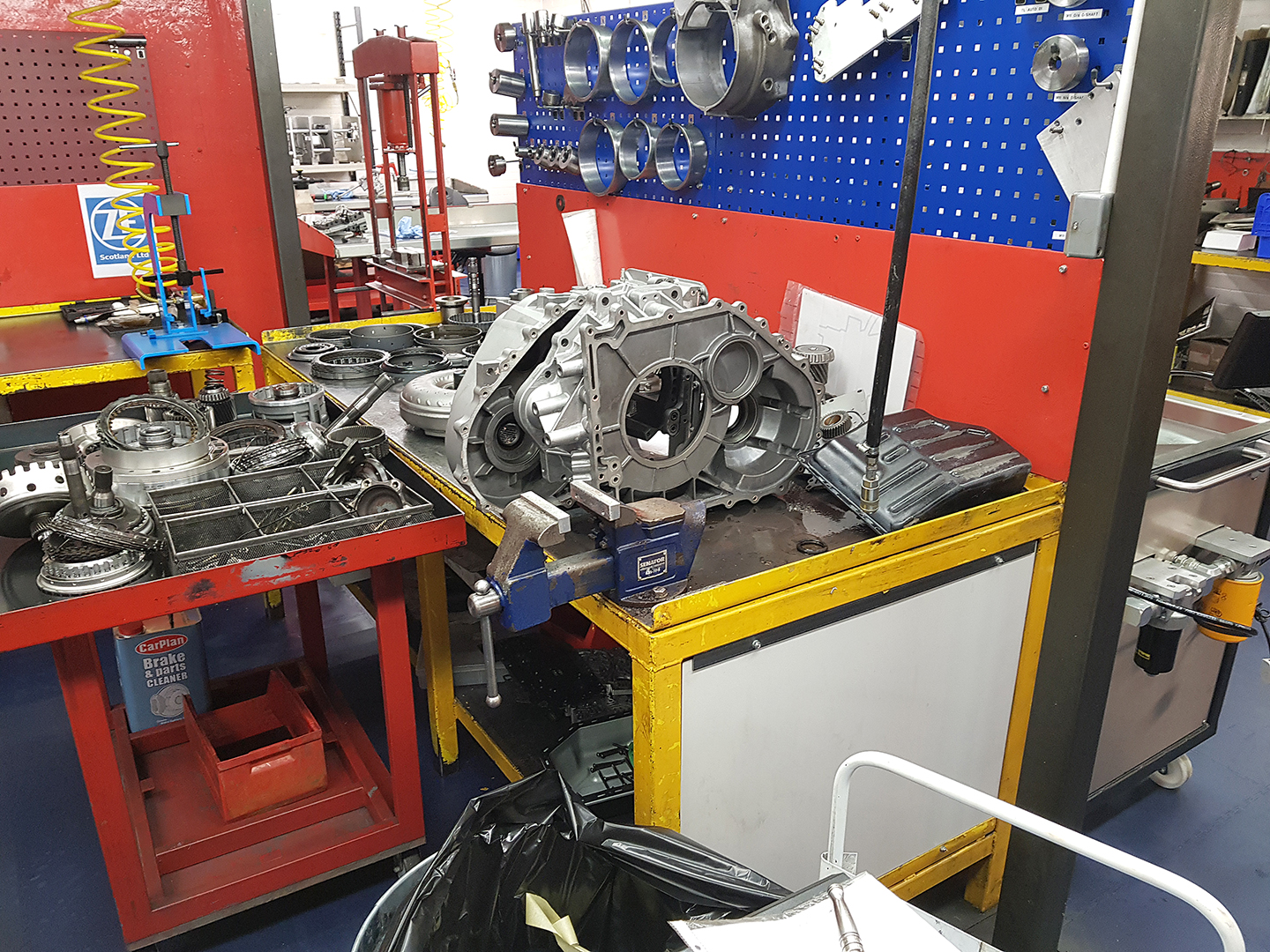

The next bays shown to me involved the stripping down of the boxes.
As you can see, they don't like working with anything dirty and I was surprised by the relative cleanliness (in terms of a workshop) of the place and the cleaned gearbox parts that they are working with.
The floor has these blue rubber(?) squares all joined together which were a little slippy underfoot but I guess are much easier to clean than concrete and much more forgiving on a part should it be accidentally dropped.

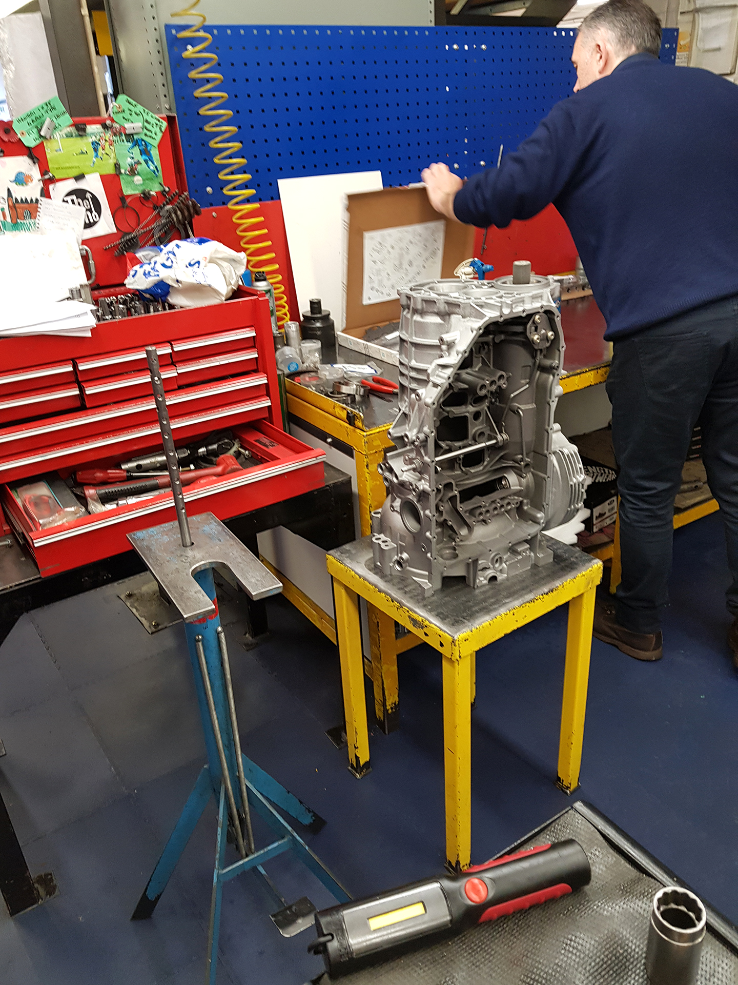

After removing the sump and valve body (behind this bay)........

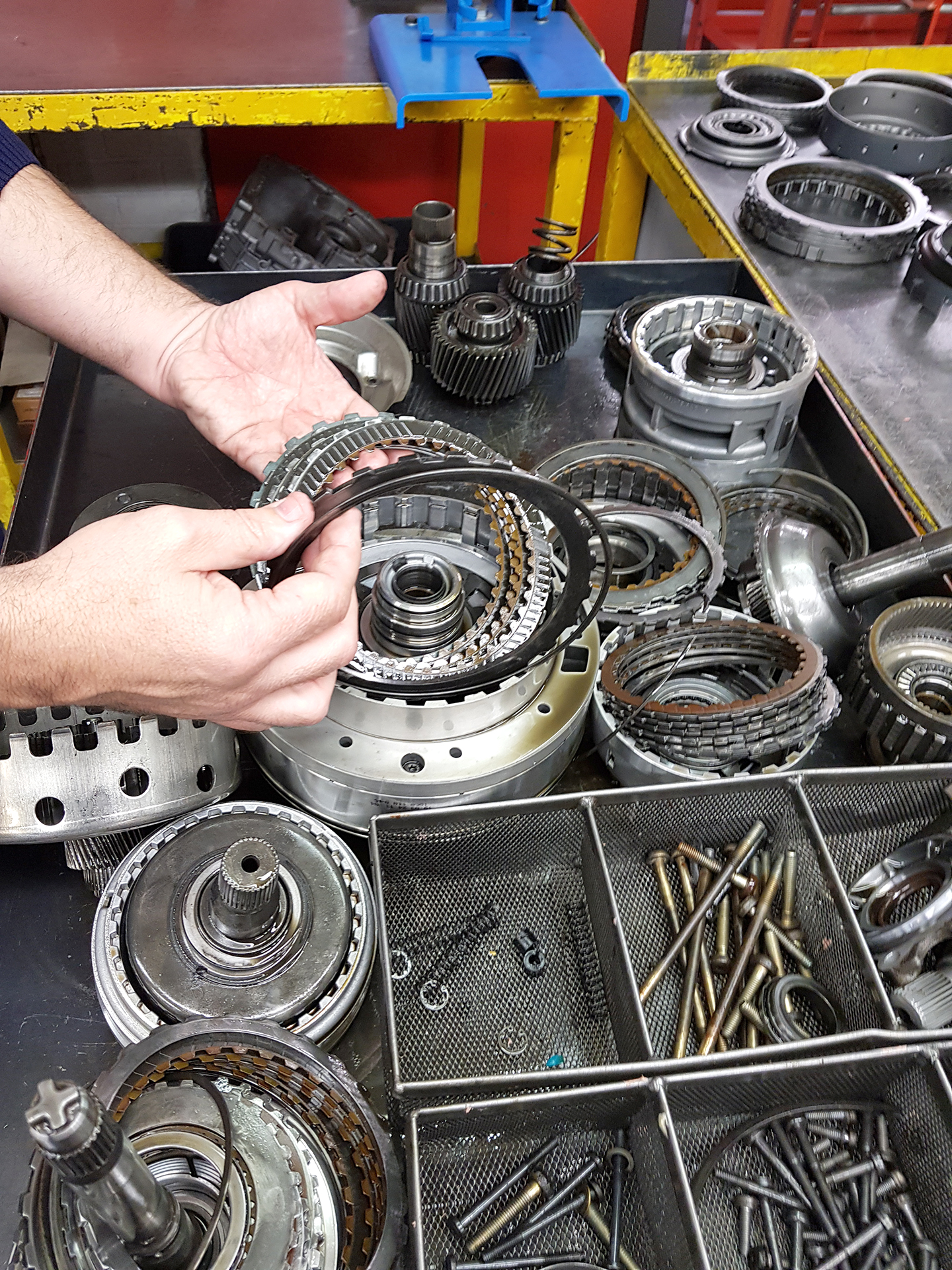

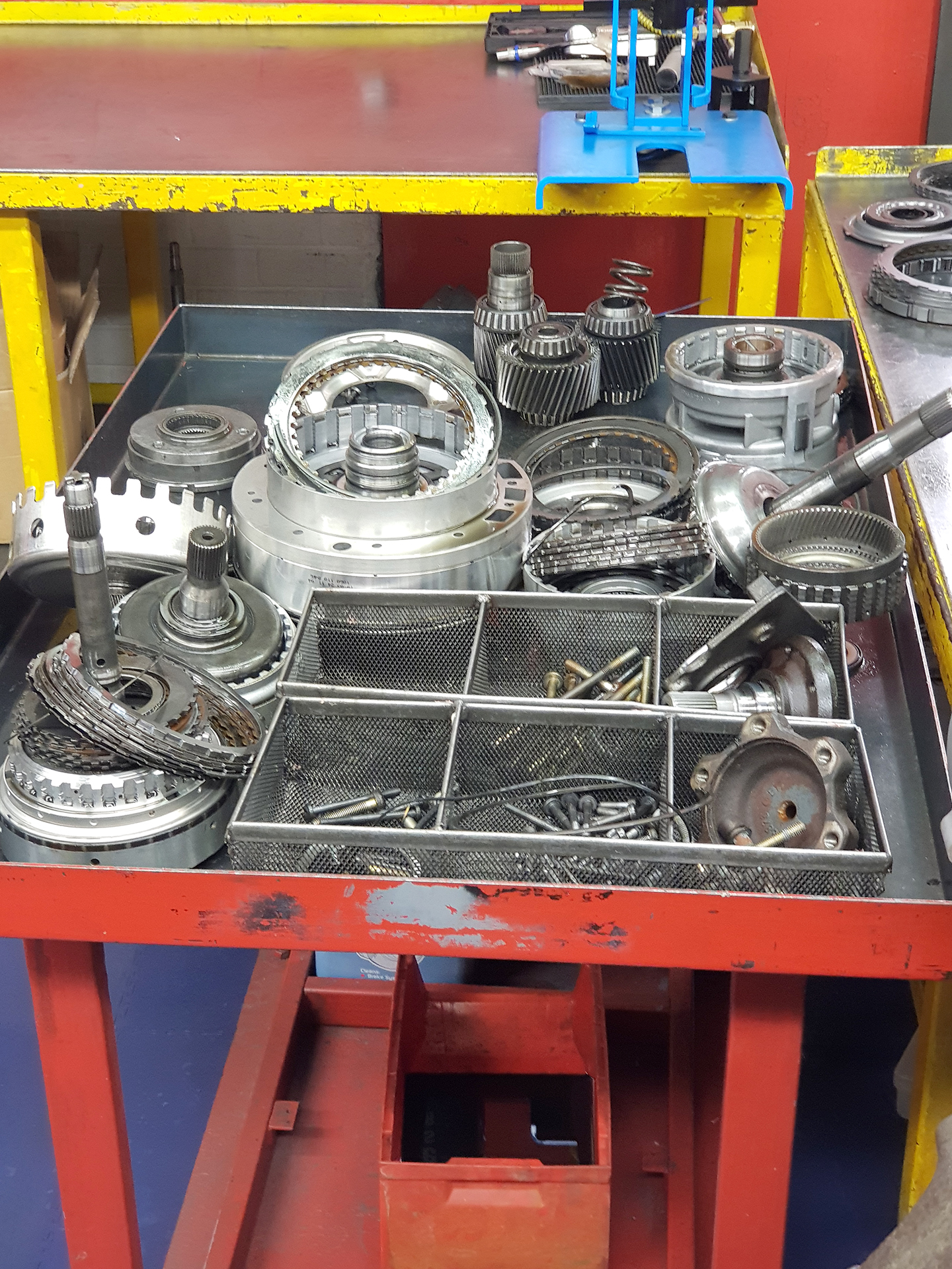

It's time to clean and recondition the clutches......
These clutches appeared to be rather complicated things to me
If you want to see how complicated they are, try looking at the first three posts on this other forum thread.

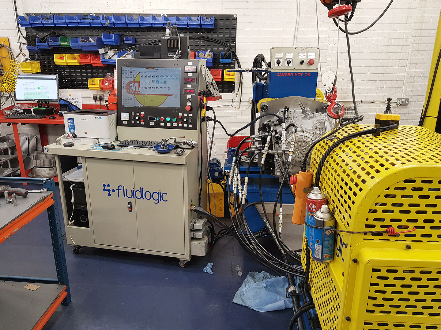

In this image, you can see a gearbox test taking place. This room was like a sauna!
The gearbox is wired up in a "life support machine" kind of way and put through its paces. It's a noisy place too!

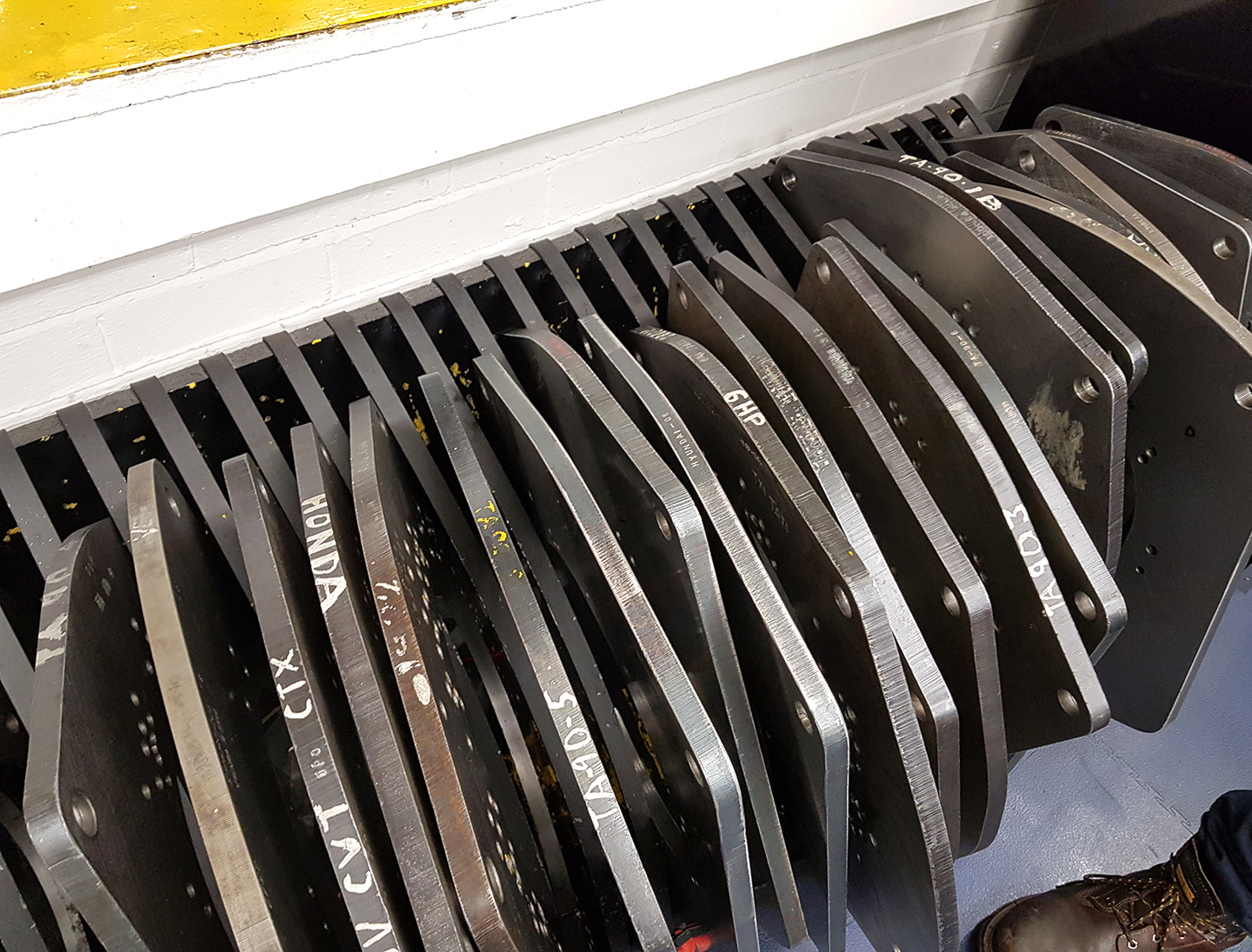

Just under the "Danger Hot Oil" sign, you can see a dark metal plate.
These are custom produced by Mackie's with their own CNC machine and are specific to each type of gearbox.
Here you can see the rack of support plates that the gearboxes are attached to. Can you spot the 6HP plate?

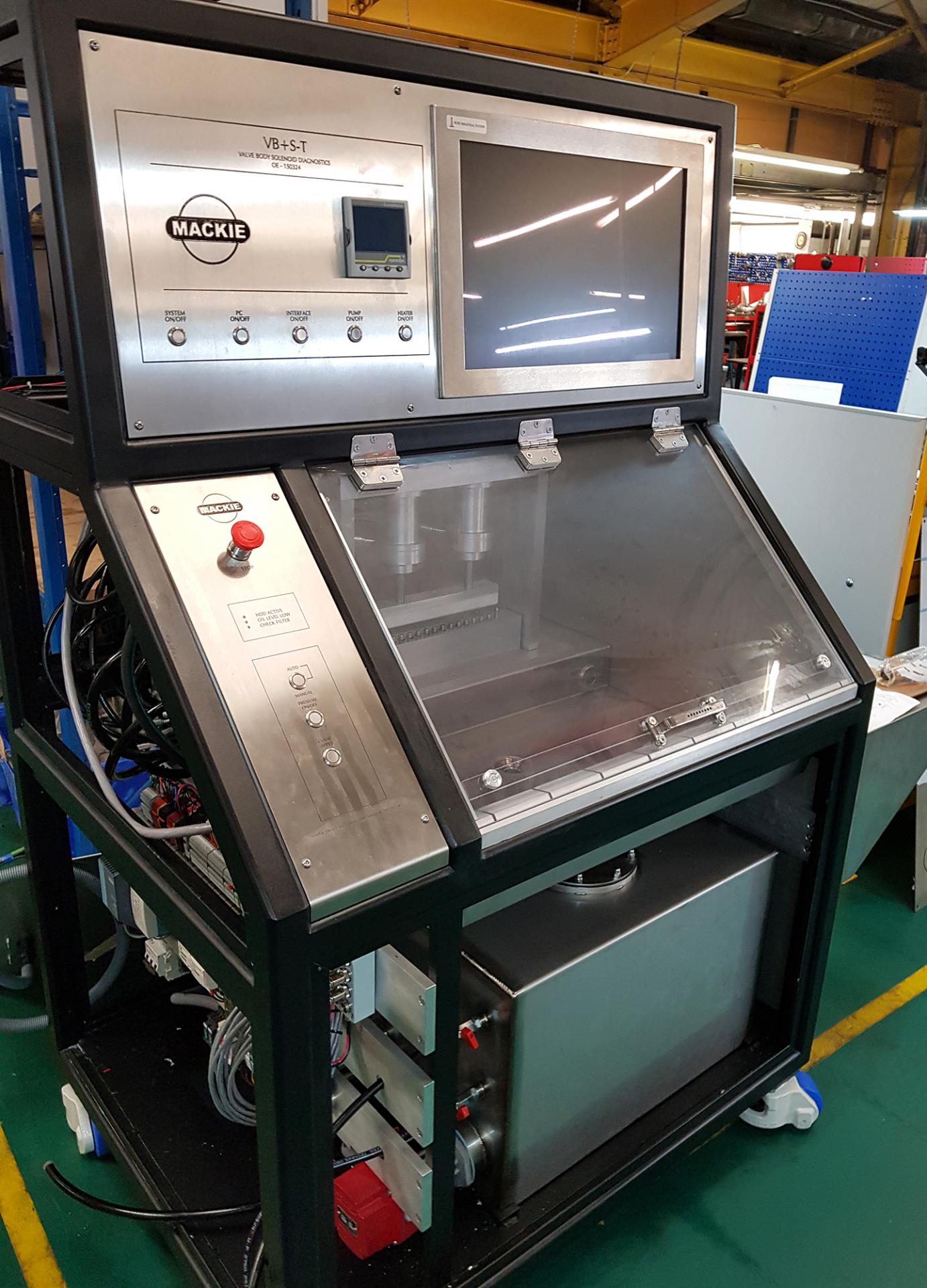

This is one of the machines developed by Mackie's. It's a valve body diagnostic machine. Quite impressive.

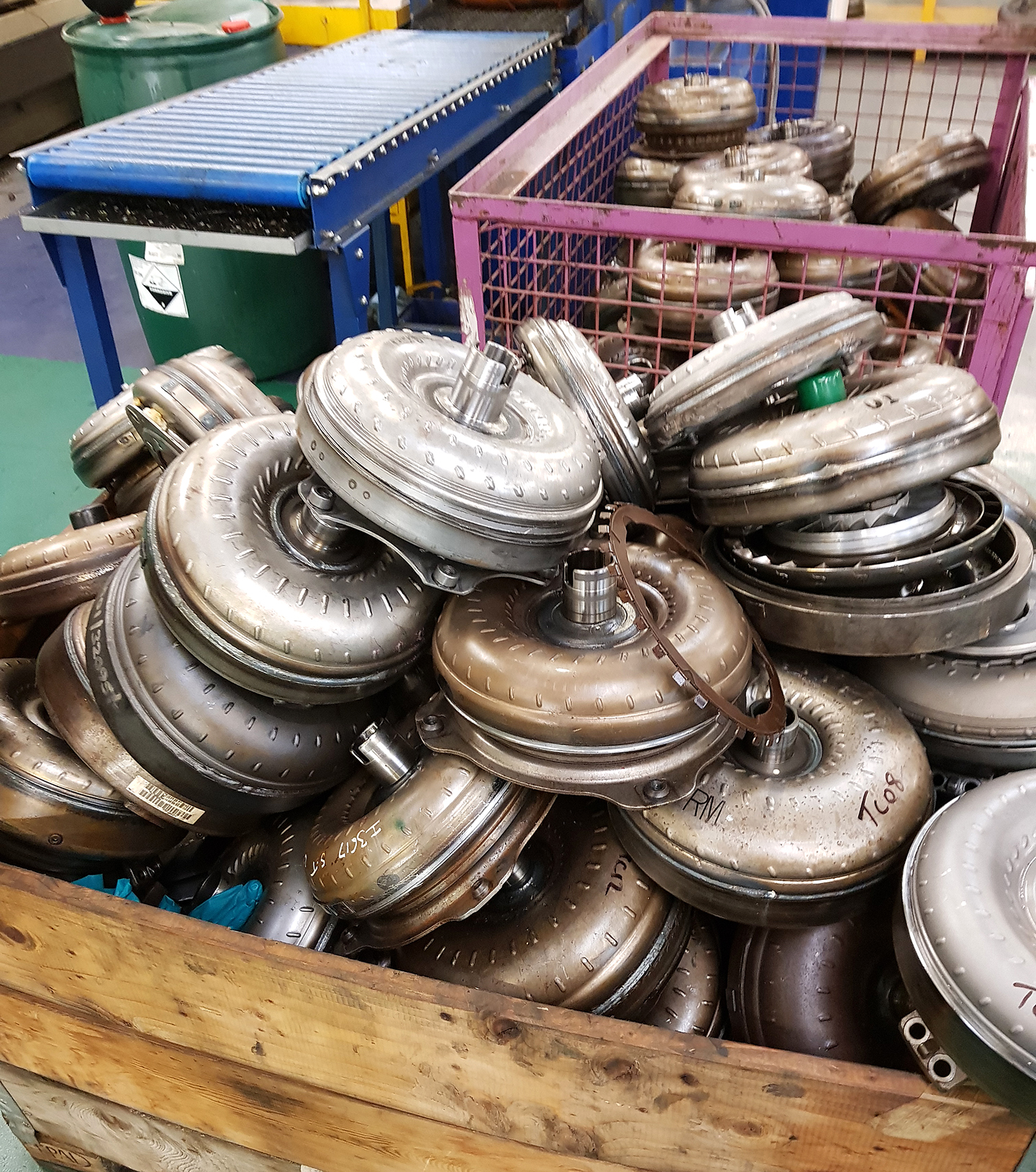

Roll up, roll up! Get your torque converters here!
These toroidal chunks of metal transfer the energy from the engine to the gearbox.
"In brief, the torque converter is a type of fluid coupling, which allows the engine to spin somewhat independently of the transmission. It is responsible for pressurising automatic transmission fluid - a pressurisation that supplies the force necessary to shift transmission gears."

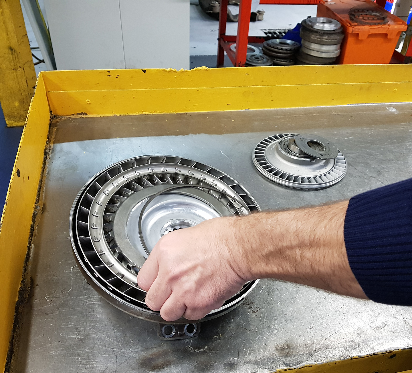

Here's one that has been cleaned and expanded for reconditioning:

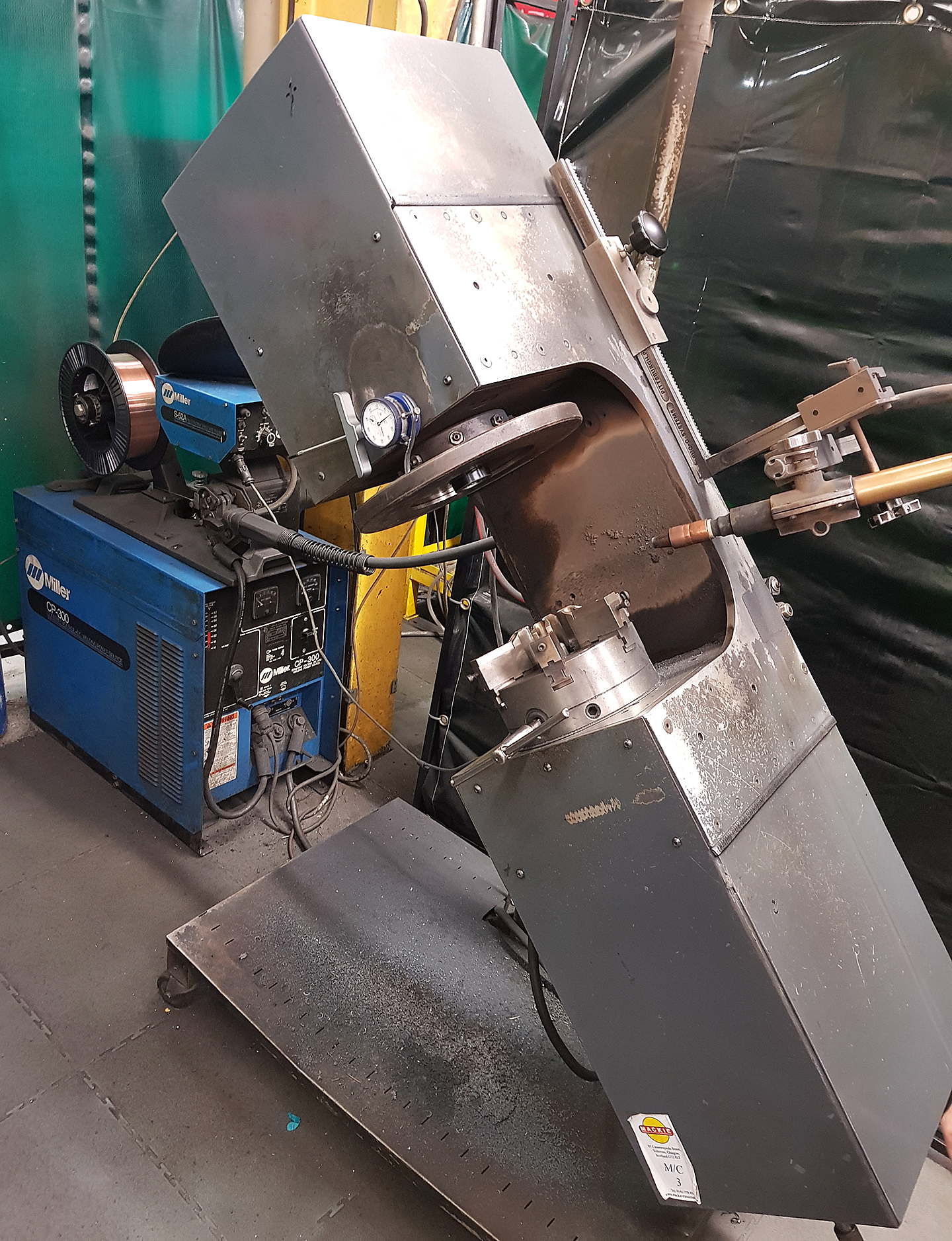

And this old thing is from a GM production line from a long time ago.
Apparently, welding the torque converter seems around the edges of the metal doughnut is not such an easy thing to do by hand if you want a perfect job doing. Who knew??

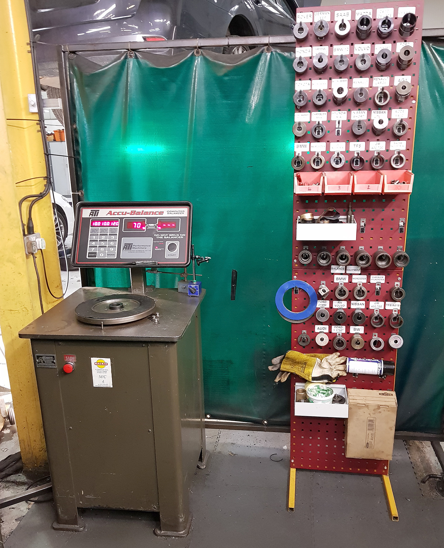

The all-essential torque converter balancing machine.

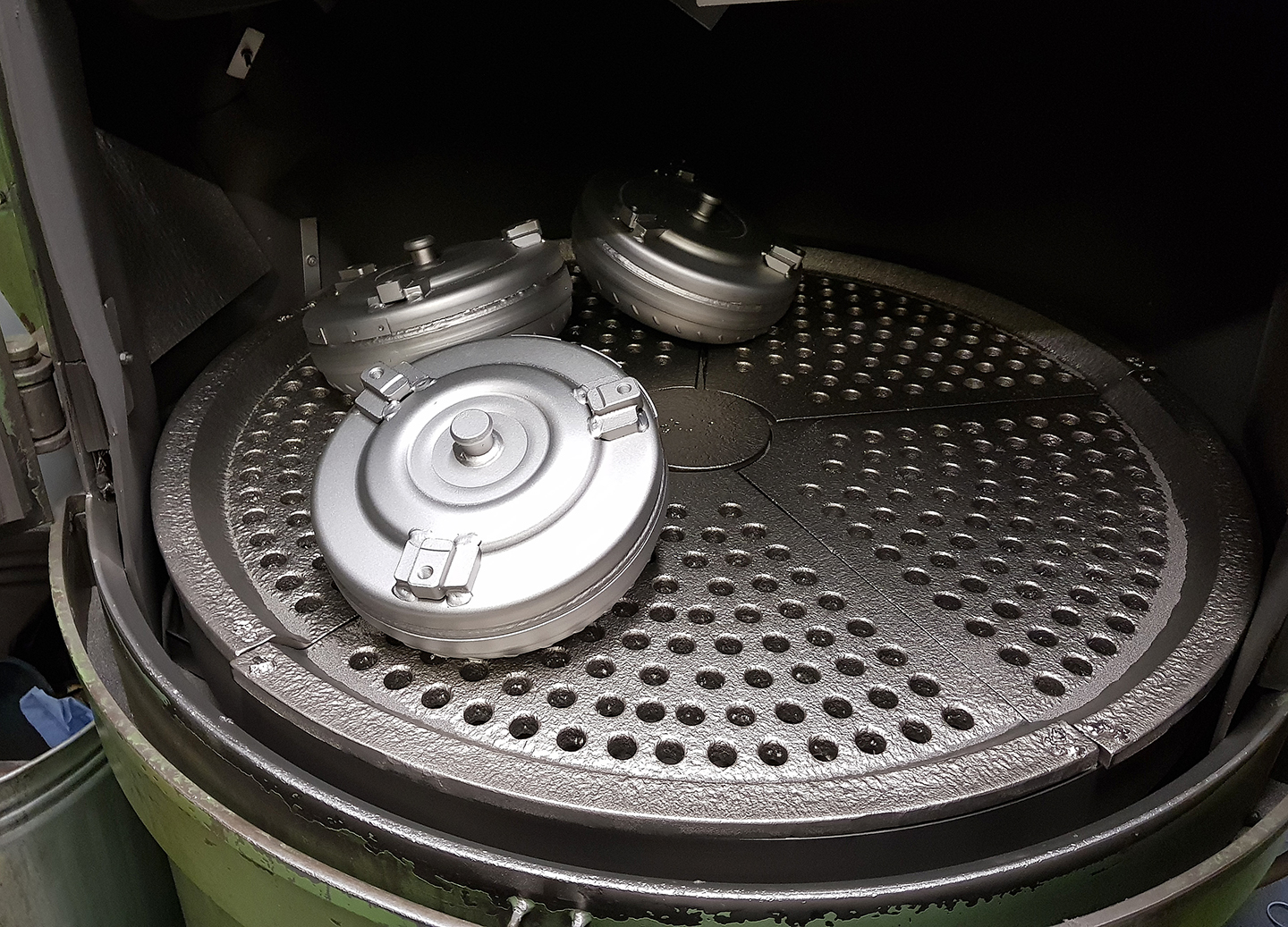

Sealed and cleaned (sometimes by sandblasting) before compressed air is blown into them underwater - like you would test a tyre underwater to make sure that there were no holes.

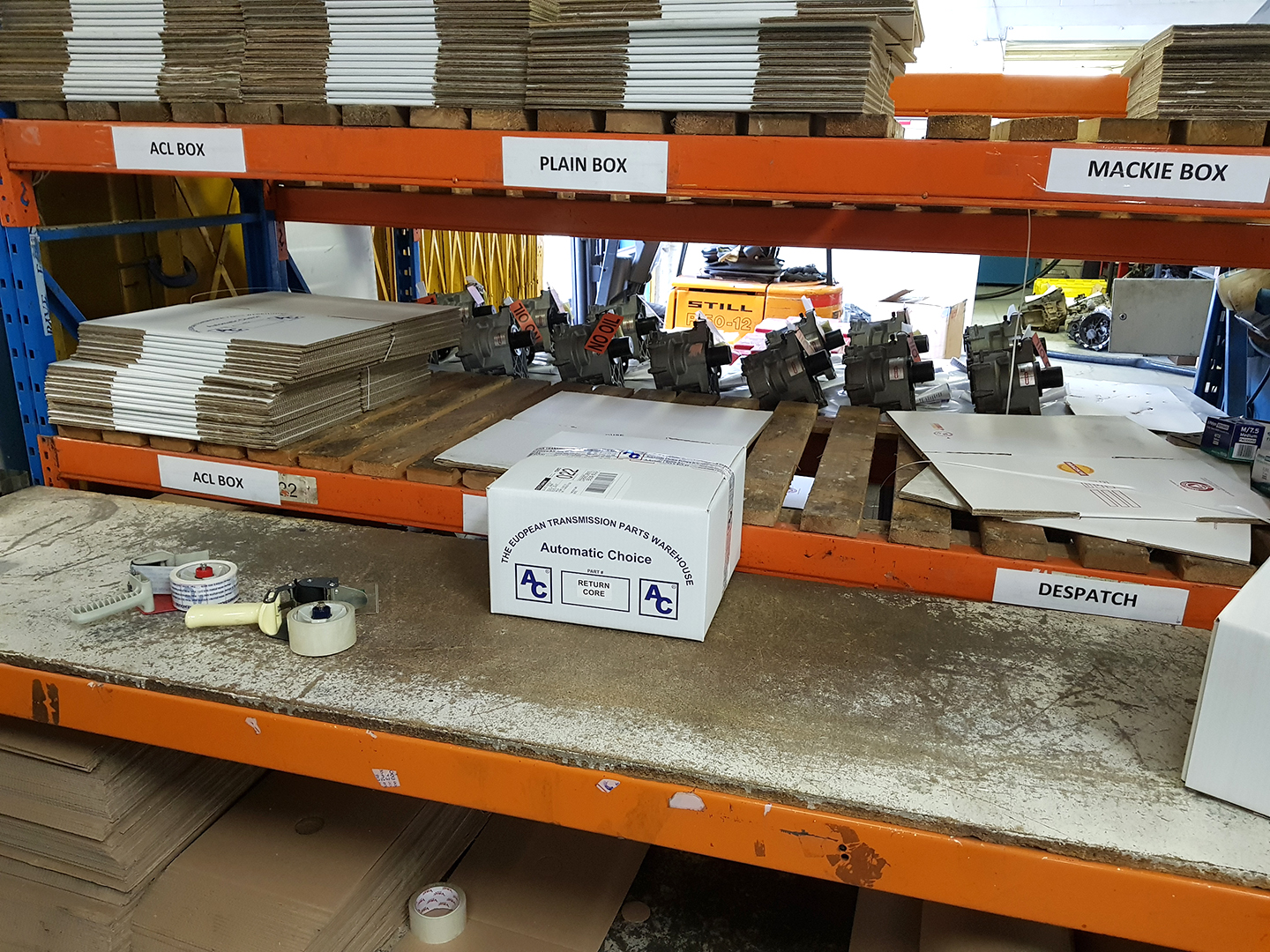

Next comes the dispatch area once things are all fettled and fine-tuned.
If like me, you're a fan of The Proclaimers, you may be familiar with one of their songs called "Throw the 'R' Away"
It's about the Glaswegian guttural "r", pronounced at the end of words, which could be lost within a generation.
Well it seems that Mackie's are playing their part in this cultural change with their packaging.
Either that or they have such a contempt for anything European that they can't bring themselves to say the word..
(Hint: check the wording on the white box )

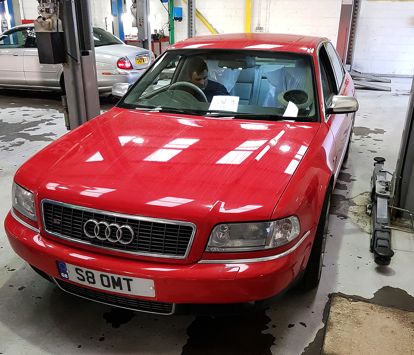

Until now, all of the above had nothing to do with my car, as nothing required reconditioning.
Here is the technician who worked on my car, prior to him doing a test drive.
I asked him about the whine on acceleration to which he replied "what whine?".
And since driving the car since the service I can understand his reply as it is now without the whine (although he did do a test before the gearbox service so I don't know why he didn't spot it then as I told them about it ).

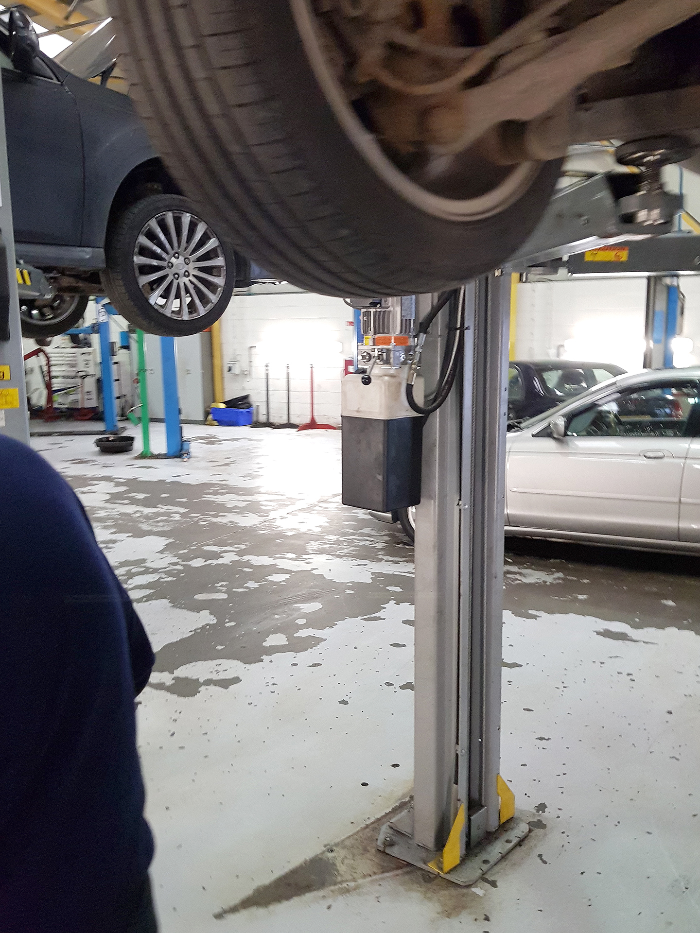

I thought I'd throw in a quiz question here....
Is that my car (D2 S8) on the lift in the foreground? Basically a bit of wheel and undercarriage.
Do you know the underside of your D2's well enough?
Or not? (MJ is excluded from this as this would not be a challenge for her).

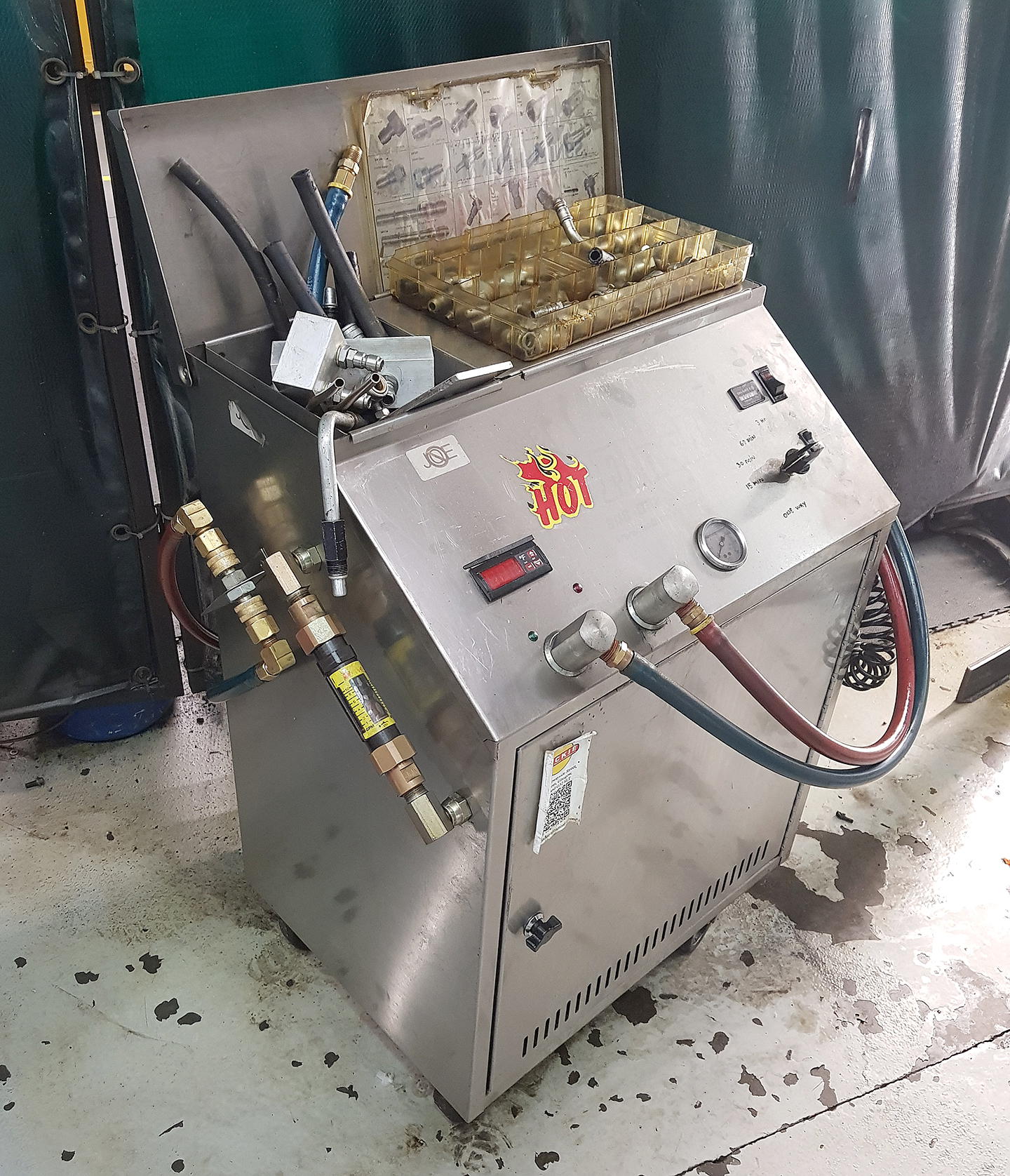

The machine that does the magic is called (by Mackie's) the "Hot Flush" machine.
I've seen it called the "slurpy machine" or the "pushy / pully machine" and other variants, but this is what it looks like in the flesh.
And once that had done its job (and the sump was cleaned and fastened on with the aforementioned fasteners), the car was test-driven and I was back in the office for the bill.

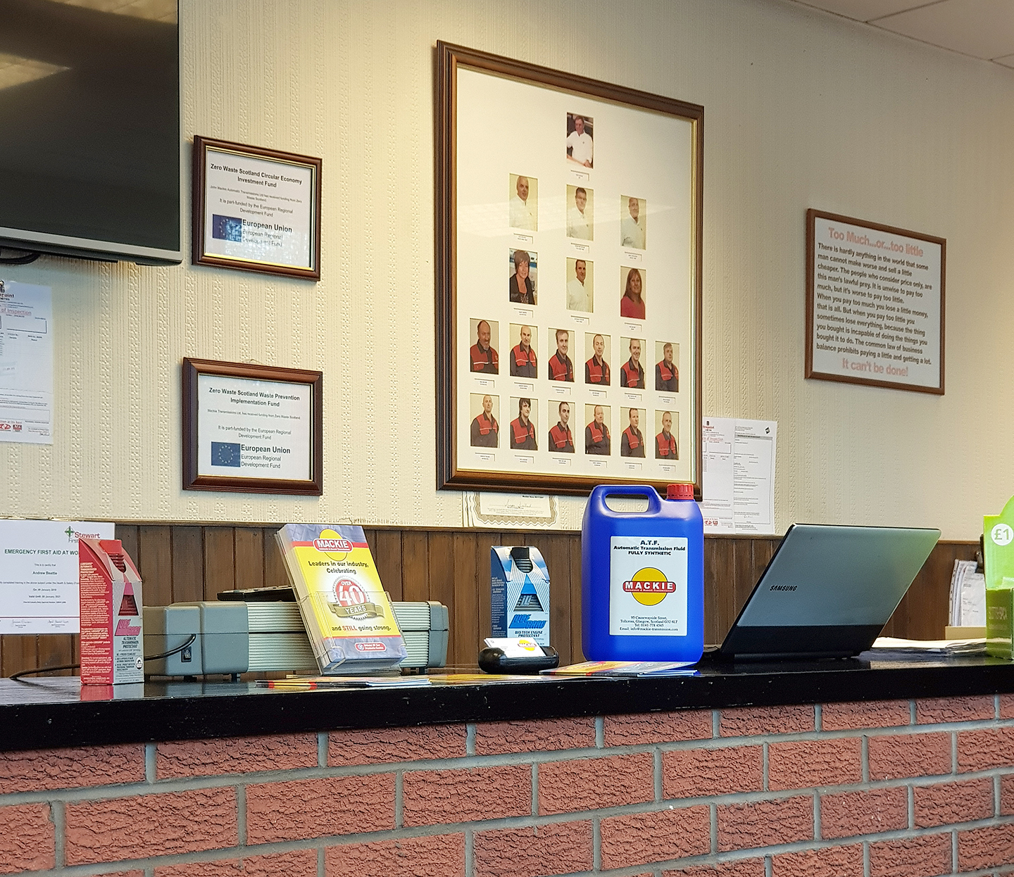

And finally, just in case you couldn't read the mantra on Mackie's wall in the previous image......
Too Much...or...too little
There is hardly anything in the world that some man cannot make worse and sell a little cheaper.
The people who consider price only, are this man's lawful prey.
It is unwise to pay too much, but it's worse to pay too little.
When you pay too much you lose a little money, that is all.
But when you pay too little you sometimes lose everything, because the thing you bought is incapable of doing the things you bought it to do.
The common law of business balance prohibits paying a little and getting a lot.
It can't be done!
Aye, right!
(or as us Yorkshiremen say in fewer words: You buy cheap, you buy twice!)
