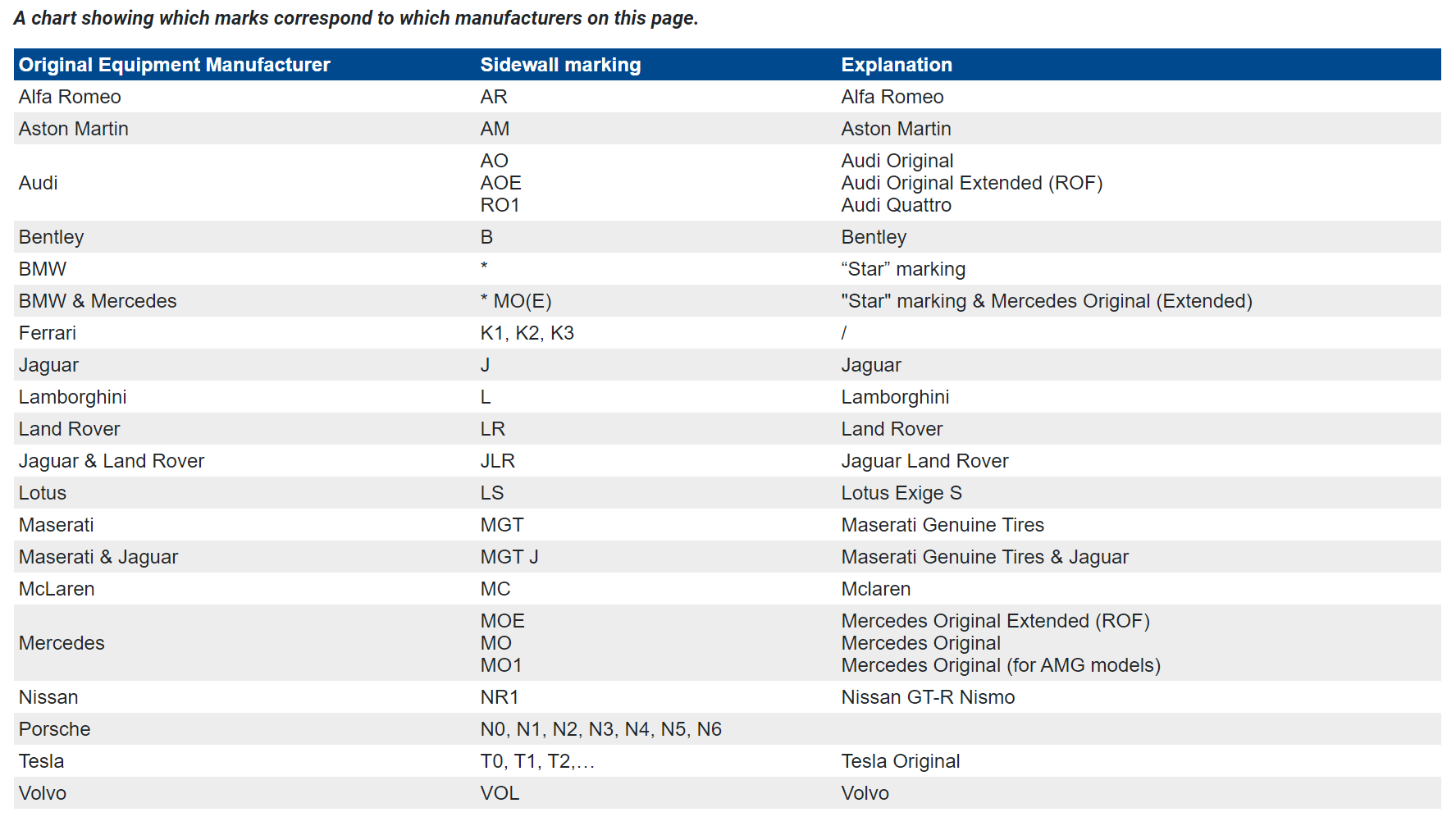

The following image may be helpful:
Name:	OE Tyre Markings.png

So why did they fit JLR tyres to my Audi, I wonder?
Old 18th May 2020, 08:38 PM
Probably what was either on the shelf, or cheapest. They probably don't know or care what those markings actually mean.

Just realised that the suffix on mine is JRS, not JLR, and that’s not on Sean’s list. Even more confused now

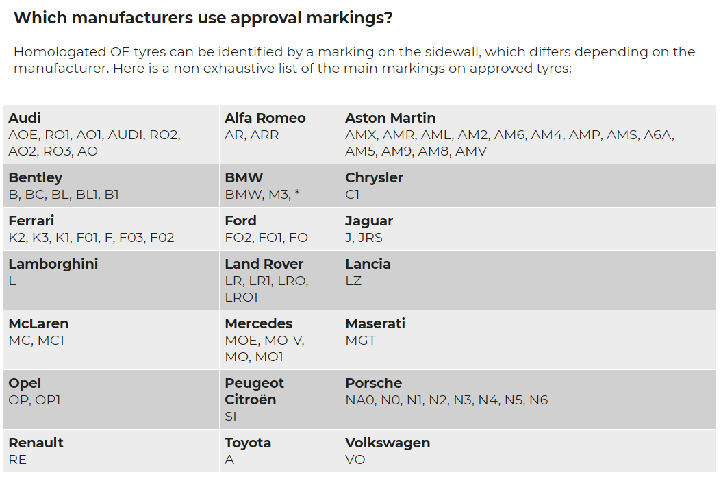

Sorry for the confusion Jim, but to make it better, here's another set of codes from another website that shows JRS! I even came across a site where they said that J inside a circle was also used for Jaguar. I would suspect that MJs response is the most accurate.
Name:	OE Tyre Markings Part 2.png
