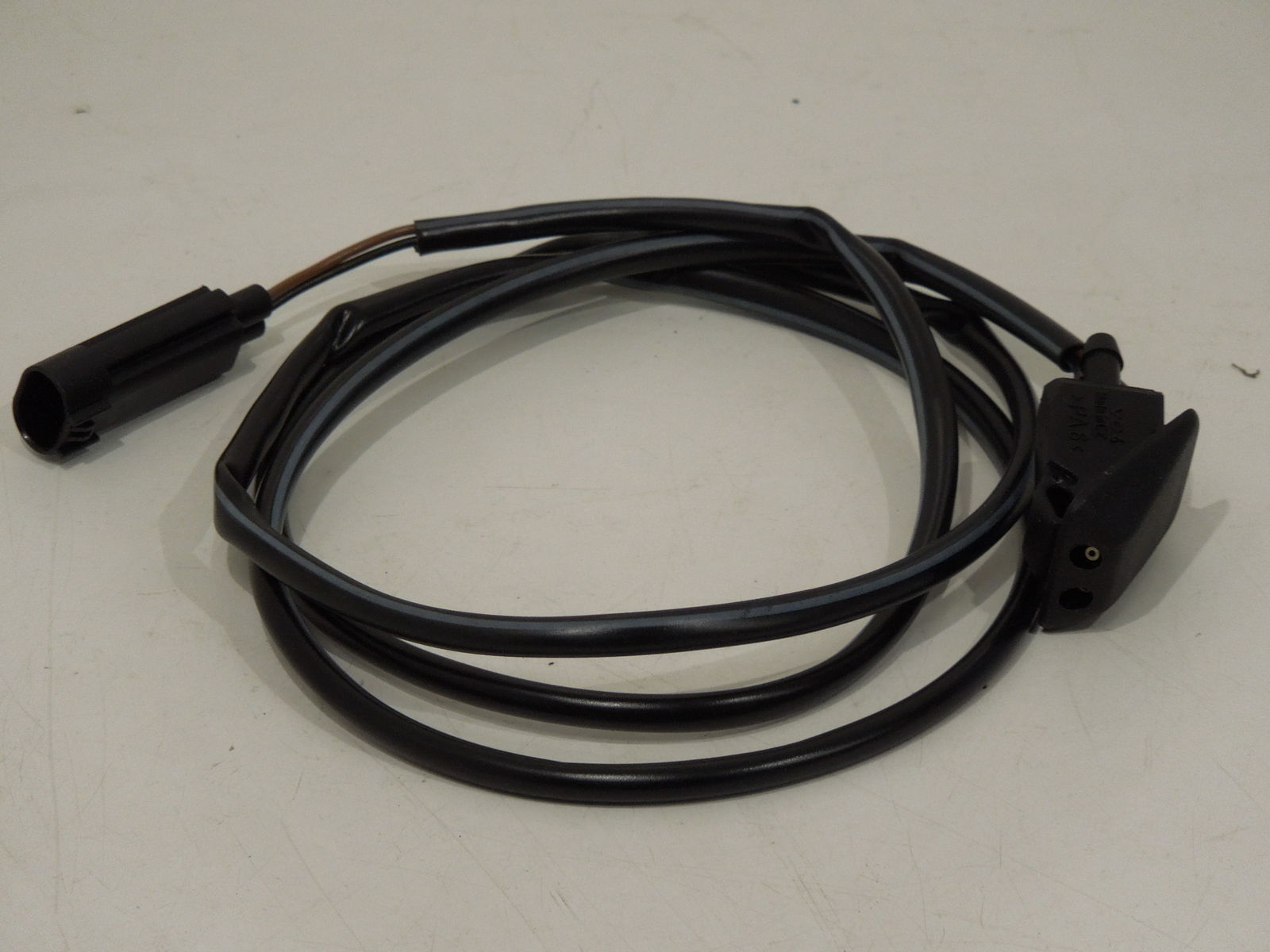

And looking at this image (owned by our sponsors and posted on eBay) the connector isn't the standard VAG group type, it's longer and more symmetrical at the end.
Ideally I'd like to buy a couple of tails to graft onto the Ford-style jets, rather than cannibalise the existing. Anyone know the part number for it or it's mate?
If I have read it properly, there isn't a part number for the connector attached to the cable in the photo. It's sold as a complete unit (4d0955988), but the connector at the other end is part number 8e0973202.
BTW The little itty bitty metal clips are part number 4d0955491a.
