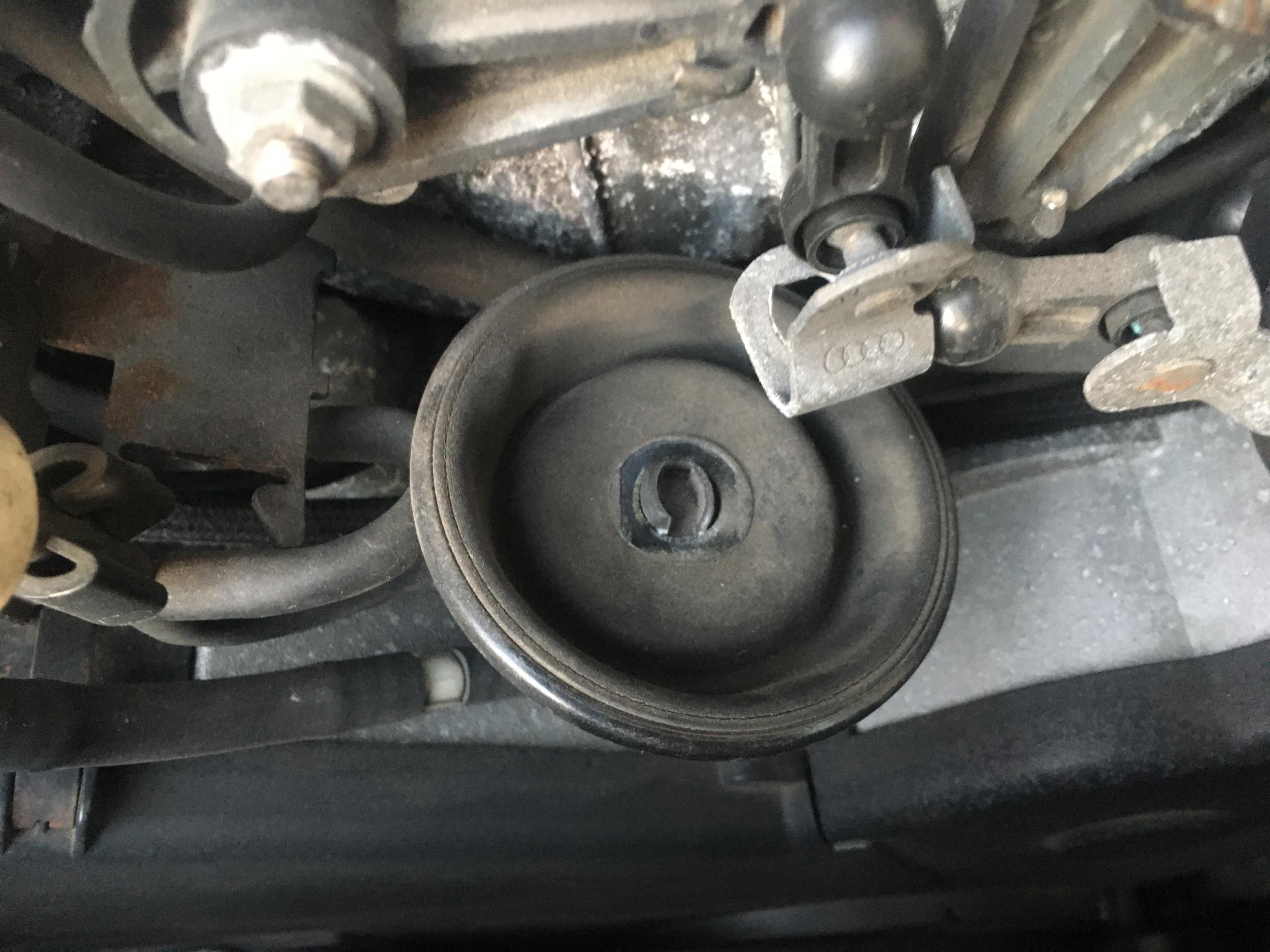

On my way back from Mackies today (yet another gearbox service, now at almost 194K miles) I noticed the tell-tale sound that usually accompanies a broken actuator arm. But when I got home and went to replace the broken arm, I discovered it wasn't a broken arm at all.
As you can see from the attached photo, the bellows on one side has become detached and whatever attaches them has broken. Question is, are these still available and , if so, where can I get them? And are they easy to fit?
Thanks, Jim

Well, the Land Rover part arrived and I fitted it today. The part number and manufacturer's stamp on the back of the bellows are identical (see photo). And it all seems to work fine.
The only teeny snag was that the tube on the back that attaches to the vacuum pipe didn't line up properly with the mounting bracket hole, but there doesn't seem any reason that it has to.
The Land Rover part, with postage and VAT, was about £100, so a much better option that the Audi parts ot the Chinese copies.
