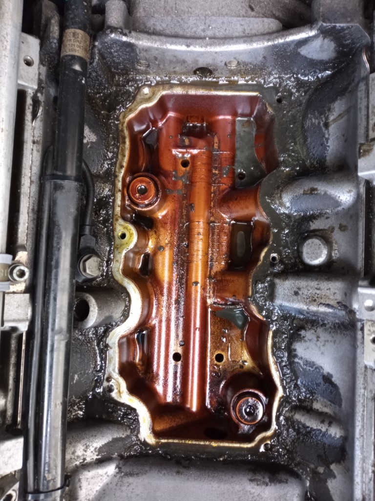

However, even though I've had the inlet manifold off a couple of times over the years, I never noticed the cable route for the nock sensor until now. What the hell? Is there some special voodoo way of getting the plug or the sensor past what looks like a coolant pipe?
It looks to me like I will have to cut the cable in order to remove the old one. Is that correct? Also does the orientation of the sensor matter. Can I spin the new unit around so that the cable points toward the front of the car. Will the cable fit under the manifold?

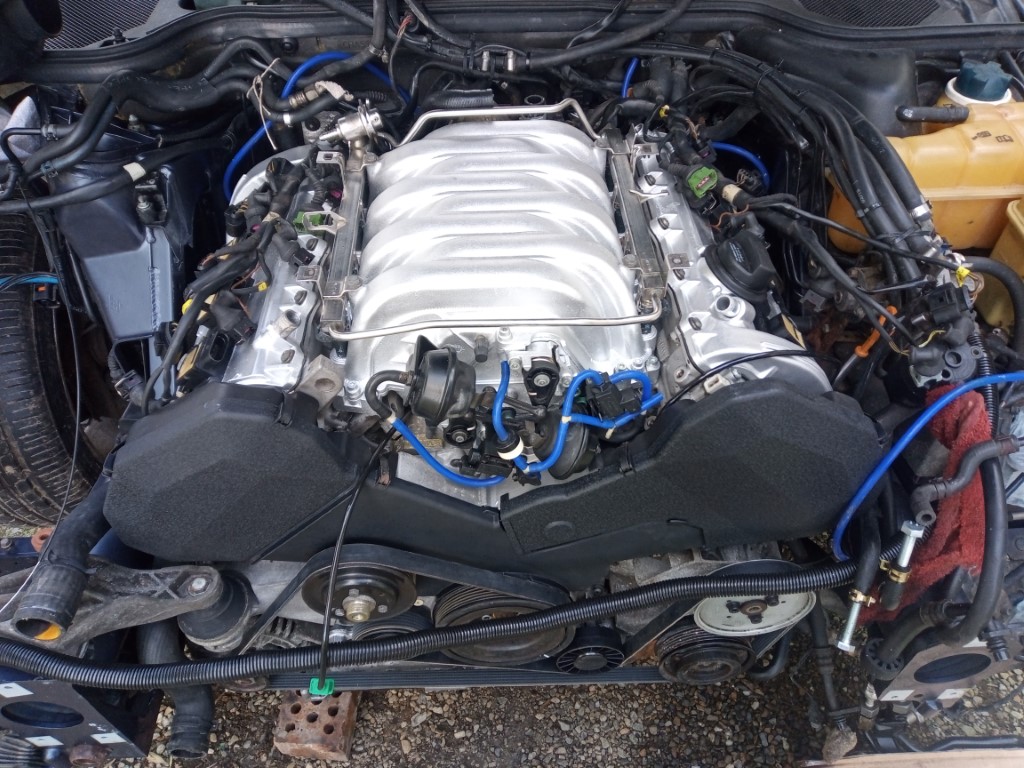

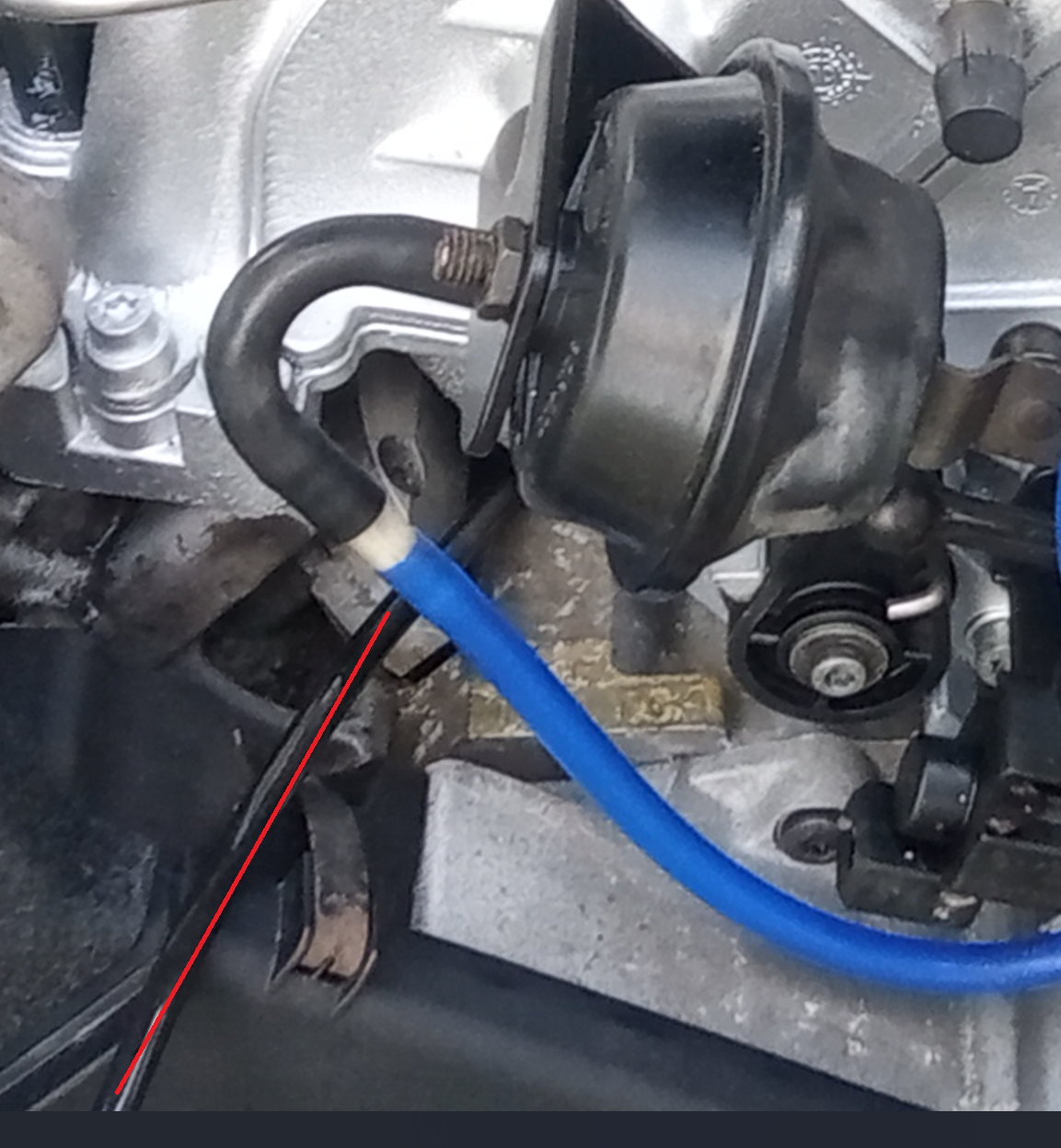

As for the cable route, here's a couple of photos from the following thread, from when I had a massive coolant loss, and then did as much work on the engine as I could:
https://forum.a8parts.co.uk/showthre...t=16865&page=6
This is the route of the original cable:
This is the route of the new cable. From memory, what I did was feed the cable from the 3-pin end underneath the coolant pipe, and then along the top to the front of the engine:
This photo shows the cable hanging down over the front after the manifold was put back on, and the next one is a zoomed in version, with the knock sensor marked in red. If you follow it up, you'll see the small gap that the cable sits in:
