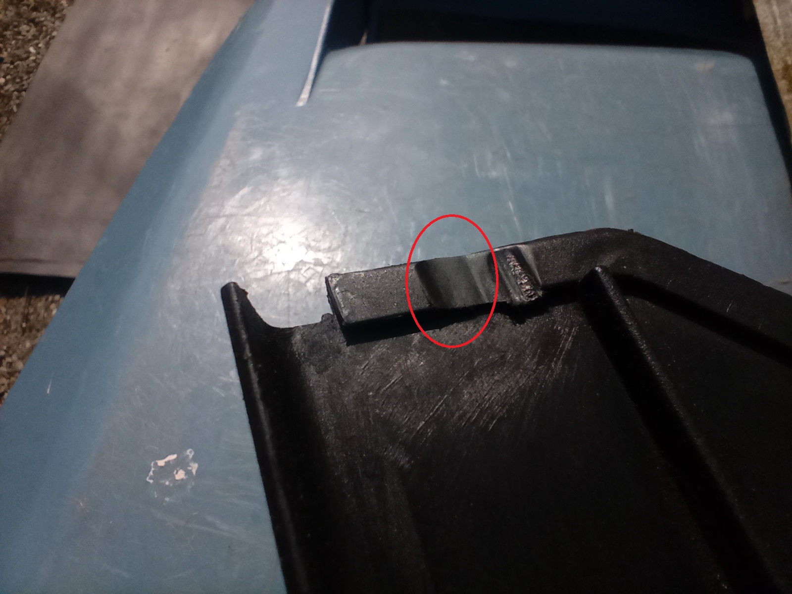

Well, it's back again. So I took off the timing belt covers to check everything out, and noticed two things. The first is that the timing belt was rubbing on the lower cover. The highlighted section of the photo shows where it has been worn down slightly.
