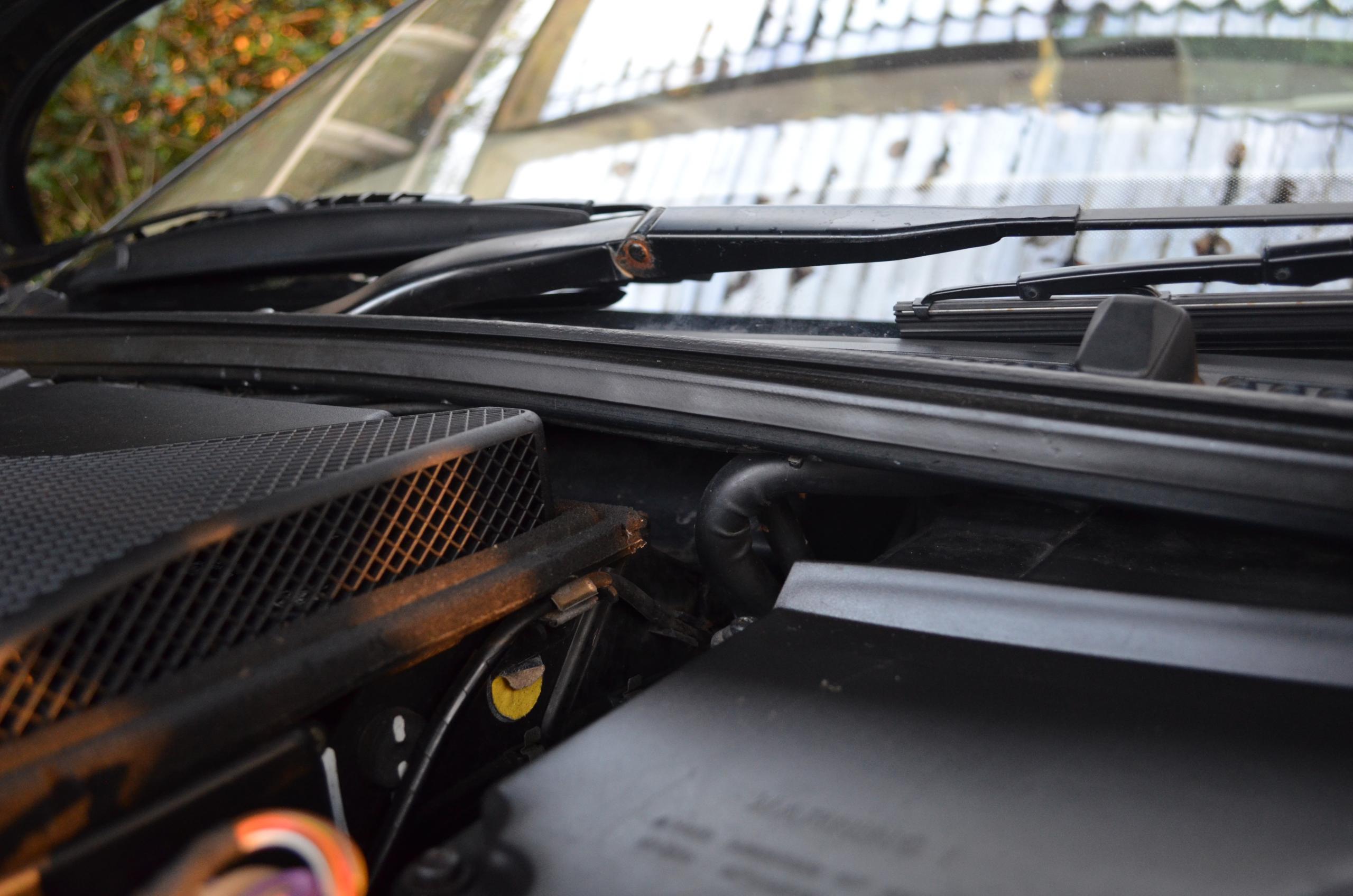

Mine seems pretty tidy and not "buggered" around. Not much to see to be truthful but hope these help, Andrew.
ID:	18439   Click image for larger version

Thanks for that David, mine's surprisingly similar but just lacking in length so tight.
I even have the same cable ties in the same places, though they don't look right to me.
Strangely, the pipe coming out of the wing on mine (as in Davids's photo) is about twice as long, but appears to be of a lesser quality. David's appears to be of a semi-rigid or reinforced pipe, whereas mine appears more like a thicker vacuum pipe.
I still have had the same problems as you Andrew, as the pipes from the right angled section onward are cut to the extreme minimum, and I've had one come off.

Originally Posted by Zip View Post
All the pipes are specific lengths....they have a little ballooned bit at each joint to hold the rubber 90 and t pieces on more effectively.
And if you look at David's photo you'll see even his are not properly pushed on - after the right-angle joint.
Old 15th April 2018, 04:45 PM
Thanks for pointing that out Andrew
I had the whole scuttle off a while back so have obviously been negligent when putting it back together. I will get out there right now and sort that out!
