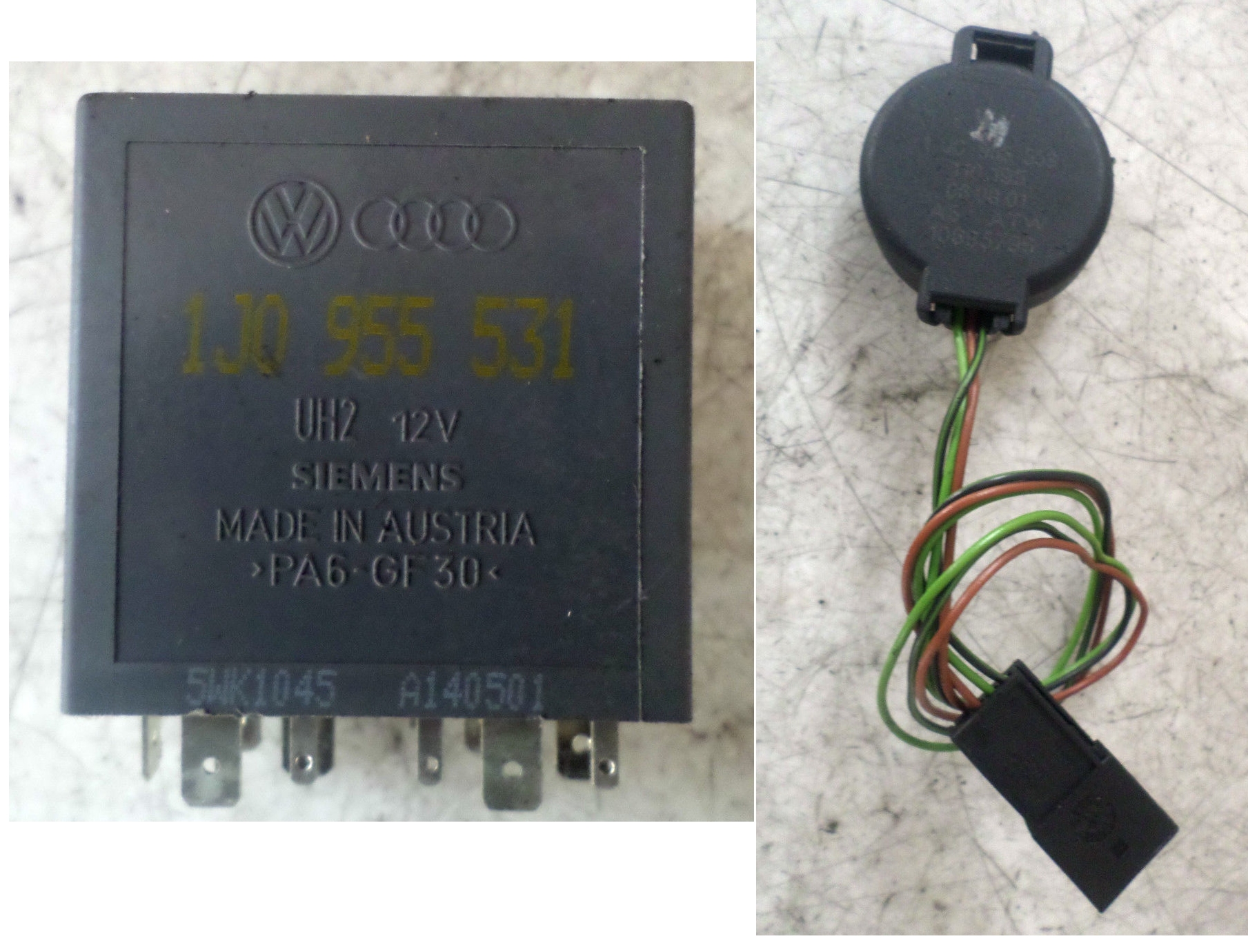

Just done (well still work in progress) auto wiper mod... and so far pleased with the results....
Involves swapping the Wiper control module (located in the passenger footwell), & mounting the rain sensor on the windscreen and connecting 3 wires.
1 is a gnd so easy enough to connect into the roof area where the light, sunroof control is and then simply run the other 2 down and connect to 2 of the extra pins on the wiper control module you swapped out. You could either solder the wires to the pins and pass then through the holder or order the pins and probably dismantle fit etc.
Mine was both from a Bora but Golf and many other are the same just the first bit of the part number will be different (based on platform).
I temp taped my sensor to the window (using glass tape) and at some point will buy the sensor mount and plastic cable channel to finish it off.
Lots of people that seem to do this mod replace the windscreen and often also do the auto dim mirror but (on other models). But I'm not fussed about the sensor being offset.. it;s just to the side of my rear view mirror. So from in the car I can't see it anyway.
Basically you leave the wipers in delay mode and the time delay switch on the wipers and becomes the sensitivity.
Light rain they randomly go and when stopped in traffic or slow moving even less so (as also car speed sensitive). When driving faster wiper more again partly because of speed and also more rain will be hitting the sensor... and if mega bad they actually switch to fast speed...
Still not perfect.... but I now like the fact that when stopped or in slow moving traffic I'm not having to mess with any setting as they change very well....
I managed to pick my two bits need from e-bay for £20 which was a great price... I believe the mount and plastic channel (from dealer) will be about another £8.
Have got a few pics, but think I will have to take some using my camera as my phone since last update seems to hide them in no mans land..... (modern tech.... grrr)

Even the normal wipers had a connection from the speed signal (so when in time delay mode) this would adjust the delay slighty when going quicker, however as rain can be so random from 1 min to the next still required either changing the time delay on the switch or then flicking to 1 speed or 2 speed from time to time manually of course.
As for rain sensor, this was not an option on the A8 (D2) but was not really available on anything back then....
There is are a few after market kits that you can buy and fit, but these all require a lot more hacking / re wiring... and I didn't fancy this option.
Looking at other models in the Audi / VW range as a lot of parts that can end up being the same... all be it the first part of the number will reference the platform.
In my case because I have an Older A8 as in 1997 I needed to get something from the Audi / VW range before the newer can bus systems or at least before it was all hooked into it, as I was not sure how easy it would be to then work around or even add other bits just to accommodate the mod on later parts.
For example the later rain sensor's (from what I can work out) come with a light sensor for Auto Headlights (another thing I'm still WIP on) but appears to then use the two wires to talk to the control module (which we don't have of course) and in turn sends signals to other units... So would not be as simple as adding the new type as you would need to either convert the signals or add other stuff ...
Hope this makes some sense...

The sensor part number (based on info i saved on my laptop) was 1J0955559, the control unit is in the passanger (UK) footwell basically behind the wooden panel with the 4 screws.
As to headlight washers... my car does not have them (something else I might, do... dum de dum dum).... but the control relay I have does include the headlight wash function... basically it has the extra 3 pins on the bottom row (again going from memory)
Later cars even had the option to then close the sunroof & windows....
