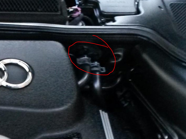

You can just about see them in a photo I posted in the 'Getting ready for the Annual Meet' thread earlier. They're here, at the top of the two hoses:

Old 23rd May 2017, 09:27 PM
Posts: 3,236
Attachment 16138
Perfect. Thanks
