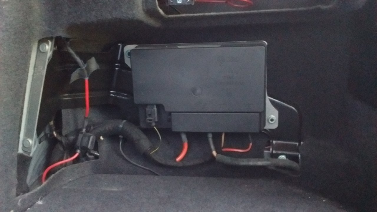

As MJ says, the controller is in the boot, above the battery. I have a photo of it somewhere, but can't find it. It is posted on here on the forum, but it's a black plastic box maybe 10x5 inches in size and about an inch thick, with some heavy cables coming from it. There are also a few fuses just above it, though not sure if they are relevant.
As to the screen itself, I believe there are four connections to it. One in each bottom corner (can't find that photo either), which you can maybe see in the gap between the dashboard and the A-pillar. The top two you can see if you remove the lighting module up by the mirror.
EDIT: Found the picture of the module in the boot:

After receiving request for heat from HVAC unit the module in the boot will check battery voltage and only after making sure the battery is fully charged it will send 42v via meaty wires to windscreen.
This is documented in ELSA and I have pasted exact logic in one of threads about heated windscreen.
So check if battery is fully charged and actually holds the charge during the heating cycle
