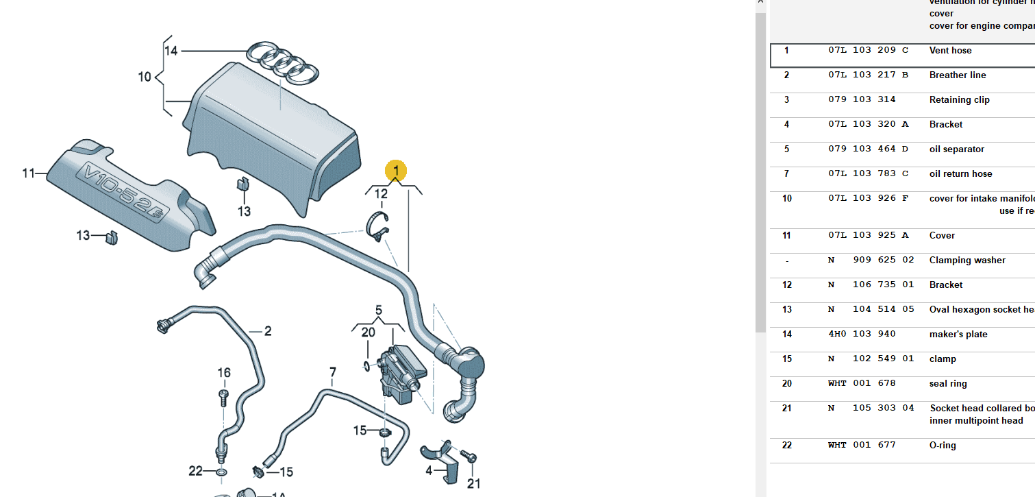

I have noticed under the bonnet that there has been a bodged repair to an air pipe, and I have taped it up temporarily. Looking on Etka, I am struggling to find out the part number. Anyone know which one it is?

It looks like the vent hose to me (part number 1)

I must be going blind! lol. Thanks steamship.
Any idea of it's specific function?
EDIT: Looks like oil separator to crankcase
That was my thinking as well, and if it feeds back into the air intake (for emission reasons), then I would assume that would be where you could add in an oil catch can.
