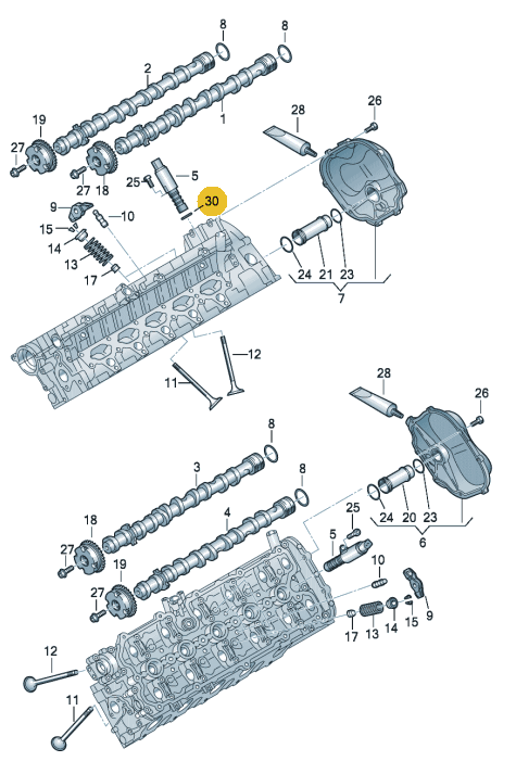

Would anyone have the part no for the control valve seals? Also am I right in saying all 4 seals are the same

In the attached diagram, do you mean the o-ring seal (30)? If so, the part number is WHT002789. Just over £3 from dealer.

That's it ( i spoke to dealers earlier this week but he couldn't find the part no ) thanks sean
