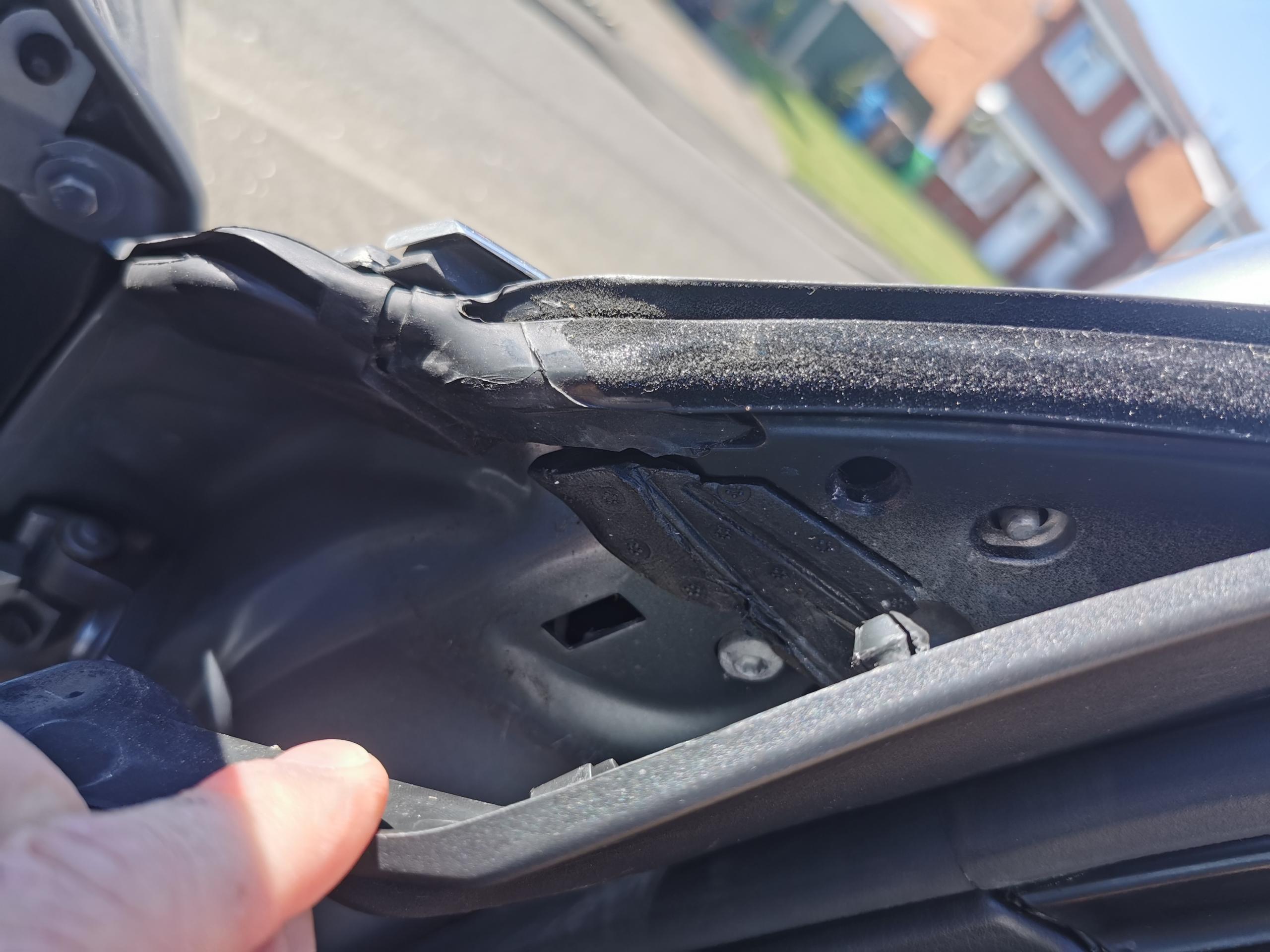

My A8's drivers side door mirror foldung motor has failed I've ordered a new one and started looking at how to remove it, I have the AUDI manuals but cannot find how to remove the plastic trim which was here in the pic attached.
I am assuming I need to remove to access the bolt holding the mirror on, the manual(s) dont seem to mention this!
Any help would be appreciated, I must be missing something!

I kind of thought it popped off, but I tried levering it with a trim removal tool it seemed really, really tight/fixed in place ...
I am worried that if I use any more force I will break it...hoping someone else can definitely say "Lever it". I dont really want to be talking the door apart to find out this is the case!

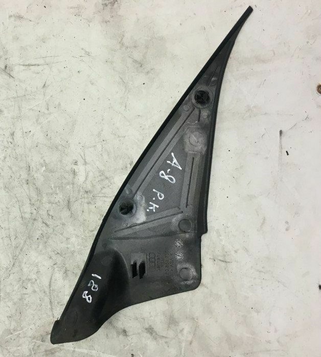

The following photo from eBay should help.
Looking at it, it appears to be held in with three clips, the twin flat one next to the Audi logo and two circular clips further up. From the shape, I'd say you should prise out the bottom left corner (photo) and then with the removal tool, pop out the twin flat clip from below. Then work up the left edge with the removal tool until you reach the first circular clip and prise that off with the fork shaped removal tool either side of it and then work up to the top clip. It looks very thin at the very top, so would be cautious to avoid bending (or worse breaking) any part of it. The only other concern is how it fits in respect to the two pieces of black rubber trim shown in your photo, as that might makes things a bit more awkward. The D2 one that HPsauce refers to is a lot easier as it is inside the door frame with nothing else around it.

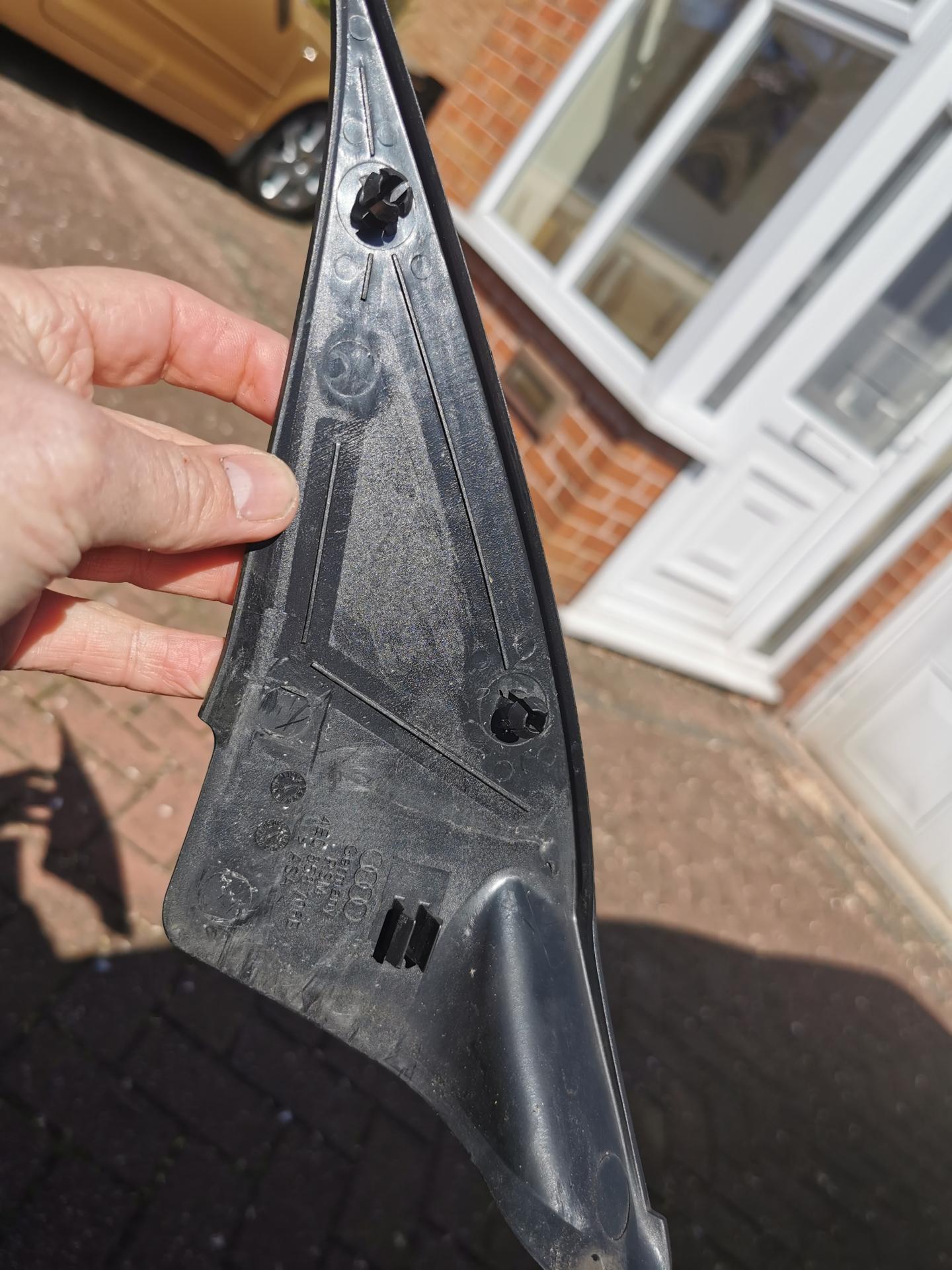

All,
It's sometimes just having the right info! it's now off, thanks so much, waiting for my replacement mirror motor now and will hopefully be able a simple fit now..
Weird how the Audi Manuals don't seem to mention this cover...
Thank god I dont have to take the door apart...again!
