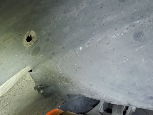

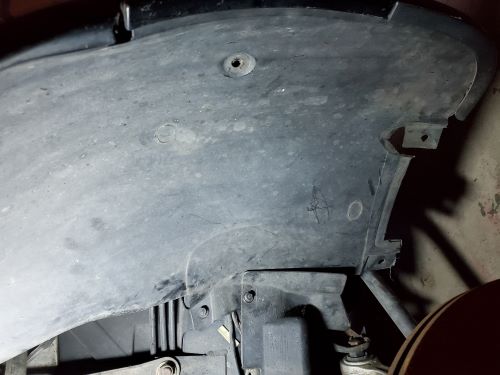

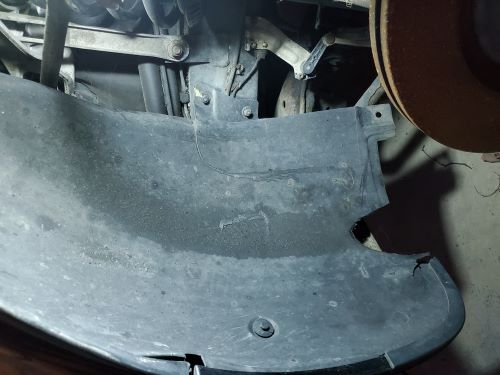

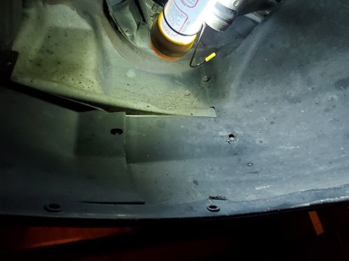

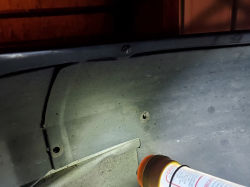

I didn't use my jack stands. I just used my floor jack to get the wheel off the ground and took off the wheel to remove the liner and reinstalled the wheel.
LH wheel arch liner has some damage. Anyone have the part number for this plastic fastener?
Missing hardware.
RH wheel arch liner damaged and missing hardware.

Old 16th May 2022, 09:01 AM
Posts: 3,236

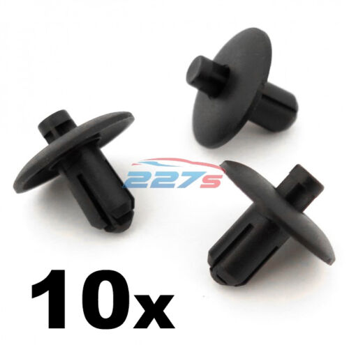

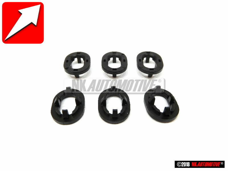

The following image should help in identifying all the relevant fasteners required. Based on the image, these are the associated part numbers, and how many you require per side. Note that these totals are for both parts of the wheel arch liner on either side of the car, and not just the front part. I've also attached images of what the part numbers look like in reality.
And yes, part numbers 12 and 14 are the same. Must be an Audi thing!
#10 - 171201969 - Hexagon collar nut (8 per side)
#12 - N90250001 - oval head panel screw (2 per side)
#14 - N90250001 - oval head panel screw (1 per side)
#15 - 4D0807300 - Spreader rivet (4 per side)
#16 - 443821699 - Clip (2 per side)
#17 - 811807577C - insert nut (1 per side)

Thank you very much! My car is missing a lot of these fasteners and I will eventually buy new replacements.
