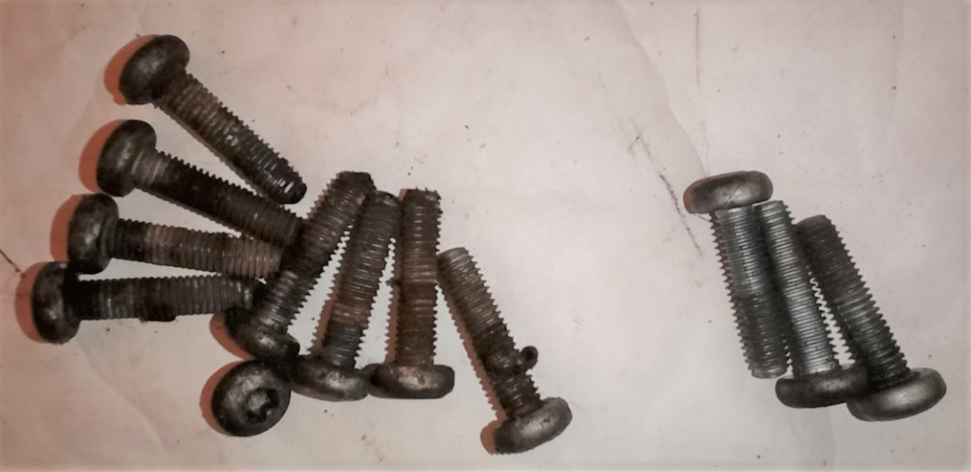

I was beginning to doubt myself, so dug out a few bolts just to check. Here's an assortment of bolts, each with where they came from. The two on the right are from the thermostat housing and crankshaft pulley. The photo doesn't do them justice, but there is a distinctive green line running along the bolt(s).

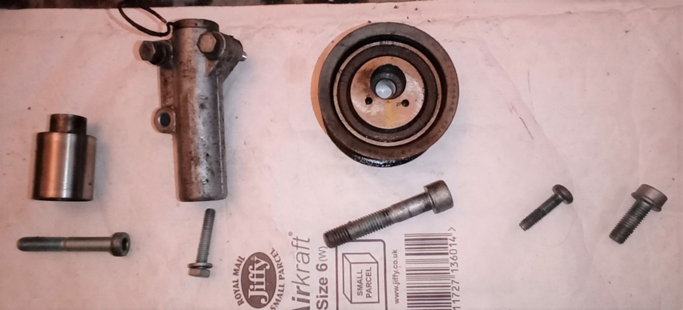

Thought this photo would be interesting as it's the bolts from the water pump and thermostat housing. Look at the state of the bolts (+ bolt head) from around the water pump. I had already decided to replace them once I removed them, so obviously a good decision.

I can't really tell what's on them from the photo, but the bolts have the usual green anti-corrosion coating on them. Could it be that you're seeing?
With those water pump bolts being so crusty I'd be inclined to run a tap down each hole and then blast them clean with WD40 or carb cleaner. The water pump gasket will normally seal up just fine on its own if the surfaces are clean, although I tend to use a light smear of blue hylomar on them. You could also use a very thin smear of silicone gasket maker, but it doesn't need much. The green paper gasket which comes with the OE pump has a thin coating on it already but a lot of aftermarket ones don't, so the silicone can help there.
Ah, another learning day. Didn't know about that. Presumably the faint green line along the bolt I'm seeing is where the excess would accumulate if lying on its side.
Exactly what I was thinking, having now purchased a tap and die set, and having to clean up the combination of paper gasket and sealant. I just checked the new water pump and the gasket is metal. Should I still add a touch of sealant?
Old 11th February 2023, 11:21 AM
Yeah given that people have been in there before and so the gasket surface likely isn't perfect any more, I'd be inclined to use the thinnest whiff of silicone on the block and pump surfaces to fill in any imperfections
