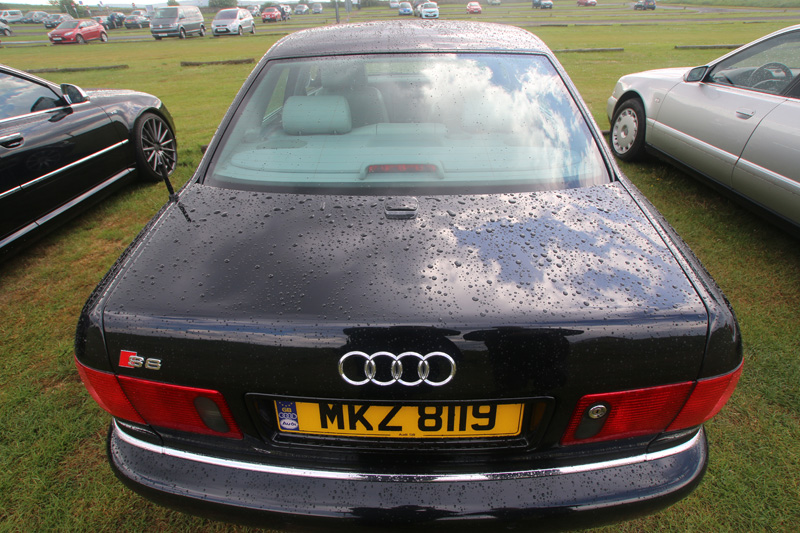

There were two blacks used on the FE - Ebony Black Pearl which is what yours is I think, and then a solid black (Brilliant Black?) which is what Stephen's is.
Out of curiosity, I dug out some photos from the 2017 annual meet to see if I could tell the difference. Taken at a slightly different angle, but within one minute of each other. Best I can do is confirm they are both black!
