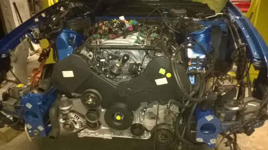

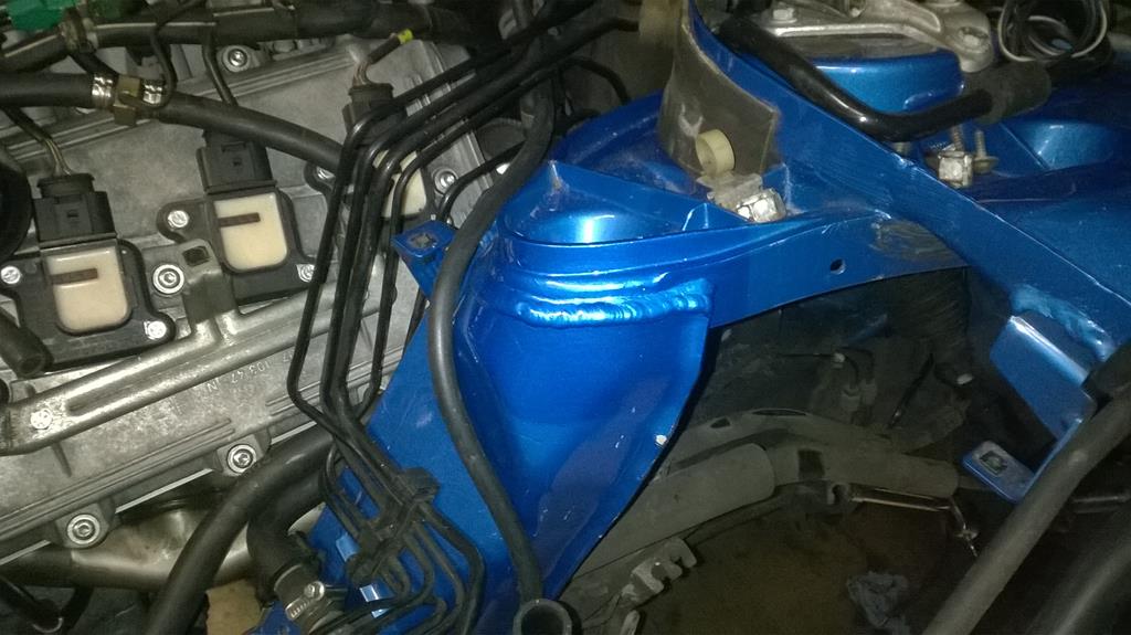

A more successful day today, albeit still with considerable upside-down backwards spine bending!

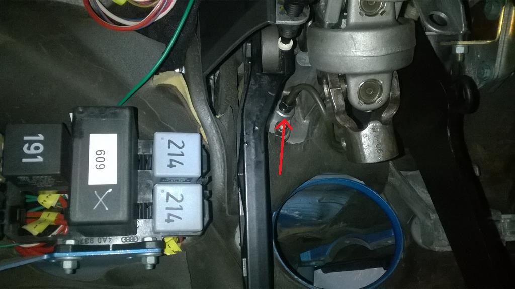

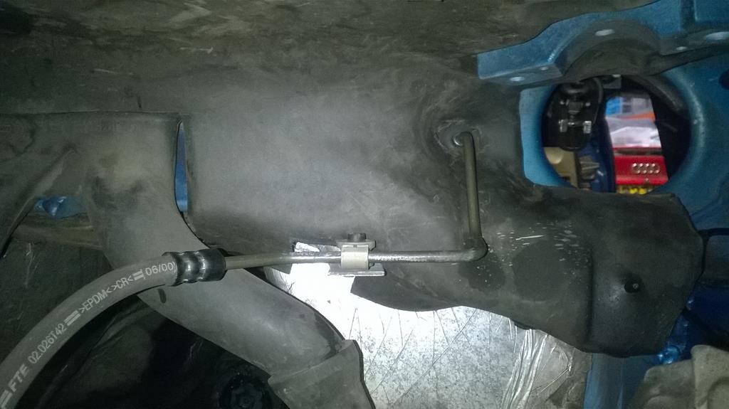

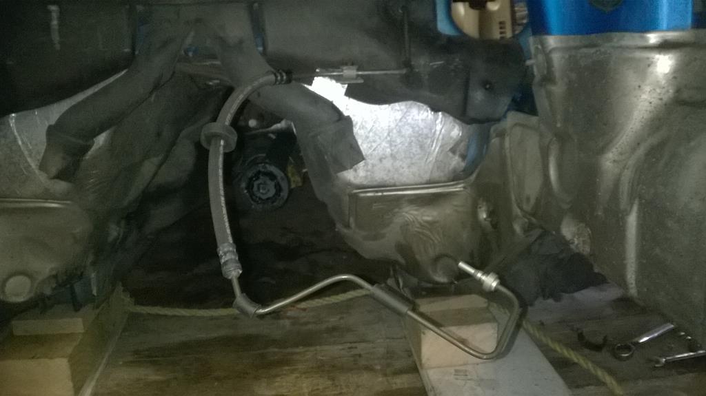

This is where the clutch hose screws in to the master cylinder It took about an hour of wiggling and tweaking to get the union at just the right angle for it to catch the thread.
Here it is from the engine bay. I reattached the slave cylinder and pressure bled it while the engine was out.

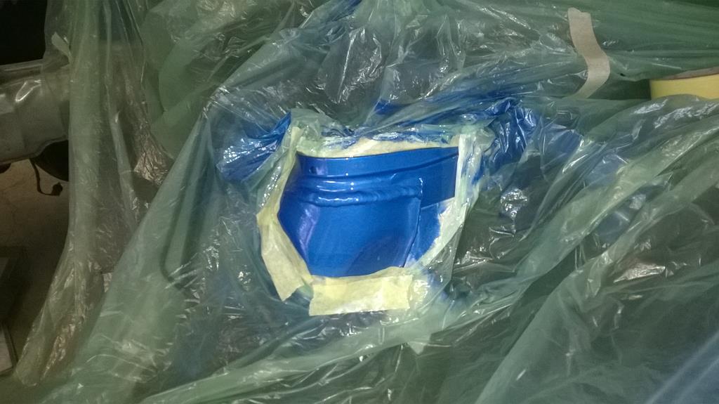

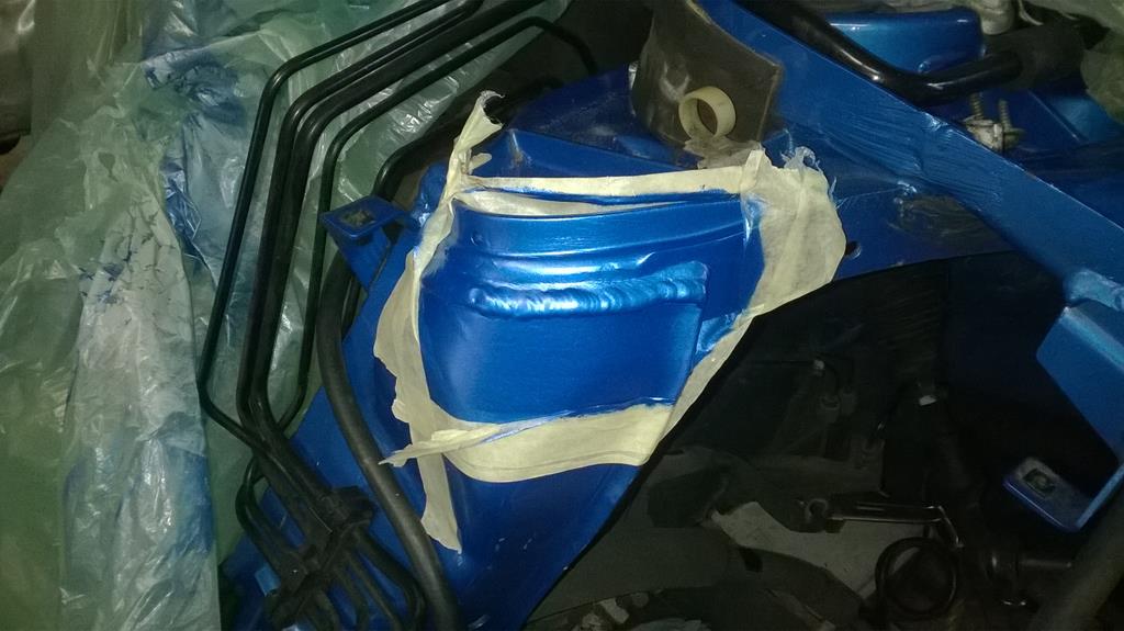

I finished off the paint too. Completely forgot to get pics of it in primer, but basically I've feathered the edges of each paint stage to blend it in.
Some colour on
Then clearcoat / lacquer
Complete
I'm pleased with the work, but rather disappointed with the colour match. The aerosol ended up having rather more purple in it than the original paint which in comparison is more green. If it was the same colour the repair would be nearly invisible. As it is, its acceptable considering you can't see it without removing parts.

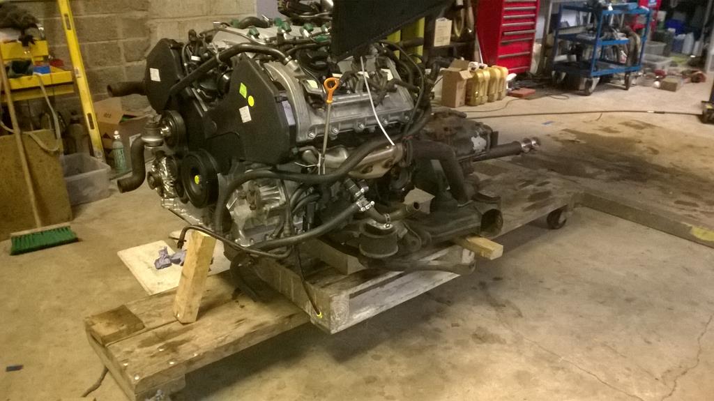

Engine ready to go back in
And bolted back in the car
Vera was able to stay long enough this evening to see the marriage of car and new engine

I know we are all a bit OCD on this forum MJ but as you have tp prize the covers off covering the turret and then still have a few pipes etc in the way along with the general road dirt I think its going to be hard to detect the difference in paint shade!!
Its interesting that Vera's paintwork is clear coated all the way inside the engine bay. Mine certainly isnt and, as I remember you showing me on Dean's red-mobile, his was half and half!

ive seen this crack on another members car when he had his engine out, his name escapes me at the moment,
great work MJ
Dave

Any idea as to why the seam at the turret has cracked and needed welding?
  #80
Old 14th April 2018, 02:53 PM
Posts: 3,245
Epic thread.
Epic thread indeed. As to your question, you need to go back to page 4, post 36 for precise details:
http://forum.a8parts.co.uk/showpost....2&postcount=36
No skipping any more posts There will be an exam at the end.
