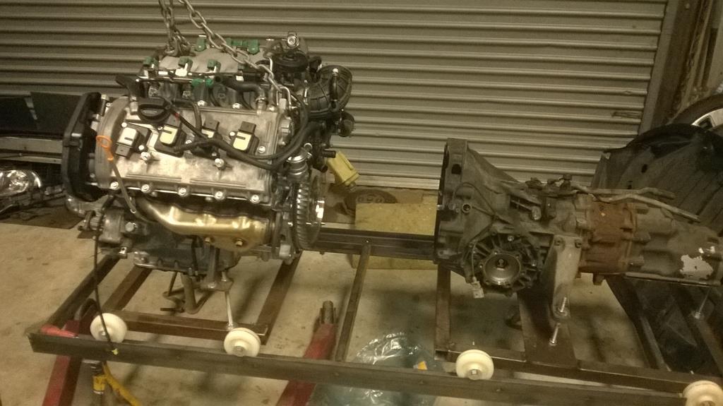

I've finished pulling things from the old engine and started putting them on the new engine.

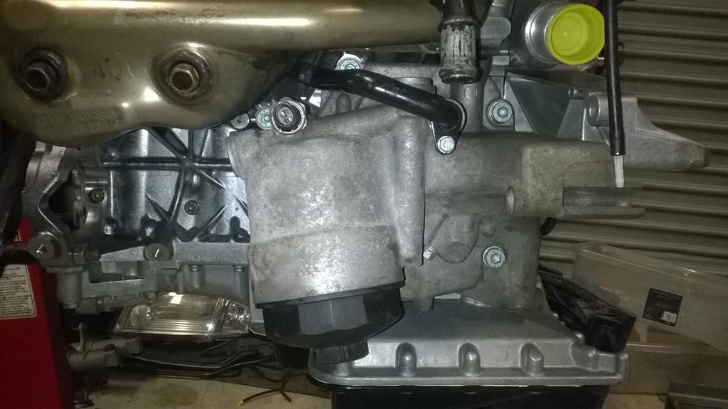

Oil cooler / filter housing cleaned up, fitted with a new cooler, filter, pressure sensor, connecting pipe and bolts.
We replaced the timing belt too. The old one is in visibly perfect condition since its only ever been run in at the factory, however it is 18 years old! Its a no-brainer to replace it at this point. Imagine the shiny new belt behind the shiny new covers, since I forgot to take a pic. You know what that looks like by now anyway

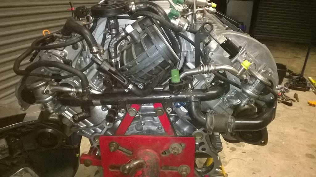

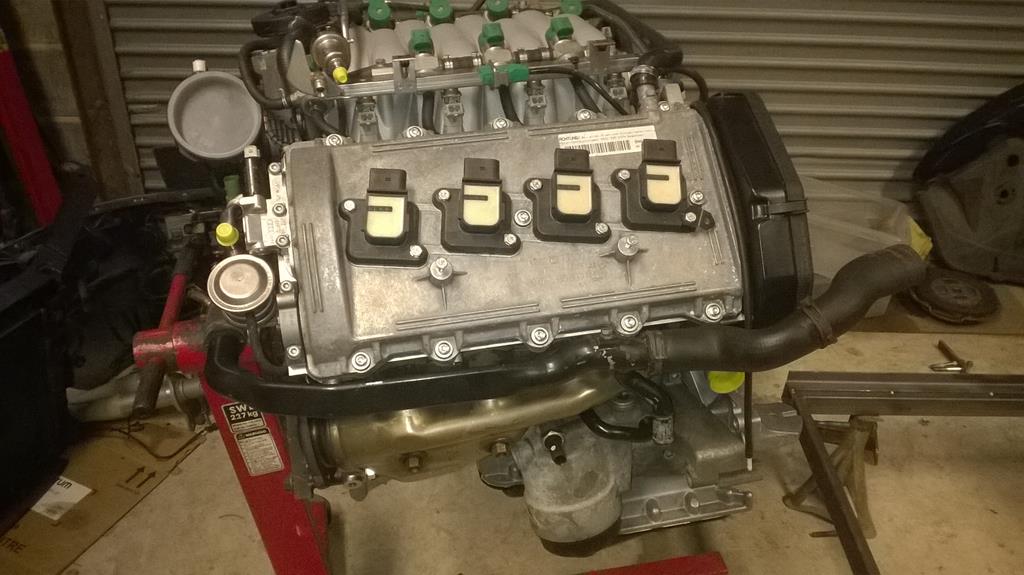

Fitted the main water pipes from the old engine to the new one. The pipes that came with the engine didn't have the fittings for the aux heater.

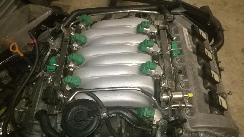

LPG injectors installed

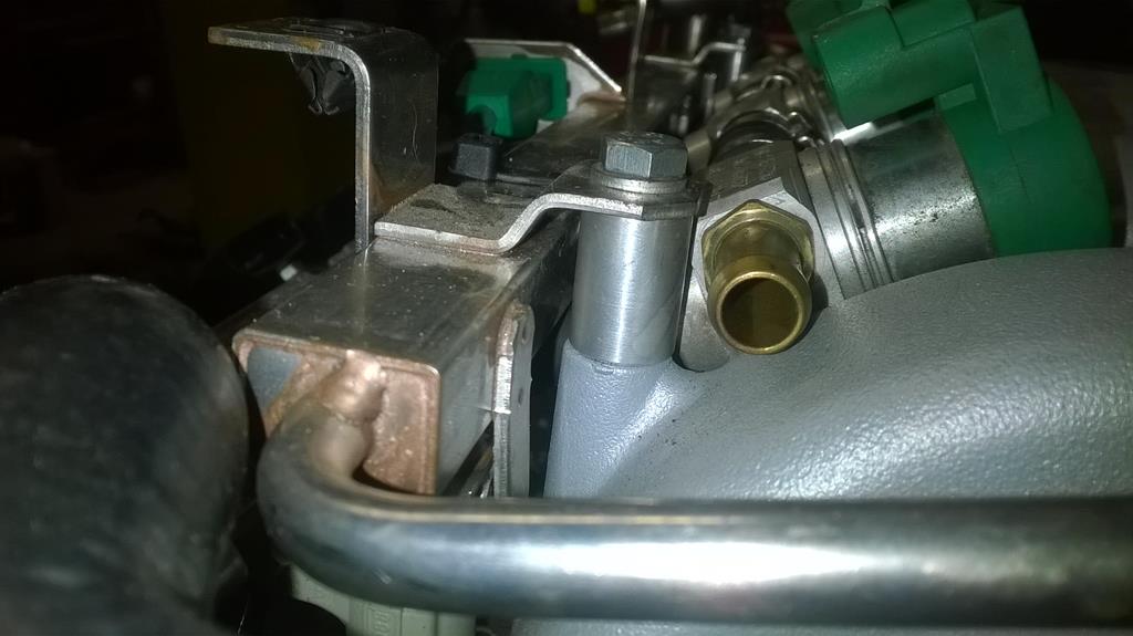

I made some 20mm aluminium spacers for the fuel rail. Much better than it just floating there

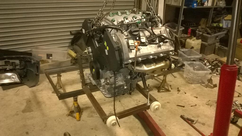

Engine going back on the jig
Cue angelic chorus: aaaahhhhoooooeeeeeeaaaaaaahhhhhhhh

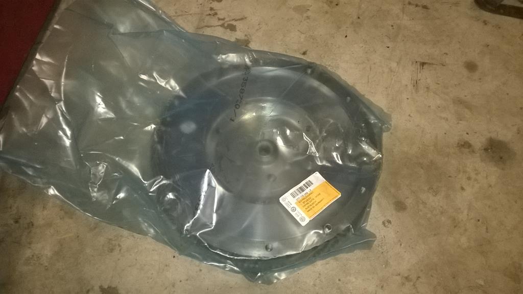

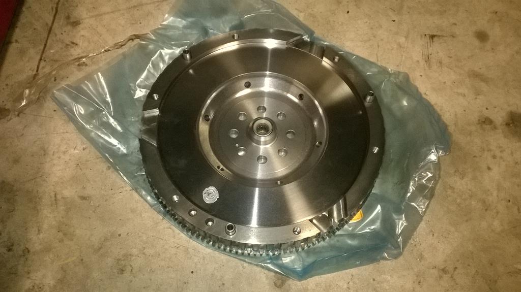

Factory manual flywheel Replaced since we're in there, along with the clutch of course.
Engine back on the jig. Only 5 of 8 flywheel bolts were delivered so I can't put it all back together yet. The remaining 3 will be here in the morning.

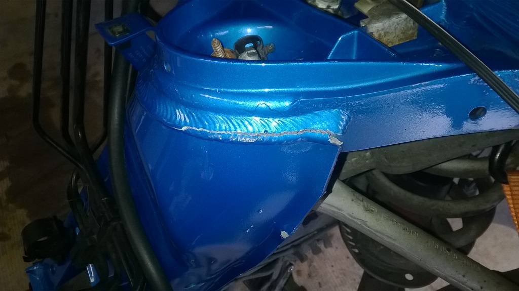

D2s are never straightforward...
We discovered this 3 inch crack while Vera was cleaning the engine bay
The tig guy is coming tomorrow morning so I can't put the engine back in today as planned.

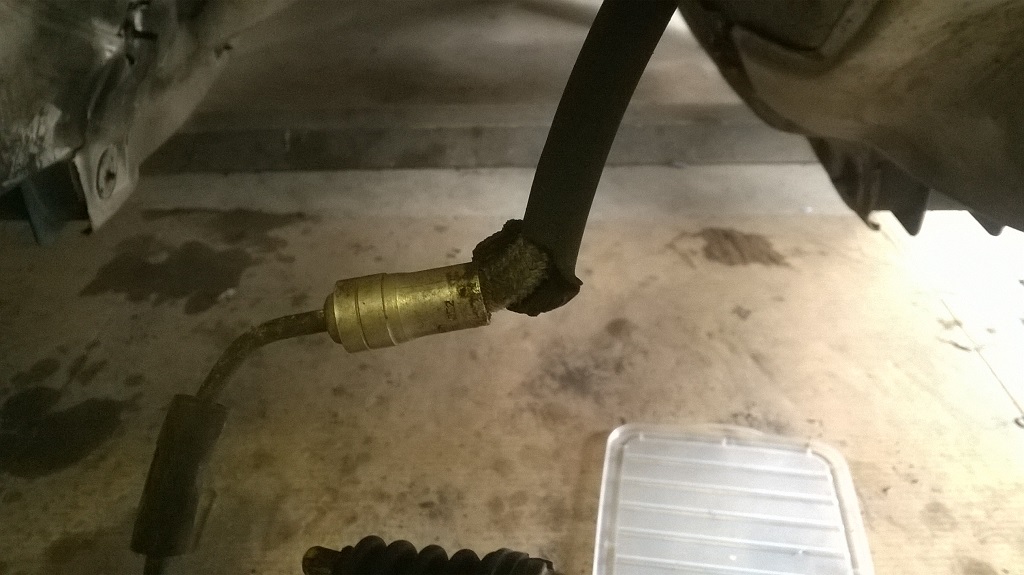

At the same time, we also discovered the clutch hose was frayed:
Thanks to Goran and Mike, I actually have one of these hoses on the shelf!! Its going to be a pig to change and I still can't put the engine in, but at least we have one.

Has the car been in a smack at some point? I think I read somewhere the official procedure after an 8 was hit was to remove the engine to inspect the BHD as they can crack. But that weld looks robot welded so wouldn't expect it to fail from a hairline crack from removing the cup to quick.
  #39
Old 11th April 2018, 05:14 PM
Posts: 3,235
At least she was in the right place when it was found.
  #40
Old 11th April 2018, 06:31 PM
There's no other evidence of accident damage. I believe this is from hitting a pothole and bottoming out as there is also the usual crack in the sound deadening above the control arms too. I've seen another one pull the brace bracket off the chassis leg from the same sort of event.
The tig guy is going to re-melt the weld to fill in the crack and I'm hoping the welding won't melt too much of the paint. Vera went out for a pelican blue aerosol this afternoon so I'm hoping to be able to make it look reasonable afterwards. The weld itself is hidden but some of the paintwork won't be.
