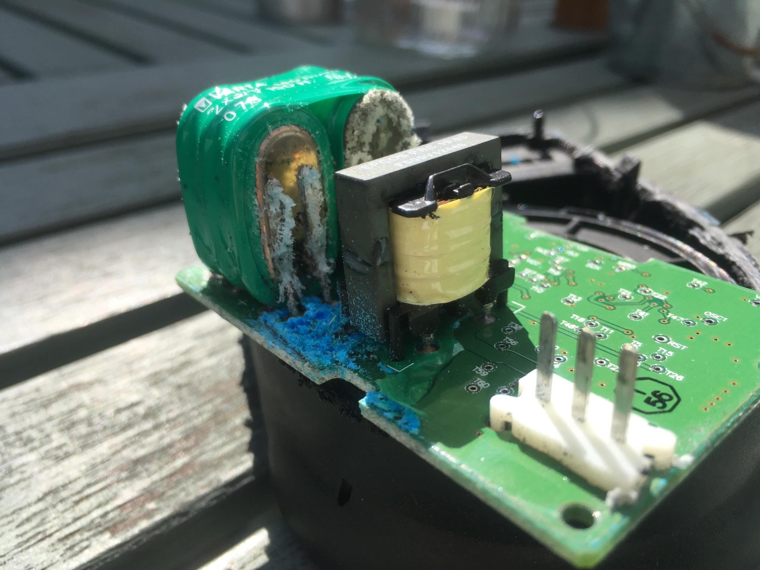

Just this afternoon I noticed quite a loud ticking noise coming form inside the boot, around the alarm horn/CD changer area. It’s ticking regularly, with the ignition off, at around once per second, and has been doing so for some hours now. (I don’t use the CD changer, but I do have phone prep, which I think is in that area too).

Does your alarm siren still work Jim? If not, might just be the old leaky siren battery problem causing the siren circuit to emit the ticking noise.

I’m not sure if it’s still working. Brian gave me one a year or so ago and it was OK when I fitted it. But I think I’ll take the damn thing out as this is the third that I’ve fitted. Unless anyone has found a lasting solution?

My lasting solution was to take it out and throw it away

Not aware of a compatible horn unfortunately, and you're already quite aware of the (continued) issues of replacing them. I replaced mine back in October 2013 with one I had scavenged from an '05 A4, and it still works, but you have to the hearing of a dog to notice it. It seems to lose volume as time goes by, that's assuming the batteries don't get to it first.
If I lock the car standing by the drivers door, I can't even hear the confirmation beep. As for the alarm itself, I just tested it (again from the drivers door) and it is pathetic.

This is the guts of the faulty alarm horn. probably past saving!
Still think you should follow my example
