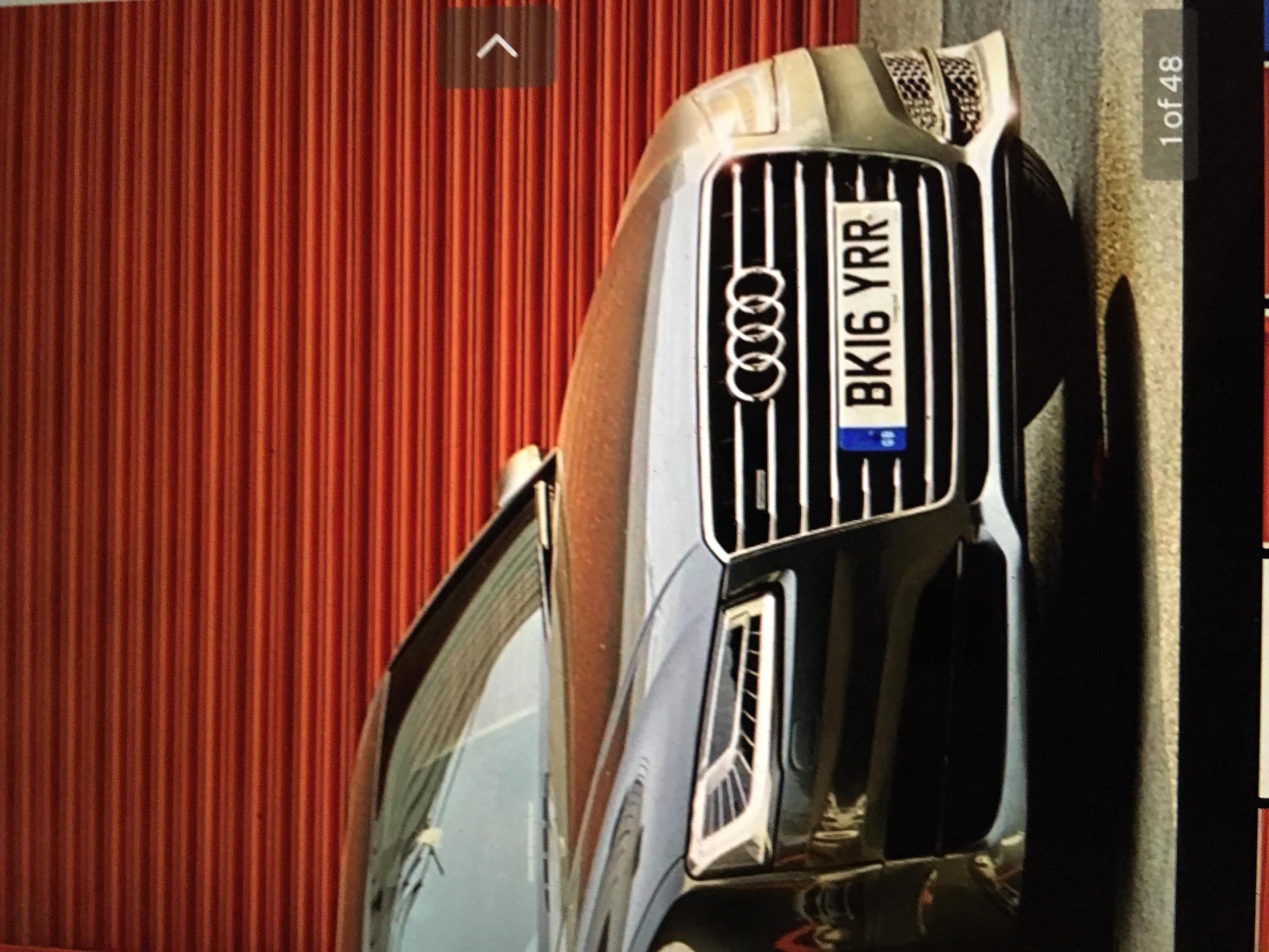

Also while I am at it, I would like to upgrade to the later bumper as per attached. My bumper has lot of chipping due to motorway miles. So will need respray inc the bonnet. Anyone know if the newer bumper is straight swap? Anyone know the part number too?
Thanks again

Just checked those variants (J,K,L,M) and they show up as being for the '10-'13 models. The part numbers I listed previously are for the '14-'17 models. Based on what you say, your's should be part number 4H0853651AD (£1,784). If you check the build sticker in the spare wheel well, it should have the PR codes 9R0 (without night-vision) and KA6 (front and rear view camera system and two side cameras).
I'm not familiar enough with the D4 but I think the grille only has openings for the parking sensors and the night-vision camera (which I believe is placed inside the four rings), with the 360 cameras being in the bumper itself. Hopefully someone more familiar with them can confirm.
As to the bumper itself, as far as I can tell, your's is a facelift model (2014) which should therefore have the latest bumper shape (if that was changed in the facelift).

I've still got the aftermarket one, but it's pre-facelift and one of the mountings is broken! My plan was to remove my current and fit the centre insert into the original chrome outer, this is a common mod in the broader audi world to get things like "RS" mesh into other cars, but never did it as I had to get Q7
If you're interested, drop me a PM, I'm sure we can come to an arrangement that would be significantly cheaper than the dealer.
Also, the sport bumper should fit the wings and bonnet fine, but you might want to check fogs, lower grilles etc. That will make the grille look cheap I suspect 😉
