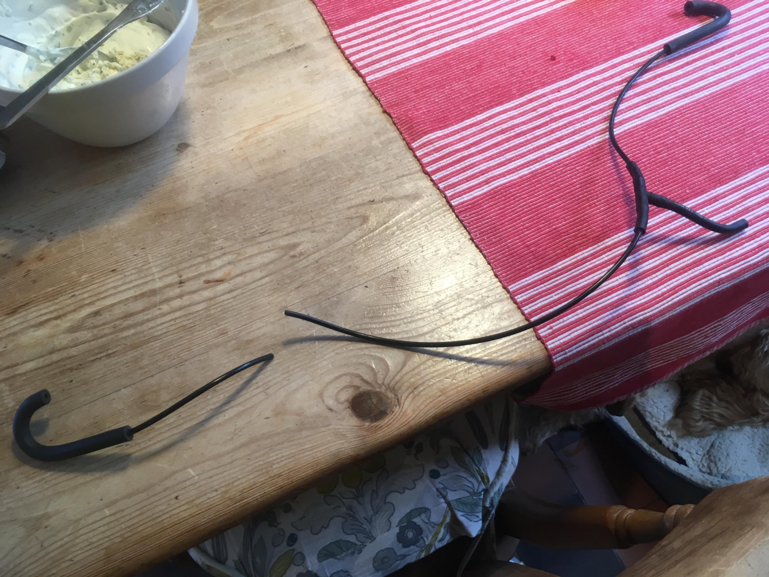

Old 22nd December 2022, 12:53 PM
Posts: 5,160
This code usually happens because the brittle plastic pipe connecting the solenoid valve on top of the bank 2 fuel rail to the two SAI vacuum valves has perished and broken and so they aren't actuating on a cold start. The ECU can see they're not working by the readings from the secondary O2 sensors.
Its simple enough to fix by replacing the broken plastic pipe with standard 4mm braided vacuum hose and a T piece.
Well, she's spot on yet again (see photo below). And thanks to Sean as well for sending me the guide from Audipages.com. I only replaced the plastic pipes that Michaela mentioned as I couldn't get to the vacuum reservoirs without major (for me) dismantling work.
Started it up and the engine management light went away without even needing to clear it!

Old 22nd December 2022, 02:54 PM
Posts: 3,227
That's the ones that failed for me, right at the back of the engine bay. The rubber pipes had gone brittle and were falling apart, and it was literally the braid holding it together.
Old 22nd December 2022, 06:18 PM
Posts: 5,160
The pipes that I photographed were just plastic - not braided rubber (they are now though!). One had snapped. I re-used the T-connector and will replace the rest of the hoses as and when I need to, or when I have more stuff off the front end.
Old 22nd December 2022, 09:29 PM
Plastic is standard, but many of them have already been replaced by braided hose, probably multiple times.
