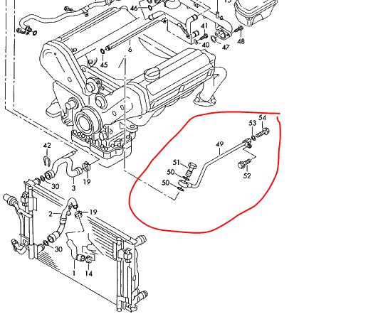

Went outside and jacked up the car on the N/S so I could have a look around, but couldn't find that pipe. Can't visualise exactly where it is from that image. I also checked the radiator as best I could and couldn't see anything obvious, with both pipes secured in place.
Anyway, as the engine was now dry I decided to pour some water into it to see where/if it would come out anywhere, thinking it's going to be in the same area, but nothing. Instead, it came out from pipe #9 (top of radiator) where it joins to the metal pipe (#11). It wasn't running along the bottom of either pipe to the join, but from the join itself. I removed the pipe completely and examined it from end to end but didn't see any obvious defects. I also checked the end of the metal pipe as best I could. I also took the liberty of removing the other radiator hose (#10) to drain as much water as possible.
Would you have a photo of where the pipe you suggested is on the engine and where it exits, and assuming I can get to it in situ, I'll drain whatever water is left in it.

There might be a pic in one of the WITW threads with an engine on the stand. I'll have a look through the archives. It runs vertically from behind the PS pump down to the sump, not horizontally in the silly diagram, and is bolted to the upper sump casting right behind the ac compressor. You'll need the undertray off to see it.

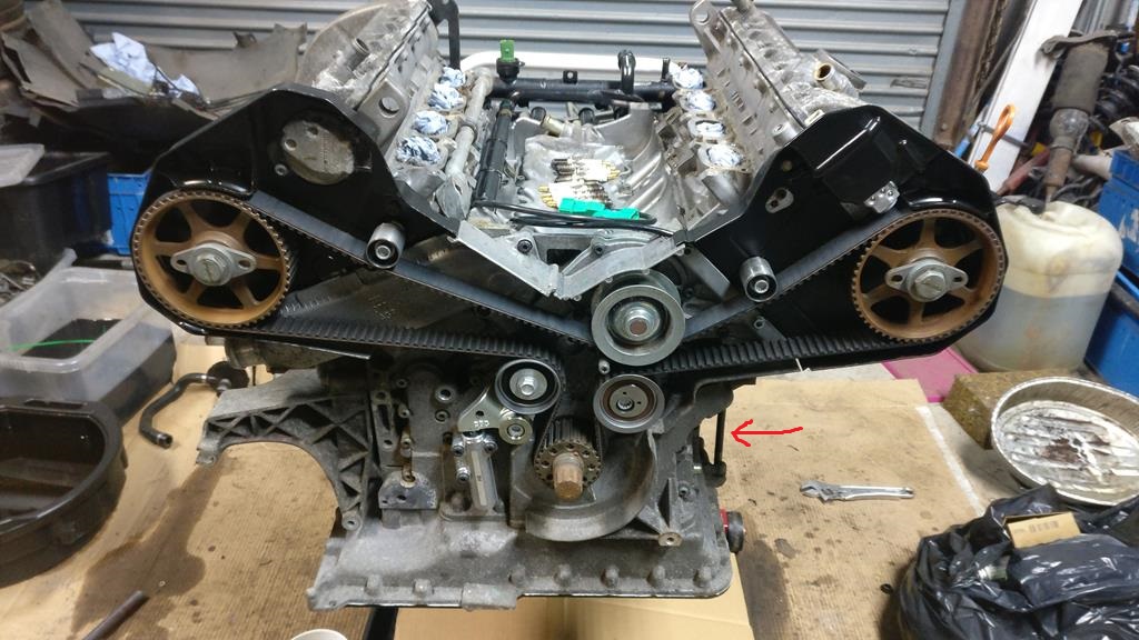

Those are 32V pics, but pic2 is of the place where the pipe is attached on the 40V. I found this from the barnfind FE thread:
You can just see the pipe on the right hand side.
