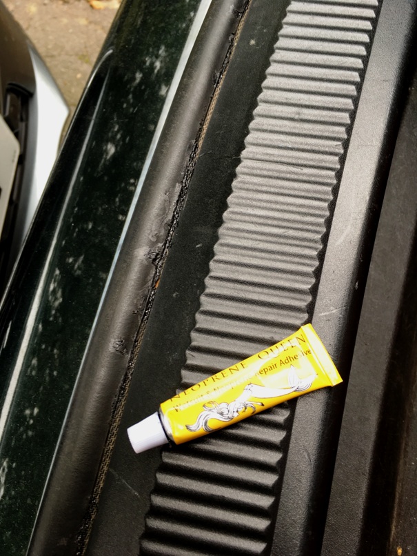

The replacement seal (used, from our sponsors) had some inevitable minor damage along the bottom edge but I've repaired most of that with neoprene adhesive. I used something designed for wet suits called "Neoprene Queen".
This is about a third of the total dealt with. No "before" picture for comparison, but it's an awful lot better now than it was.
