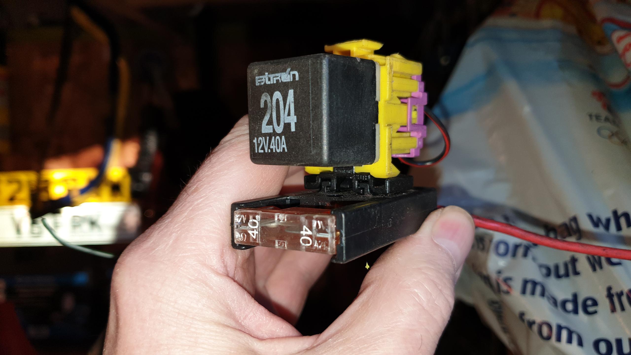

I have this (picture below), PM me if you need it at all. I'll send it to you.
You could use it as a template for making up your bridge wire if you decide to go down that route.
If you don't use it in the end, just send it back.

Many thanks, I'll probably take (and keep) that for backup/testing; PM coming your way.
How come you have that kicking around?
I've already made up a wire, using 6.3mm tags as MJ suggested. I'll try it another day though, once I've worked out EXACTLY which holes to bridge - don't want to blow a fuse somewhere!

I have a real paranoia about needing something to keep my car running that becomes NLA. Thus I spend a fortune on buying random bits just incase I need them. This was bought, along with the other footwell relays from a8parts.
I'll send it out tomorrow morning.
