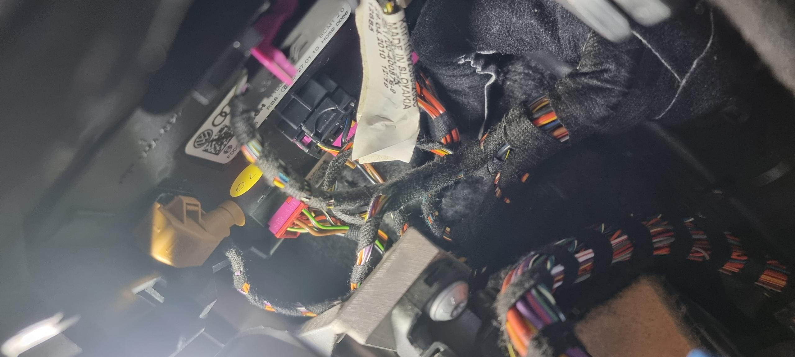

It is also deeply hidden behind the dash above the pedals. I've managed to get clear photos of the parts labels but getting it out looks like a hand shredding experience.

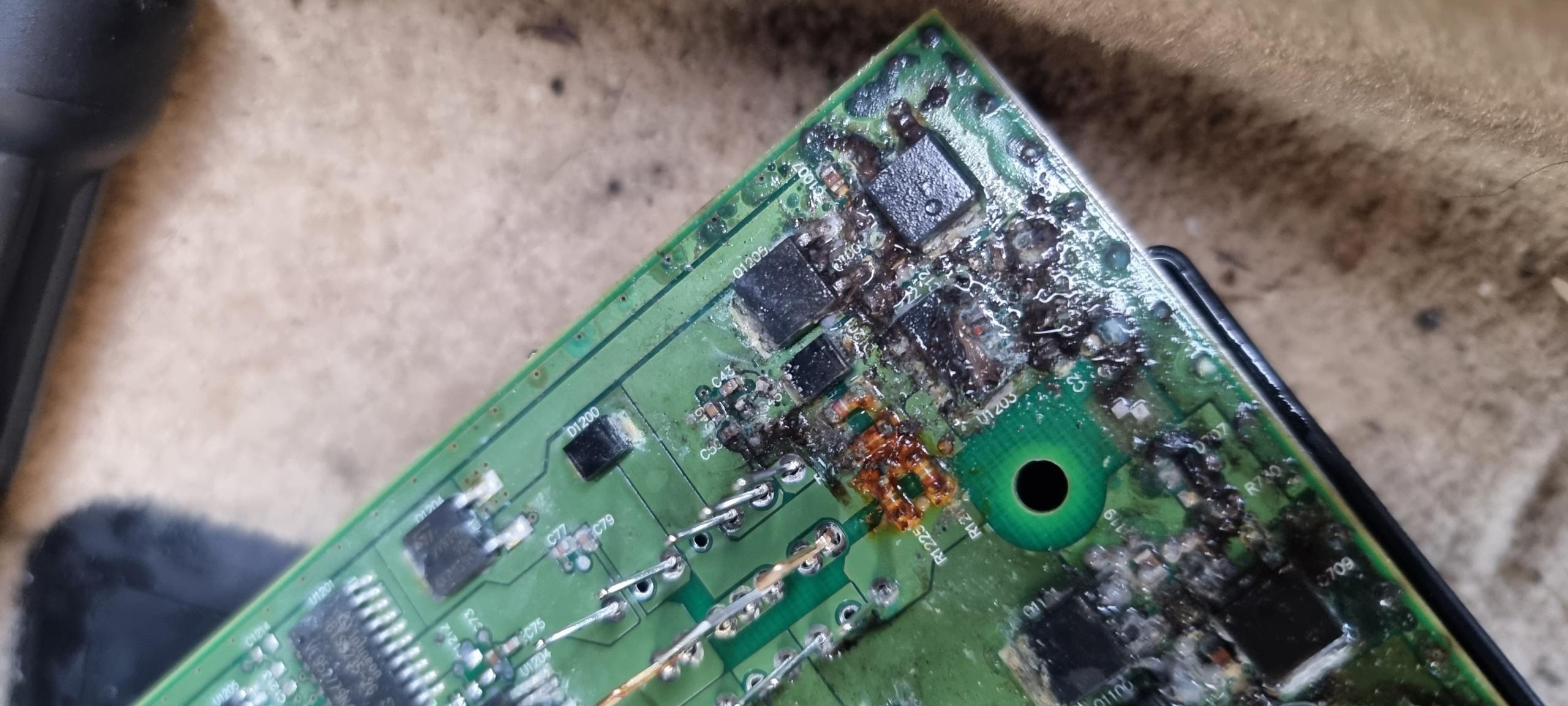

Absolute nightmare to get to under the dash above the pedals and then getting in to unclip all the connectors was not fun. This is where it got interesting as I finally manoeuvred the old one out it started dripping water out of the casing. Opened it up as you can see and its been sitting in water and gone rusty hence all the random symptoms with the horn and lights, washer etc.
So it seems it was nothing to do with the jump start it was water ingress round the windscreen/sunroof. I sealed the new one with mastic on the upward facing side so if any more water gets in the car it wont get in the module.
After re-fitting the car started, but no dash screen, MMI is very dark, no windscreen washers and the power steering is still heavy.
So I obviously need to code this module does anyone have a list of coding or a link to where I can code the options for my car? Or suggestions of where i can get it done in Harrogate area?
