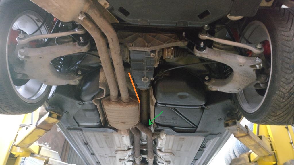

Old 24th February 2023, 08:28 PM
Assuming the garage has a lift, or at least an MoT pit, then the adjuster nut can be reached with a long extension over the top of the exhaust. Its fiddly but entirely possible without taking anything apart. I'm sure I posted a picture of it somewhere - possibly in the barnfind FE thread.

Old 24th February 2023, 09:11 PM
The adjuster is in here, above the prop where the green arrow is.
I go in from above the centre silencer with a long extension, over the top of the exhaust and propshaft.
