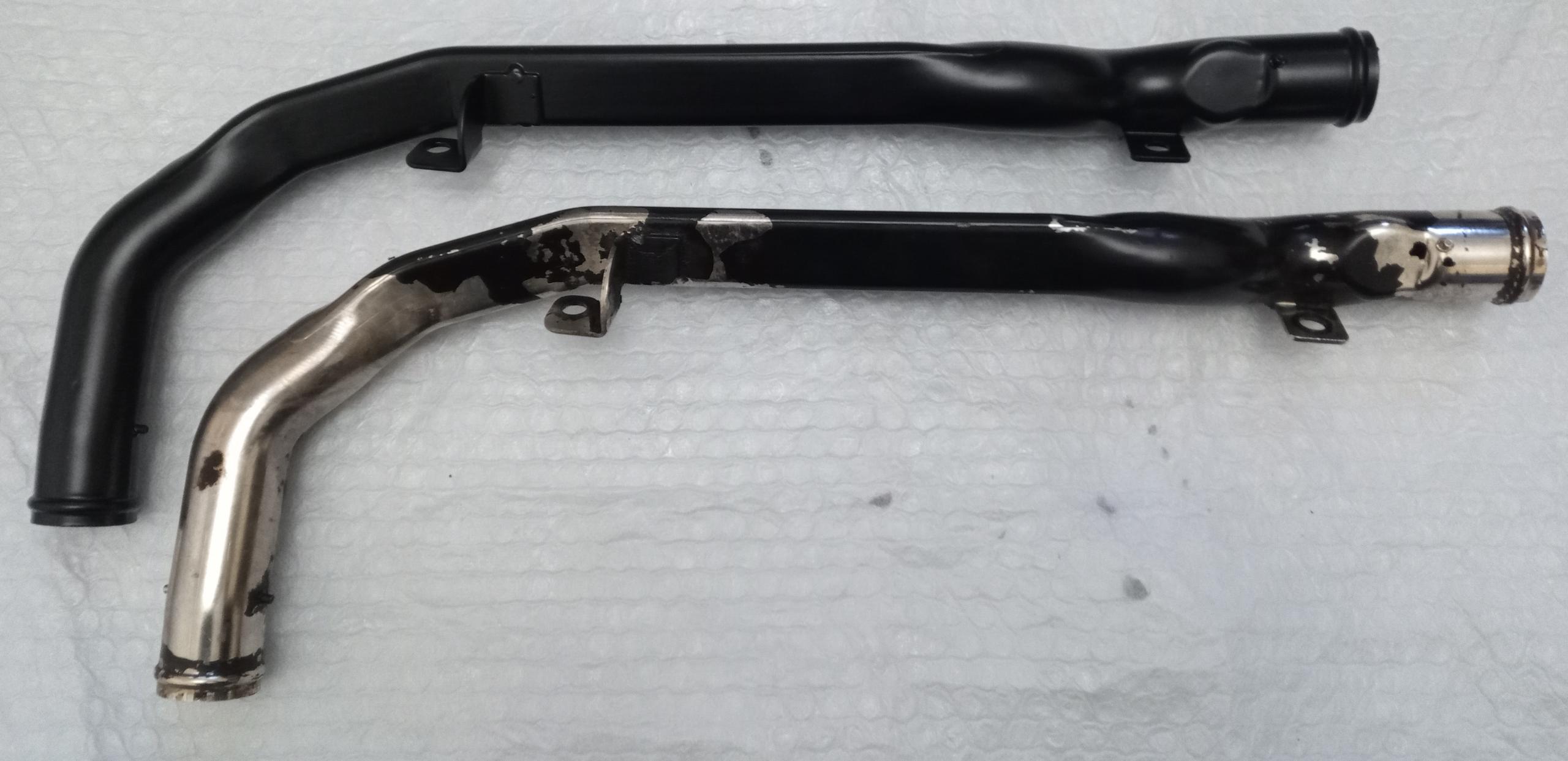

The good news is that I got the refurbished pipe from MJ yesterday, and fitted it today. You can see from the photo a comparison of old and new. Fitted everything back together again, no spares parts left over so started filling it with antifreeze and water...
Now the bad news. There's another leak from the front of the engine, but I think I'll need to take the entire front off to see where it's coming from. Hoping it's something simple like the water pump gasket or water pump, but fearing the worst. Not a very good photo, but it's taken from the top of the right bank, looking down towards the centre
