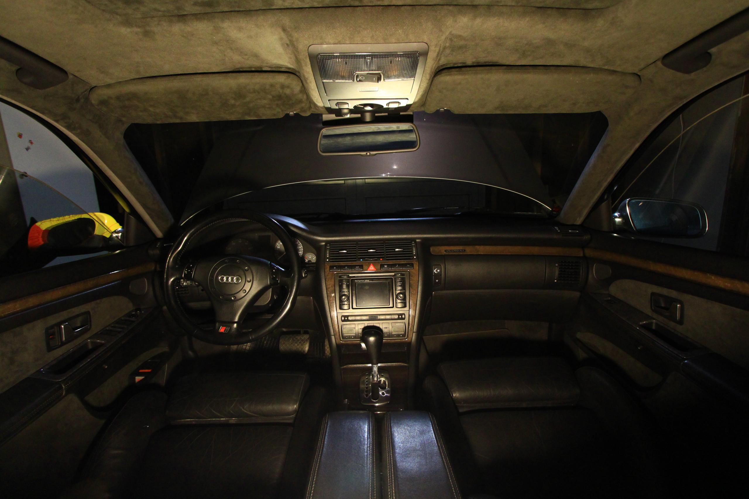

I have this steeringwheel today, and i guess it means its a straight forward swap then?
