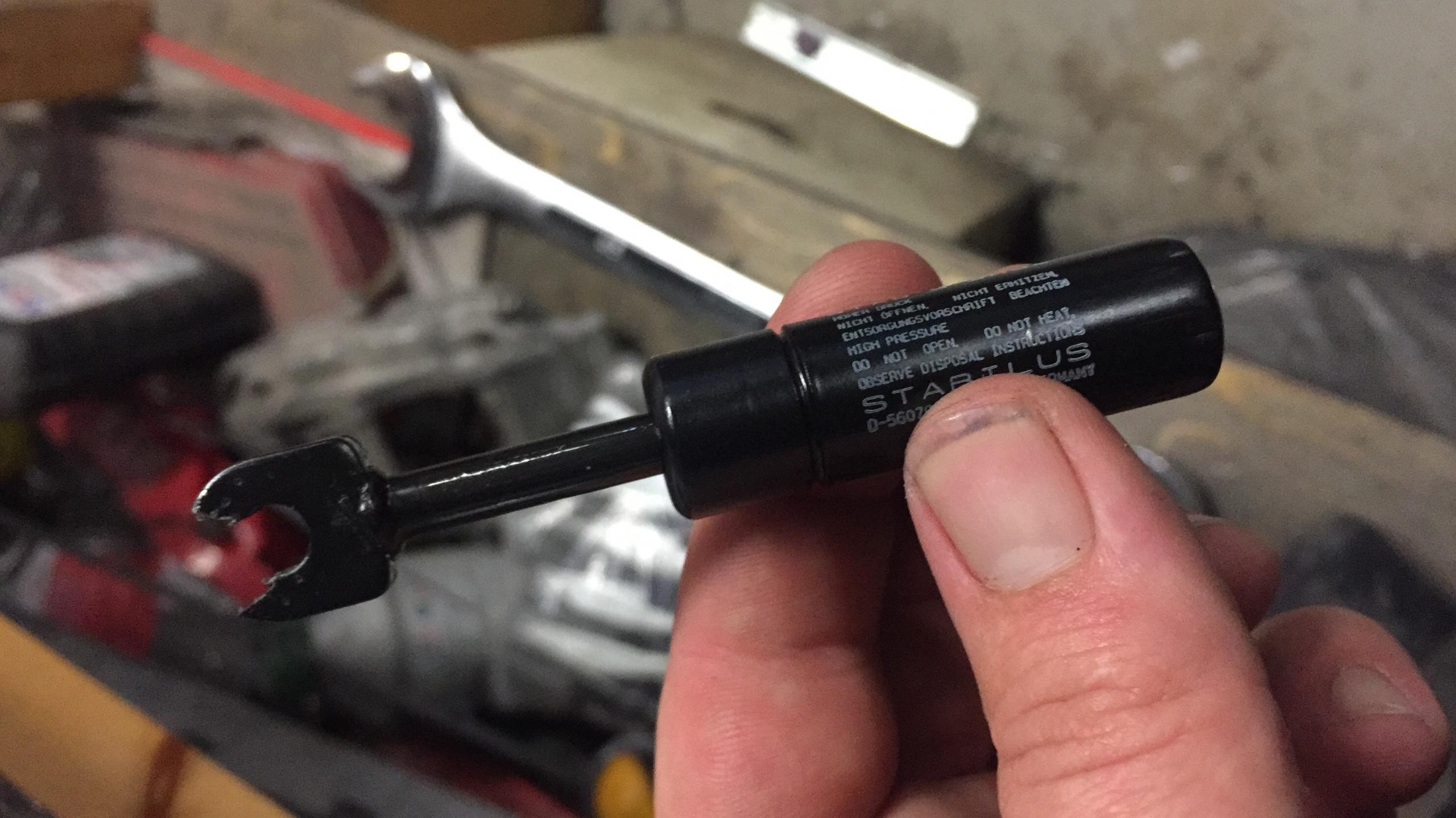

Anybody found these online yet ? Both of mine have jammed in the open position now the last two weeks, so I opened up the armrests and cut them out..

I got in cntact with the manufacturer and they confirmed that they are obsolete with no alternative part available. I did get the specs from them in case someone else makes something suitable and will post them up:
Extended length 89.5mm
Stroke 18.5mm
Rod diameter 6mm
Piston rod length 50mm
Extension force 100N
Tension force 45N
