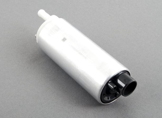

That does sound like classic fuel pump failure now, with a full tank. There is only one electric pump, in the right hand side of the tank. There is a second outlet on the electric pump which drives a 'suction jet pump' in the left hand side of the tank to keep the fuel level balanced. The suction jet is basically a venturi powered by fuel flow.
The complete pump assembly from Audi is ~£1K which is daft, but luckily the original VDO pump is available separately here: 405-052-002-001Z for £128.
The extra outlet is the small tube next to the large pickup pipe on the bottom of the pump. This is what makes it unique to the D2:

Fuel pump replaced as predicted, MJ. The unit that came out of the car was marked VDO, as was the replacement. It took the garage a while to do, as they'd agreed to pull out my gargantuan sub box which weighs upwards of 60 kilos! Nice and smooth on the way home, and dare I say it - it seemed livelier with a bit of spirited driving as they say. I cannot get over the fact that it's really quite small, and not even as long as a toothbrush. Still, I suppose it's done a sterling job over the last 19 years.
