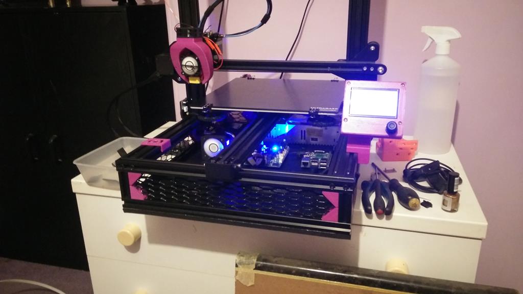

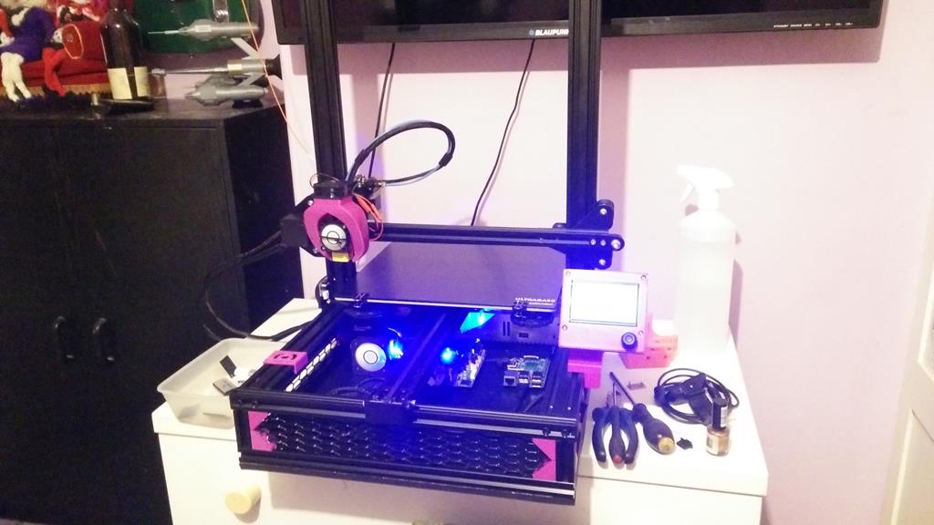

Current state of the CR-10S:

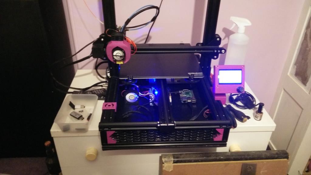

Fully self-contained now with all the electronics in the base, including a Raspberry Pi 3 which was supposed to be running Octoprint. More on that later.

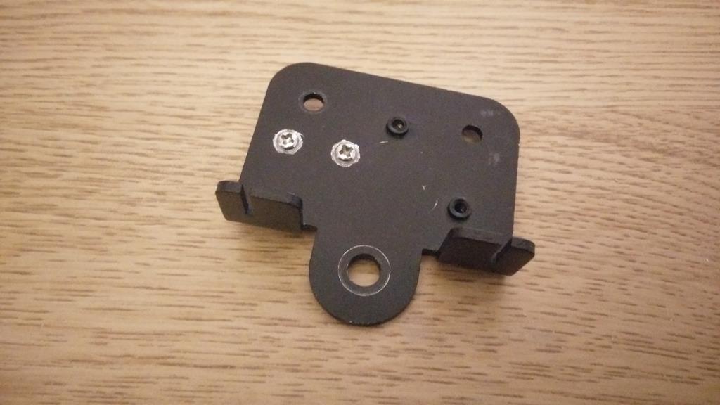

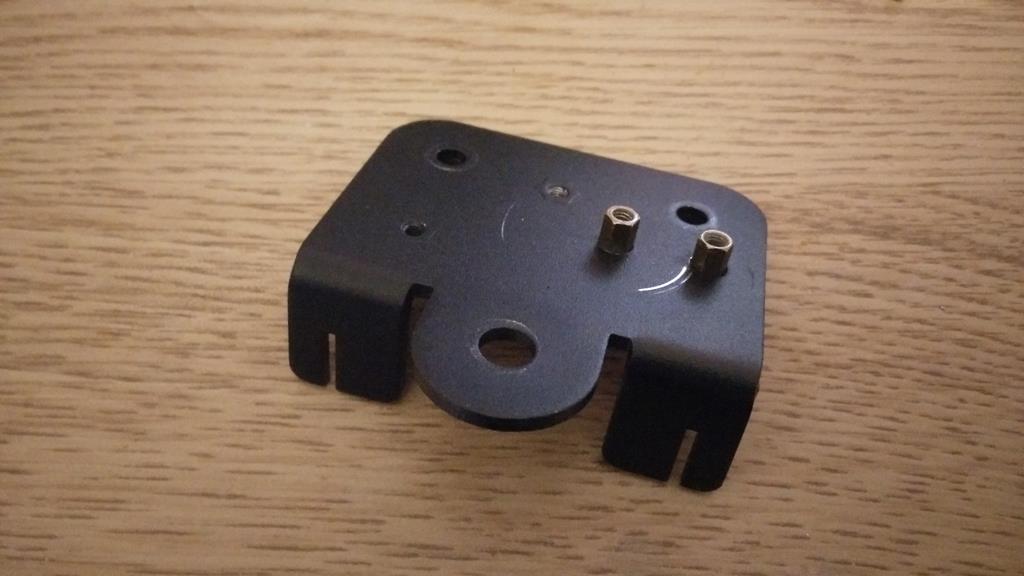

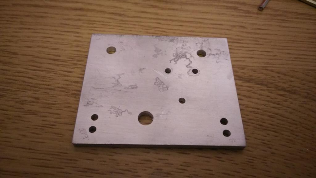

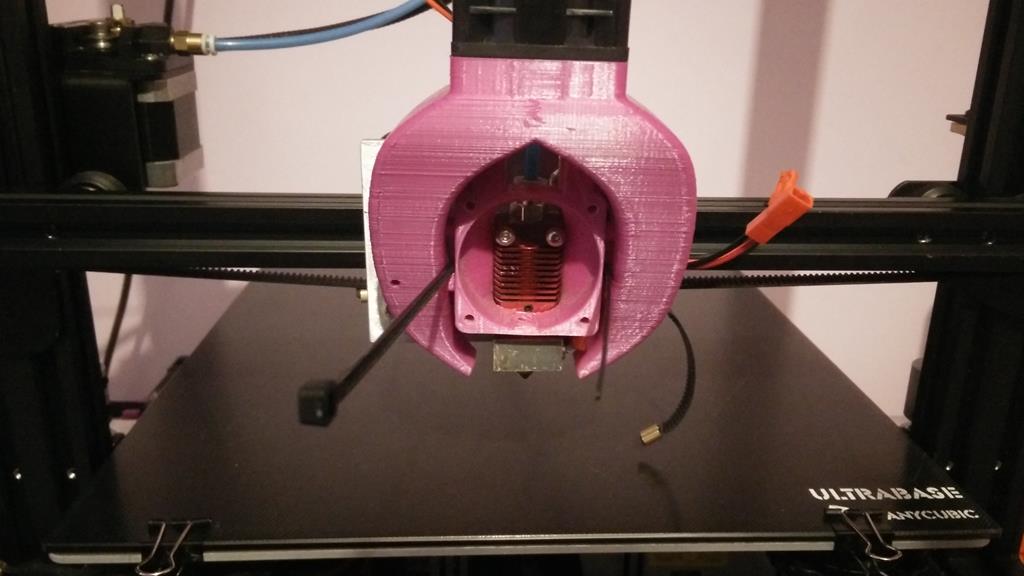

The X carriage broke again. Turns out its actually from the nozzle running over blobs of filament when its messed up a bridge etc. The hard plastic simply pushes the nozzle out of the way, and the X carriage is the weak link so it breaks the studs off. This is my temporary repair from last time which has now worked loose again:

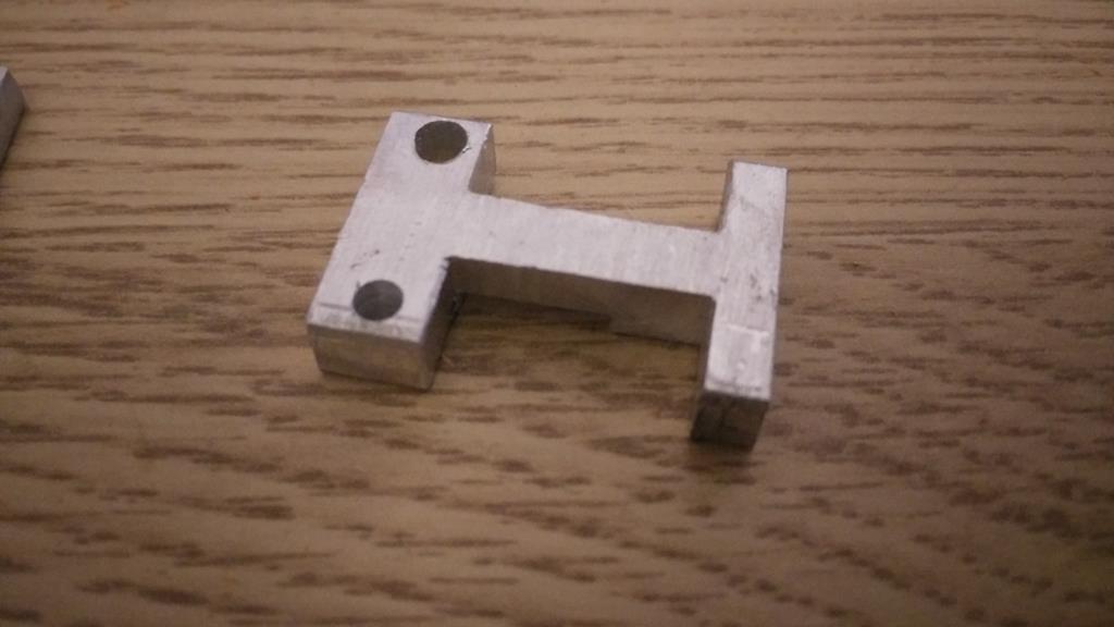

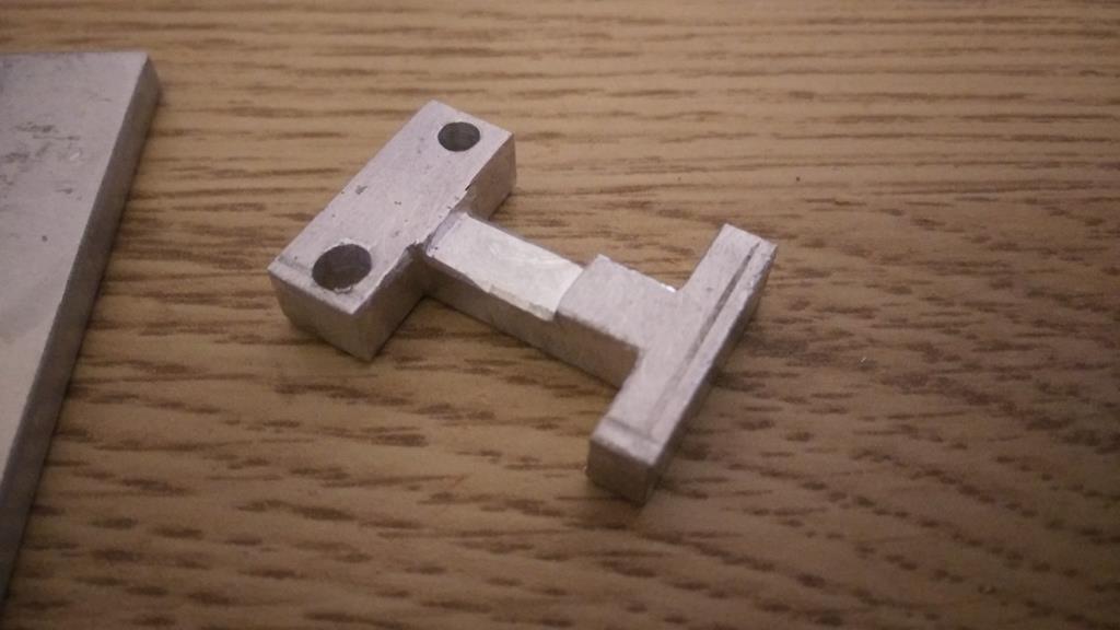

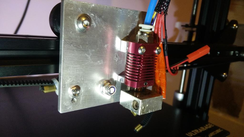

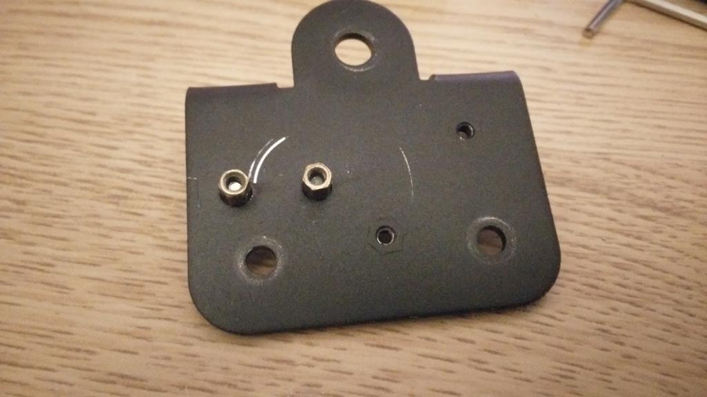

Enough of that. I made a new piece from 4mm aircraft-grade 7075 aluminium plate:
I also made a support bracket / spacer thingy which spaces the hotend off the plate and supports its base. The groove is for a cable tie. I made this in the mill.
Installed
This is so much more stable than the original! The belt is cable tied to a bolt for now. Not ideal, but it got the printer running again.

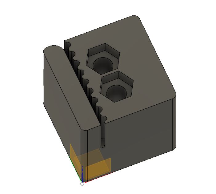

I'm currently printing this to hold the belt properly:

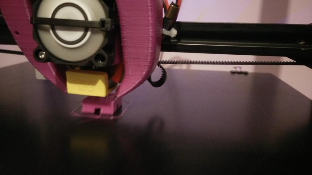

The part cooling fang is held on with a cable tie. I was going to do something fancy bolting the fan right through in to the X carriage, but actually it doesn't need it. The cable tie holds it all still just fine. I might tidy it up in the future when I'm at a loose end...

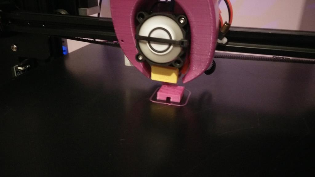

Printing again! Much better quality than it has been doing for a while too.

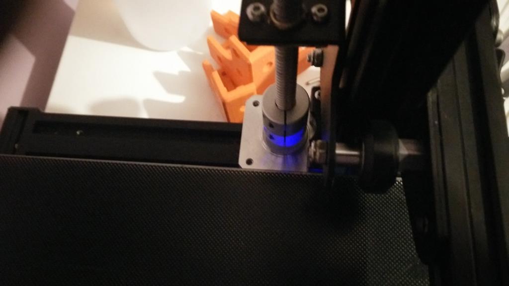

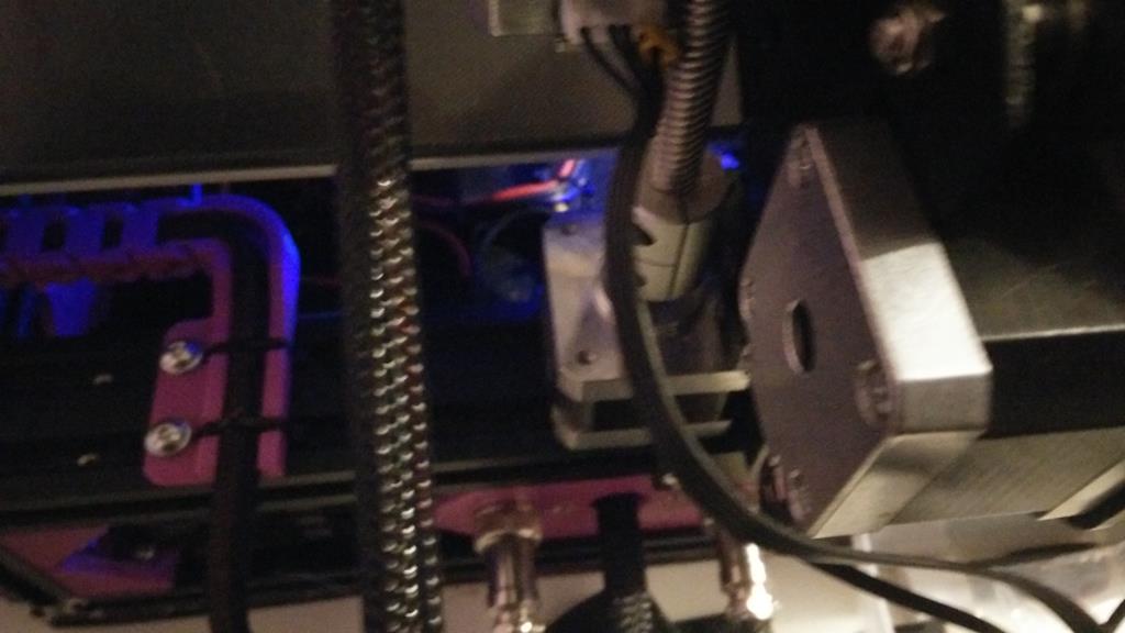

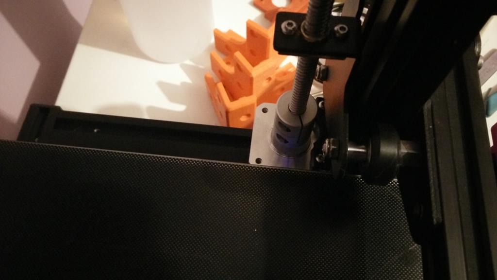

I also had a cunning plan to solve the Z height misalignment issue I've been having. I homed the Z axis and straightened the Z couplers up so the slot is parallel with X. This took about an hour to get right! But, once I had both couplers parallel and the X carriage perfectly level with the frame I levelled the bed and did a test print.
The couplers were set like this before printing:
Re-homing after a print the right hand coupler ended up like this:
All I have to do now is home the printer before a print and then manually straighten the right hand Z coupler, then I know its in the right place and I can start the print

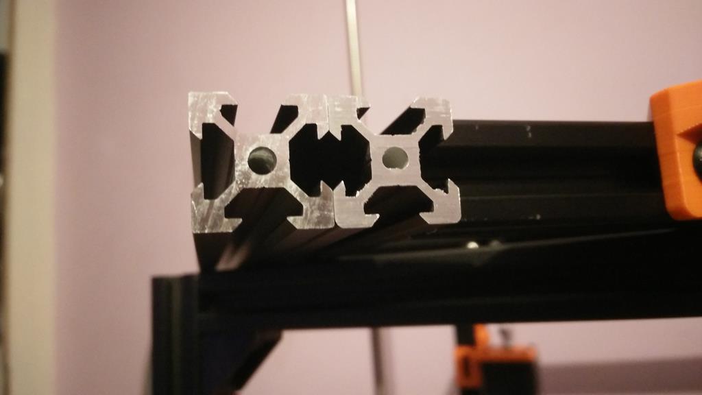

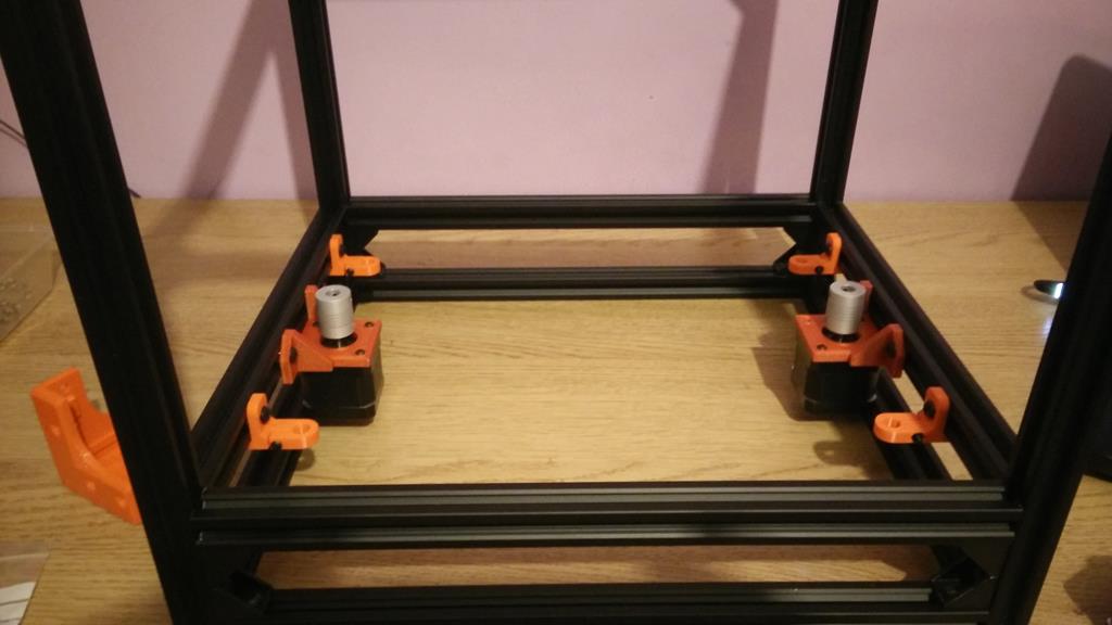

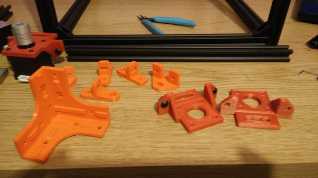

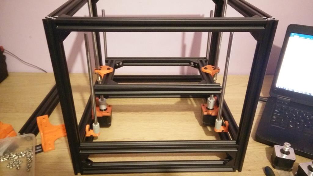

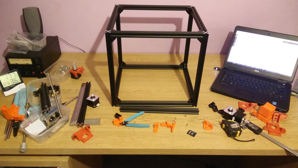

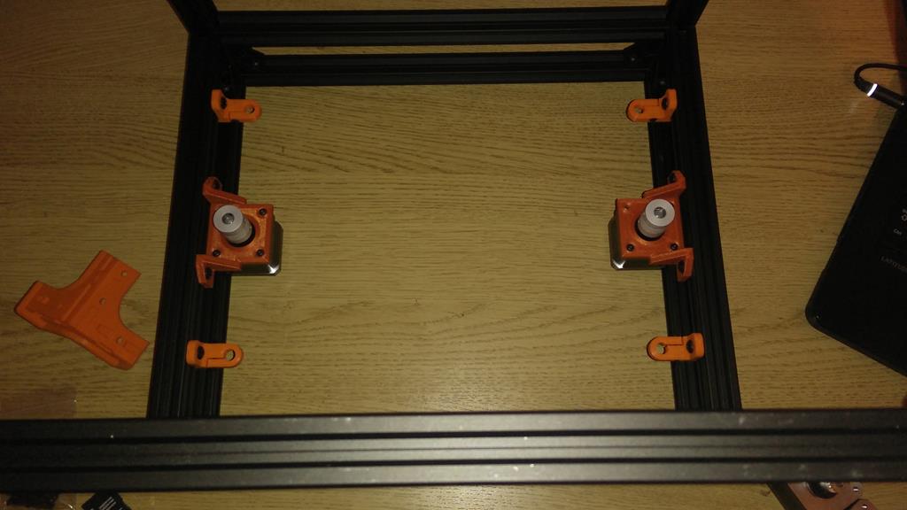

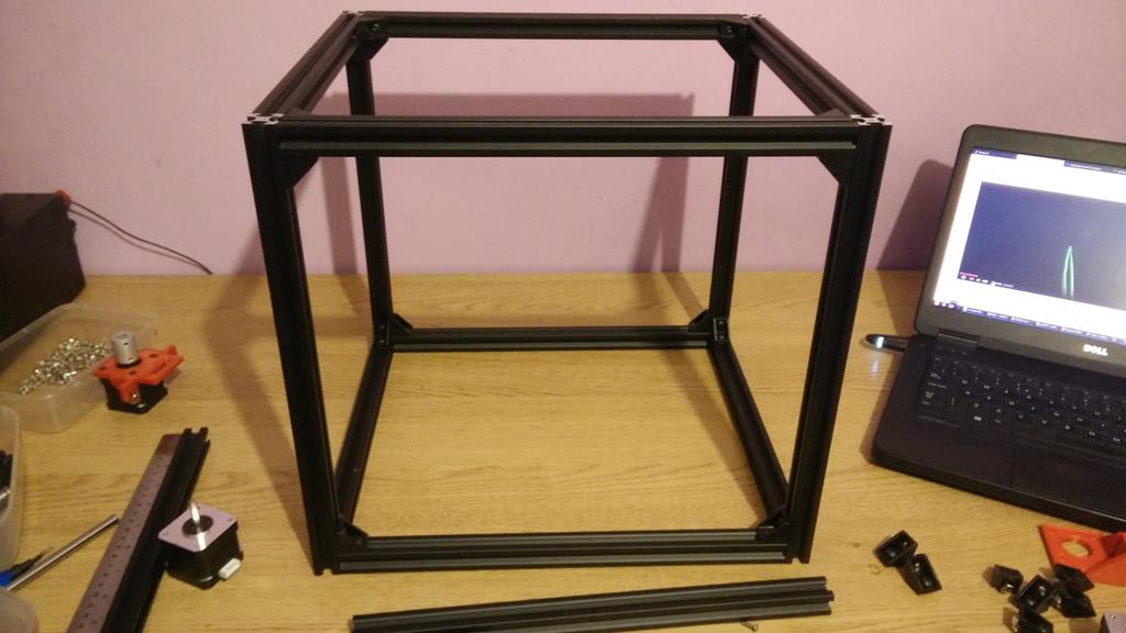

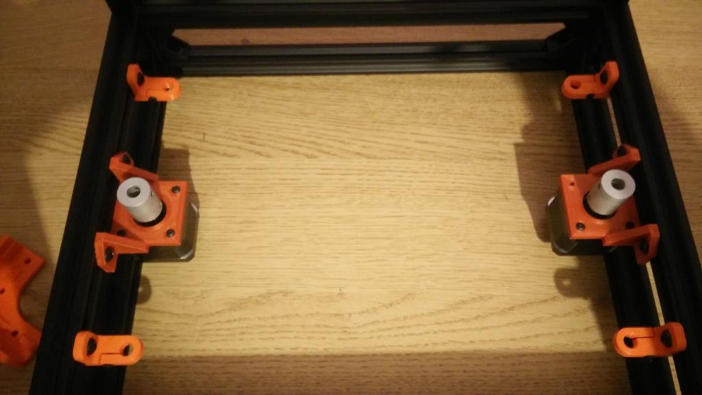

Hypercube pic dump. I'm doing dual Z screws and four Z rods so its actually a mini Hevo! I'm using the original Hypercube as inspiration, but pretty much making it up as I go along Print something, don't like it, design a new one, print that, bolt it together
Difference in quality between Ooznest (left) and Ratrig (right)

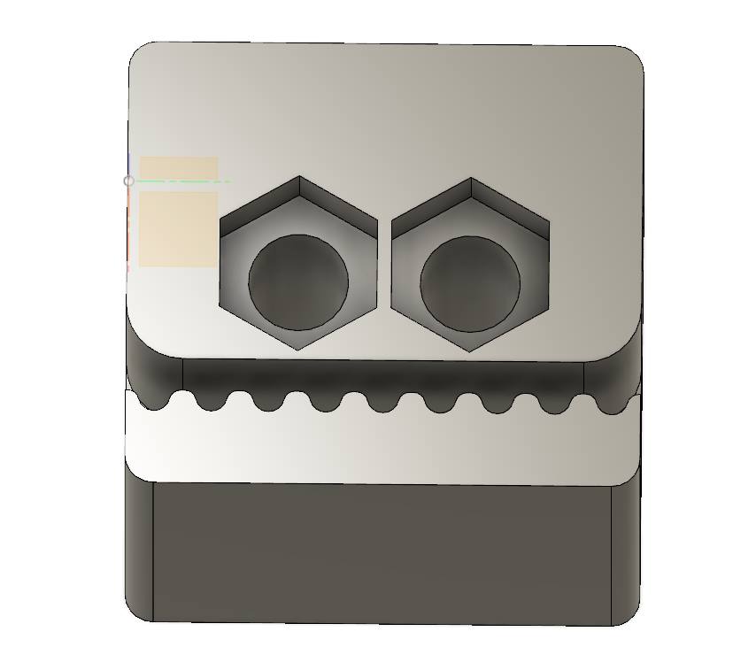

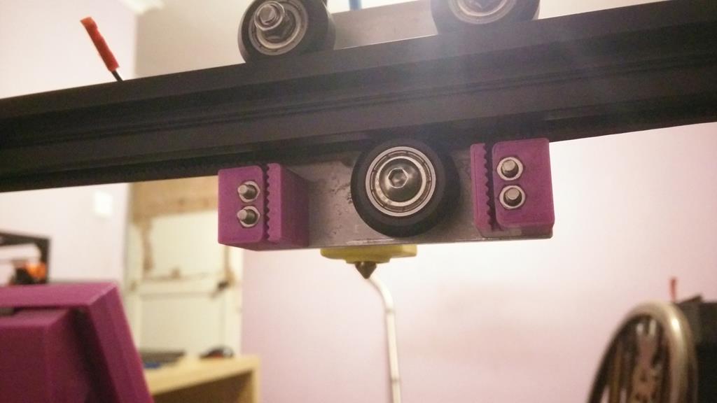

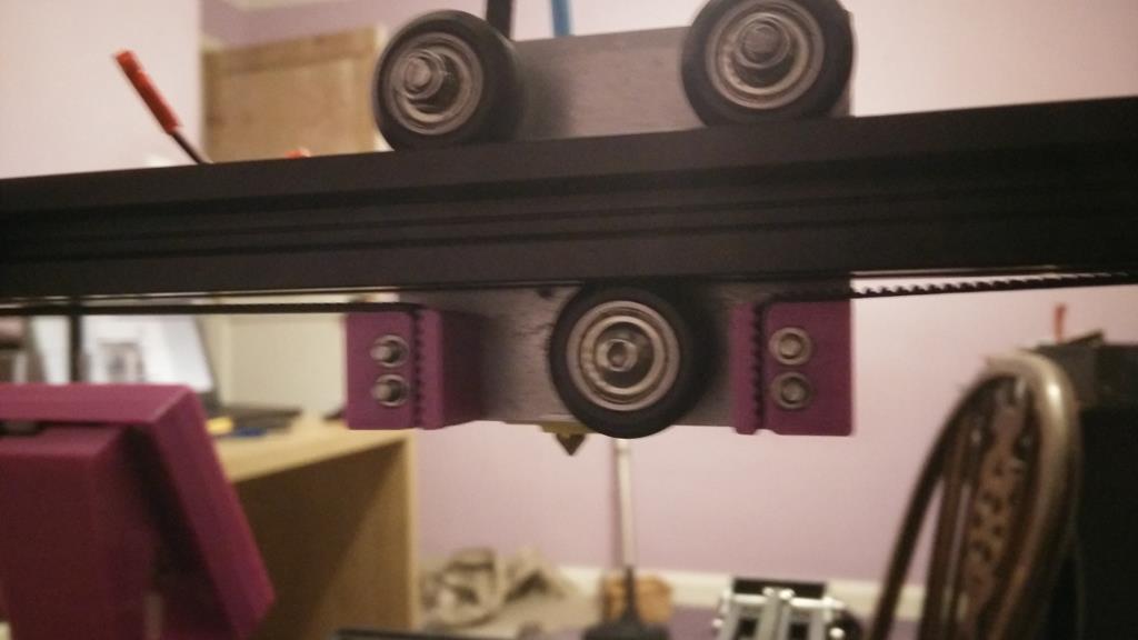

Finished the belt clamps.
Angry robot
Out of focus as usual but you get the idea. These hold the belt very firmly and the movement is nice and smooth. Better in fact than when it was new
