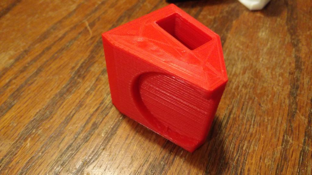

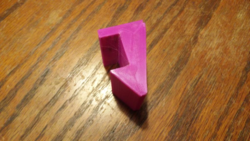

I then set about printing a few upgrades for the printer. I love that it can make its own parts! This filament was supposedly aubergine. It turns out more like pink, but it makes a pleasing contrast to the black anodised aluminium so I don't mind.
I then printed an army of calibration cats while dialling in the settings on the machine

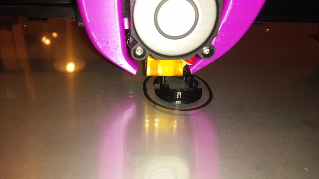

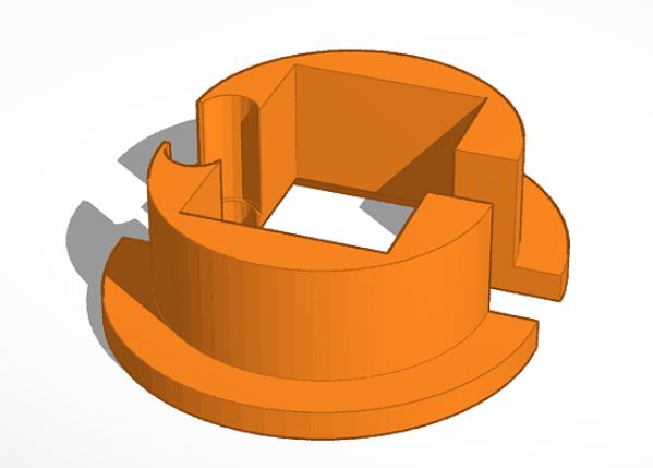

Once I'd got the printer working nicely I had a go at making something useful. I made this design in Tinkercad which is a free online 3D cad program.
Laying the design down
Done

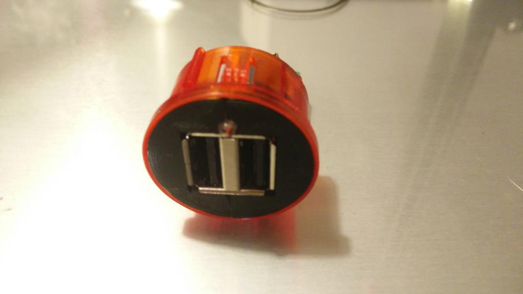

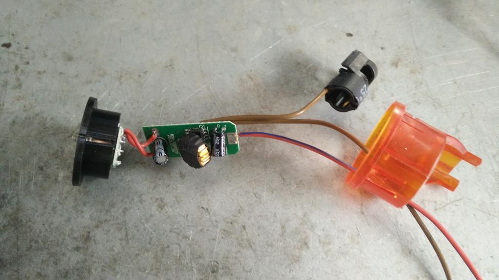

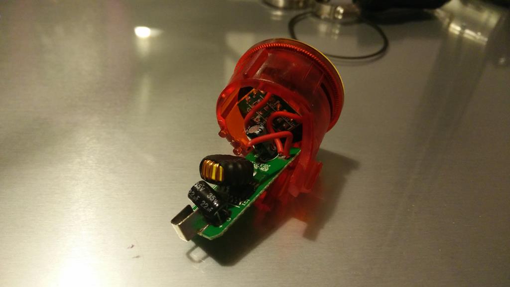

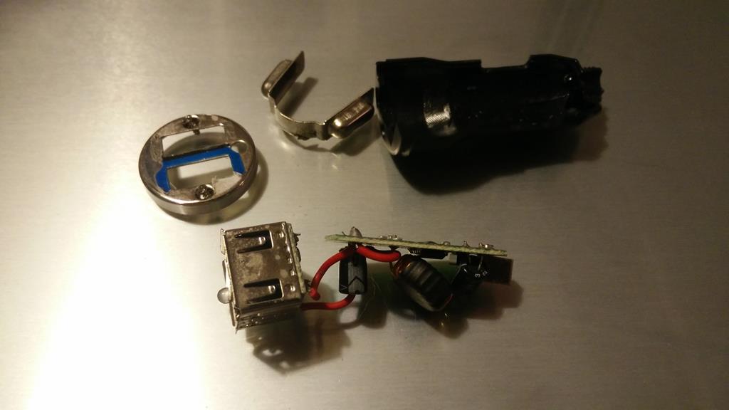

Took apart a USB cig lighter charger

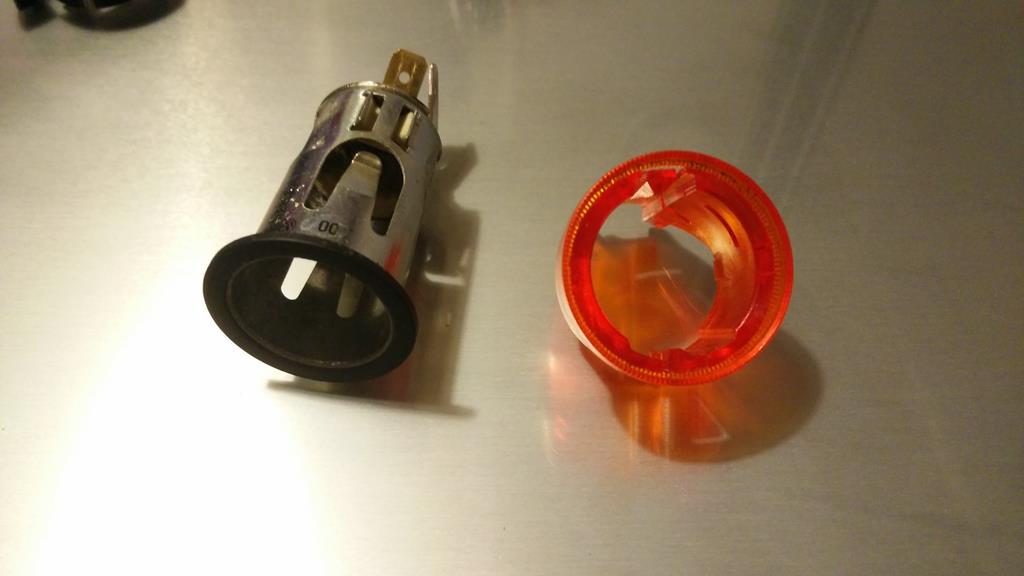

Took apart the D2 cig lighter
Mounted the USB sockets in the printed parts and then mounted that assembly in the cig lighter surround
USB charging points instead of a cig lighter

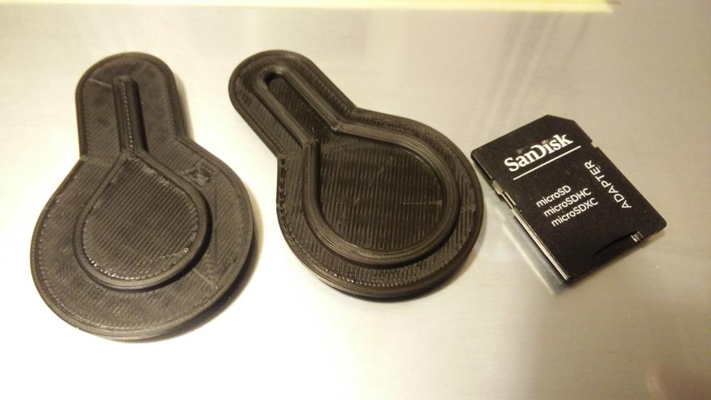

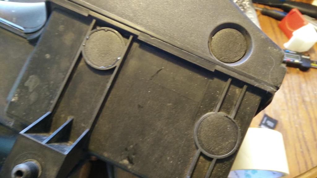

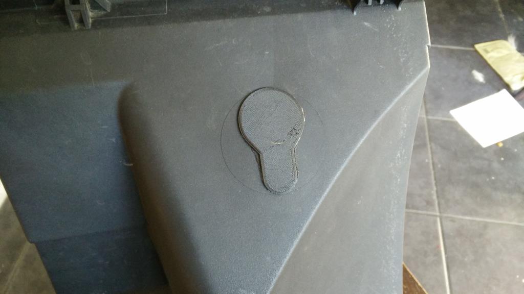

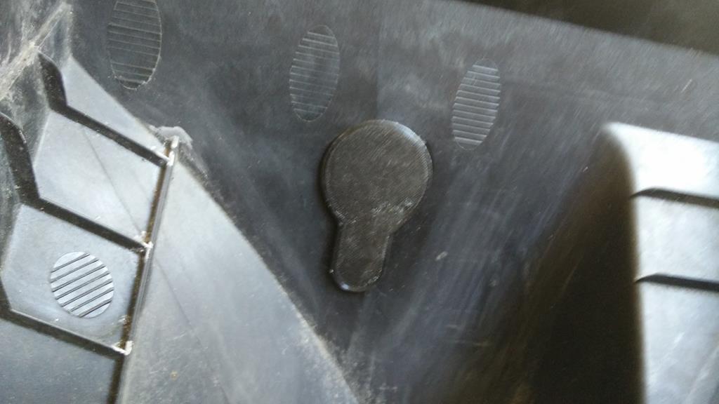

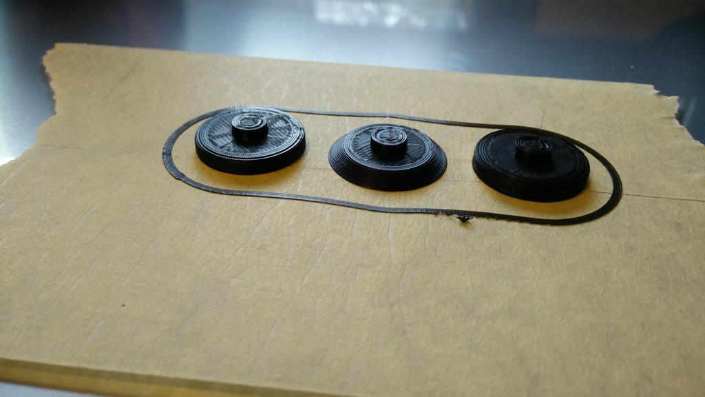

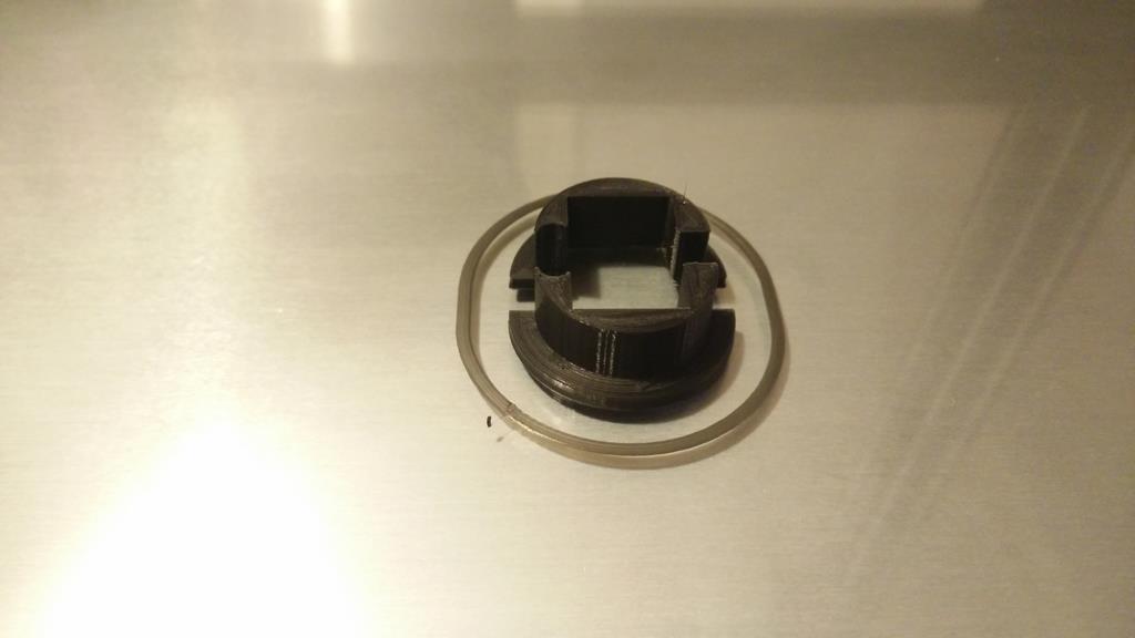

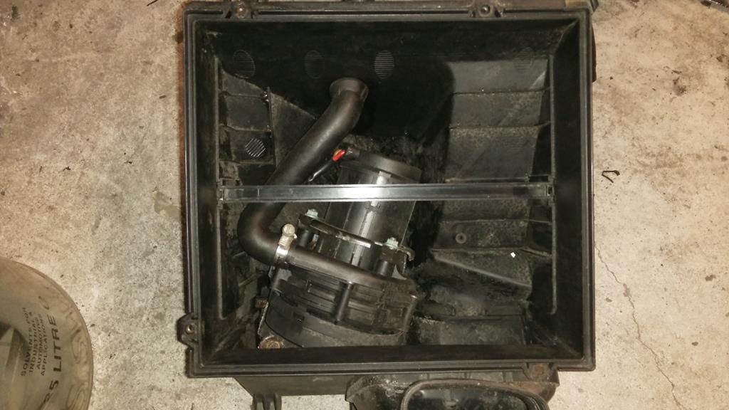

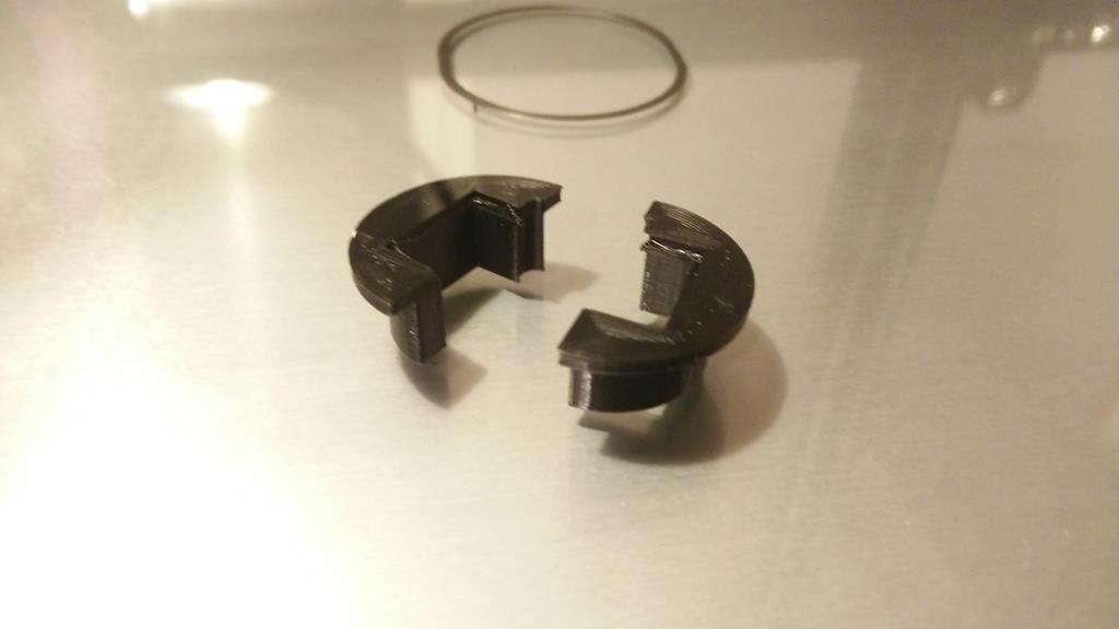

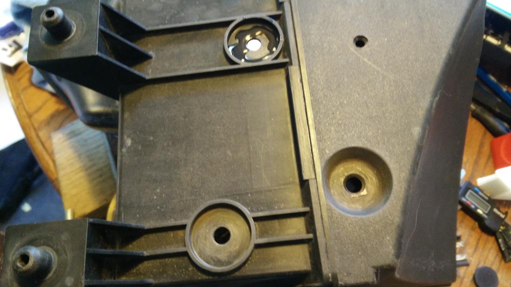

Made some parts to fill in the holes in the air box after removing the secondary air pump.
These two pieces snap together to fill in the hole from the air hose and electrical connector.
and these plugs fill in the bolt holes
A bit of adhesive for extra security
Fitted in place

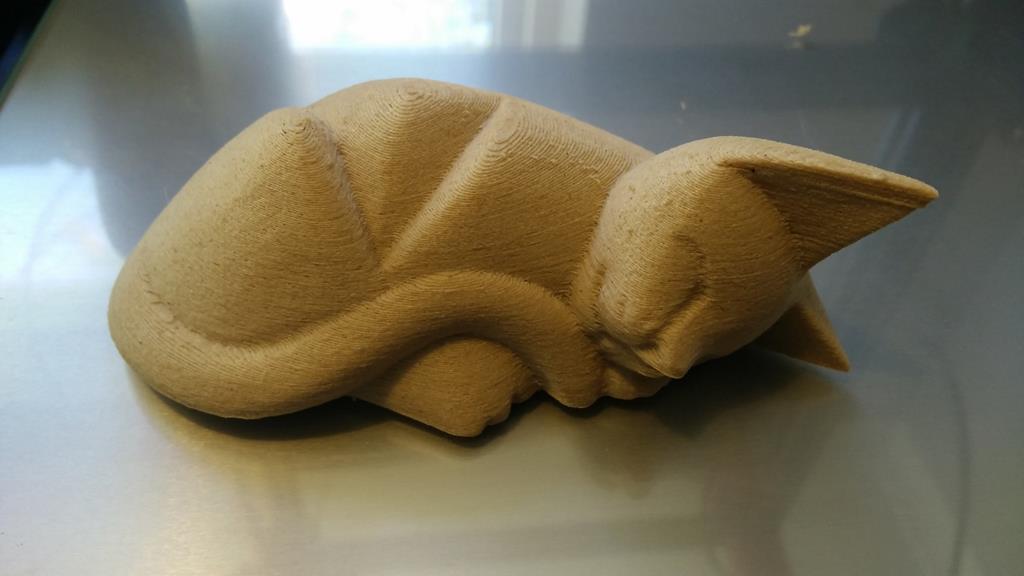

The Carbon stuff is very very cool indeed. I was using resin stereolithography 25 years ago to make prototypes of injection moulded parts. They were brittle and fragile, and took many days to make anything useful. No one had even thought of the term '3D printing' at the time. Now you can make production parts using essentially the same technique.
Thanks to open source software to drive them, the technology has evolved to the point where a desktop FDM printer is <£200 (mine was £350) and can make entirely usable things of remarkable quality. I printed this from wood - essentially MDF filament:
It is totally engrossing too. I can sit there watching it make things, listening to the stepper motors singing, for far longer than necessary!

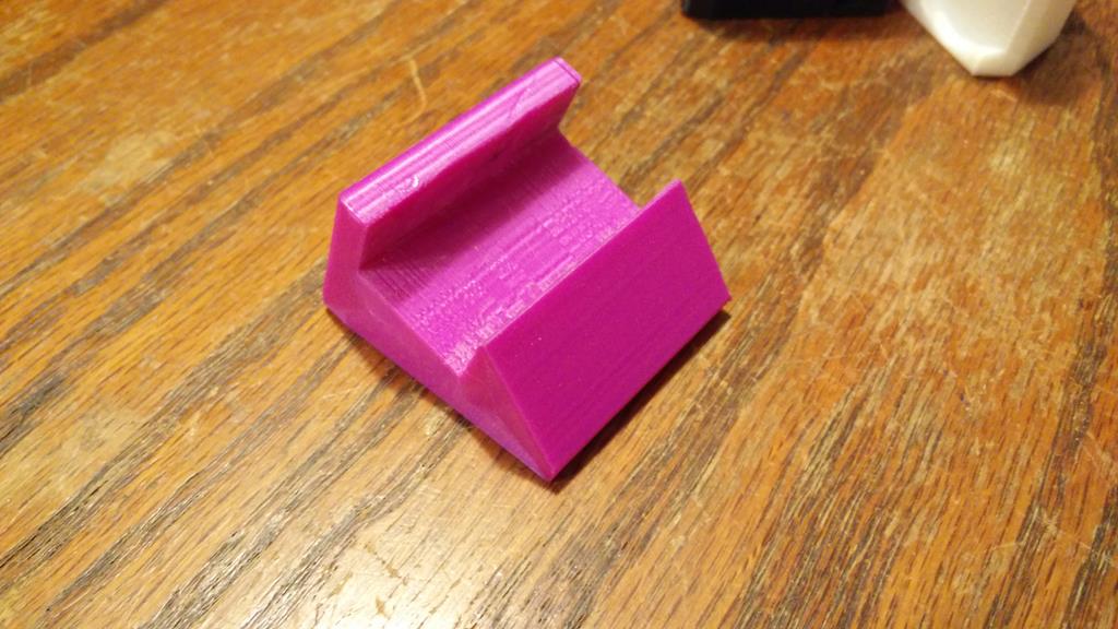

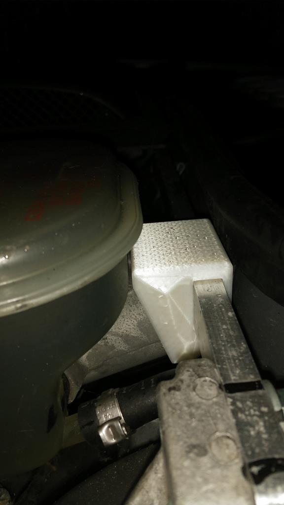

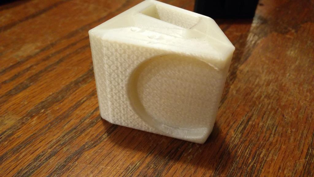

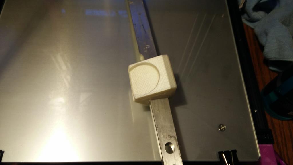

Ok the brake master cylinder brace that a few of you guys have been waiting for
I had noticed when working on the manual swap that the brake fluid reservoir moved around an alarming amount when I stood on the brake pedal. It seems from the 'brake block' thread that I wasn't the only one, but there's nothing on the market for this any more so I decided to make my own.
Vid of the unsupported master cylinder here

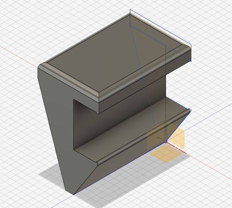

Started off with a cad model in Fusion 360:
Printed it in the aubergine filament
Installed:
I took a video of this one installed and it didn't actually do much because the whole assembly is mostly rotating around the top bulkhead where the pedal box is mounted rather than pushing forwards. This brace stopped it moving forwards, but didn't prevent the master cylinder lifting up. So, a few modifications to the model resulted in this:
Printed one in some cheap red PLA
Tolerances weren't good on this so I tweaked the dimensions slightly and printed in some better material
This one works pretty well as you can see here
