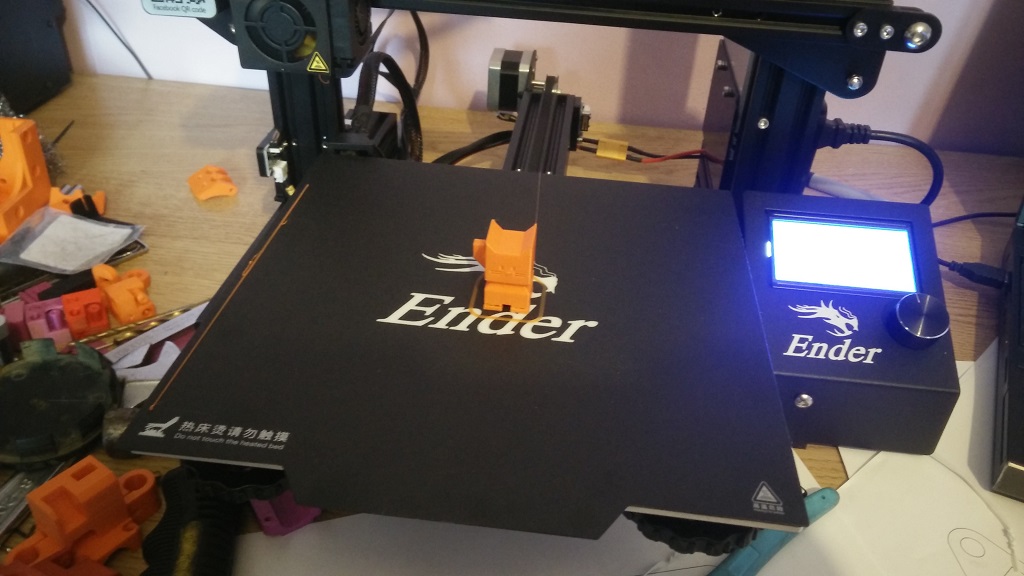

So, I'm printing again...
Yes, I bought a new one This is a Creality Ender 3 Pro. I debated buying another CR-10S, maybe even a CR-10S Pro or a CR-X, but settled on this for several reasons:
1, It was <£200
2, It has a removable magnetic build sheet - this rocks!
3, It heats up *much* faster than the CR-10S
4, It only has one Z screw, which was my biggest problem with the CR-10S
5, Its quite small so easier to put in a box than the CR-10S so it can print ABS
Its also quieter than the CR-10S for some reason. It has slightly smaller motors since it has a smaller bed, but they are much quieter. The fans are still crazy loud though so I will swap those at some point.
Its amazing just how fast the bed heats up. It can go from room temperature to 80 degrees in the time it takes to manually unload and reload the filament. No 'change filament' in the menu with this btw, or indeed bed levelling, which is a bit bizarre. Bed levelling is totally manual, but it seems to stay put more than the CR-10S does.
Its also much happier printing at 60mm/s than the CR-10S, partly because the bed is smaller, but also because its much lighter as it doesn't have any glass. Just the heated plate plus the magnetic sheet. The magnetic sheet isn't flat, but it doesn't seem to matter.
The magnetic build sheet is excellent btw. It gives a nice matte finish to the prints, and so far everything sticks to it perfectly. I've printed PLA, ABS, ASA, CPE and PETG and its knocked every one out of the park. Better prints at the same settings as the CR-10S, and they pop off the magnetic sheet when it's bent.
I think tbh I just wore put the CR-10S by printing so much Its time therefore for a fairly comprehensive rebuild of that machine. I'll likely convert it to a direct extruder (probably an E3D Titan) since the hotend is one of its biggest issues. It will also get converted to a single Z motor driving both lead screws (this was always the am of building the frame below it). It will definitely get a genuine Creality magnetic bed since I like that a lot. It may also get new electronics since it has never been the same since the firmware debacle, but I will wait and see how it behaves with the Titan first I think. It can print big things slowly, and the Ender can print small things quickly.
I'm continuing with the Hypercube again too, which is why I'm experimenting with different materials in the Ender. If I can get decent prints in ABS I will build the 'cube with that instead of messing around with PLA.
