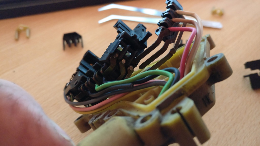

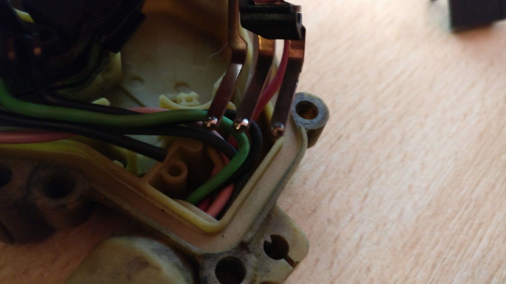

This is the problem - a burned contact in the F125:
This contact is slightly misaligned so was never making a proper connection with its counterpart and had burned a slight hole. I straightened it out and cleaned the surface up with 1000 grit paper, greased this and all the others with contact grease and reassembled it. Mike then helped me fit the repaired switch on Saturday and it now selects gears and drives round the yard just fine

Is that all you spend on drinks for Mike when he helps?
The more I hear about F125 switches, the more I think that every D2 gearbox issue needs the F125 looking at first!
Old 1st December 2019, 07:32 PM
I possibly should have clarified that the pound was spent on bolts to hold the F125 back together after I drilled the rivets out
If it goes in to limp the instant the shifter moves then its usually the F125, and will give a specific code to say so, normally accompanied by the same code in the ABS unit.
If it goes in to limp when it moves, or tries to move, its something internal - usually a clutch pack or hydraulic issue.
There are a few edge cases like when a contact came adrift in Neil's which caused no-start and other oddities, and water ingress like I had with General Vod which caused pretty much every TCU code imaginable! Mostly though its F125 or clutch packs.

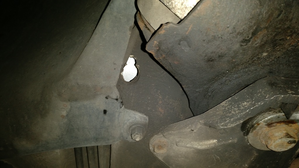

Lots of heinous bodging on this car unfortunately Can't get the control arm bolts out? Never mind - just drill a sodding great hole in the floorpan
Not surprising that the same muppet who did this failed to fix a duff F125 by fitting a second duff F125
Awesome, that's made my day. Didn't think to cut the blot instead of the CAR!

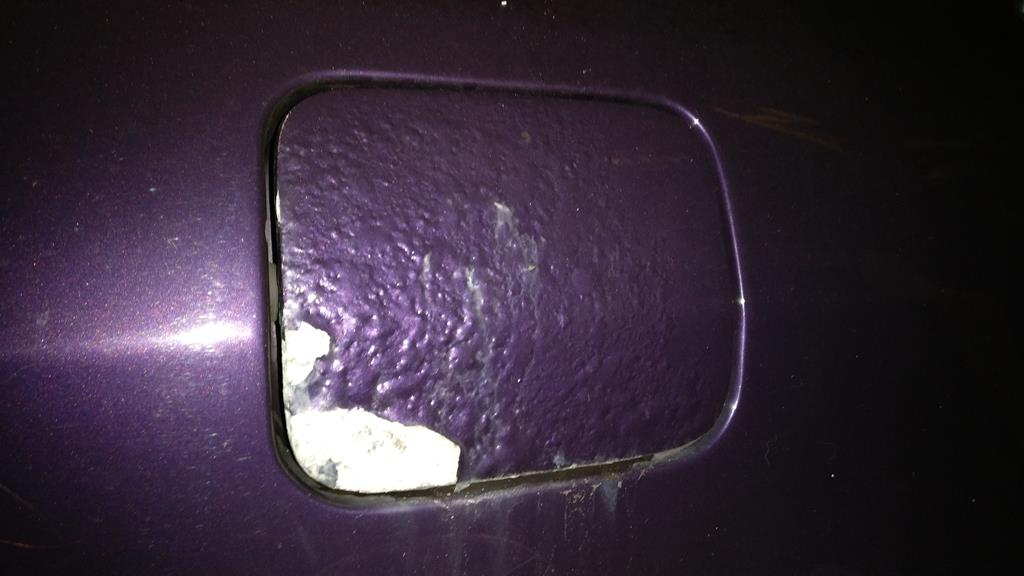

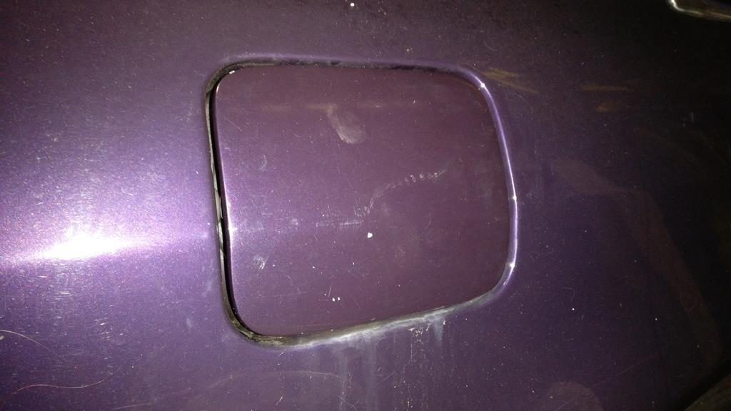

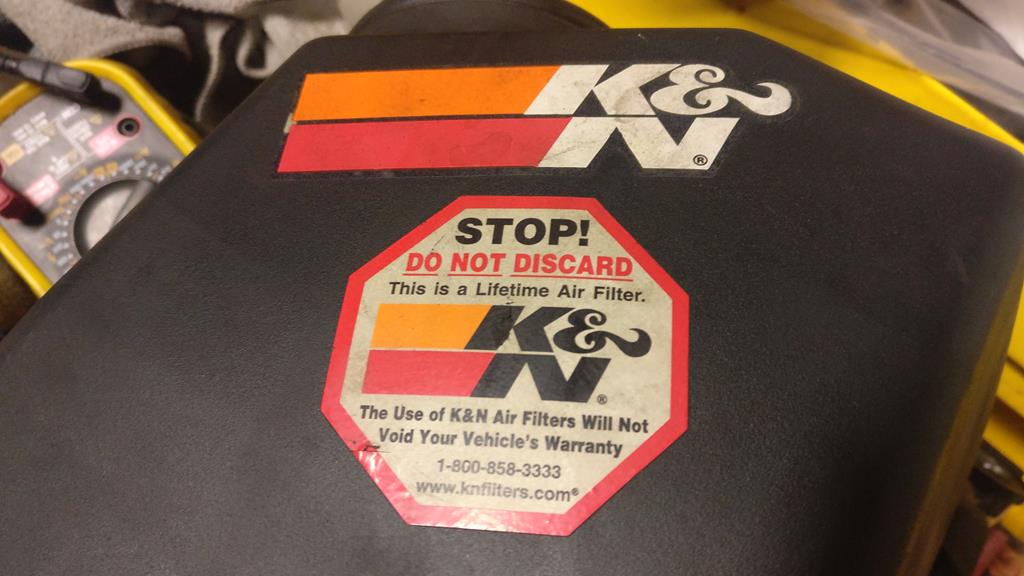

Quiet in here today so a small update on this. I swapped the fuel filler door for a good one from Prestige
Its a very slightly different shade as it's been painted, but its better than the original!

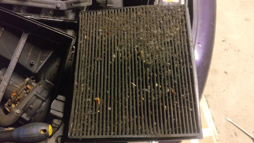

Doing some tinkering under the bonnet I discovered this:
Clearly 'lifetime air filter' translates to 'never look at the air filter again' according to most mechanics
Straight in the bin with that and a stock paper filter fitted instead.
