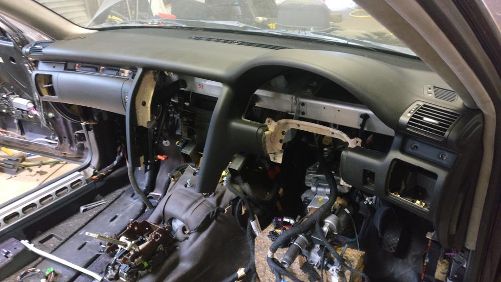

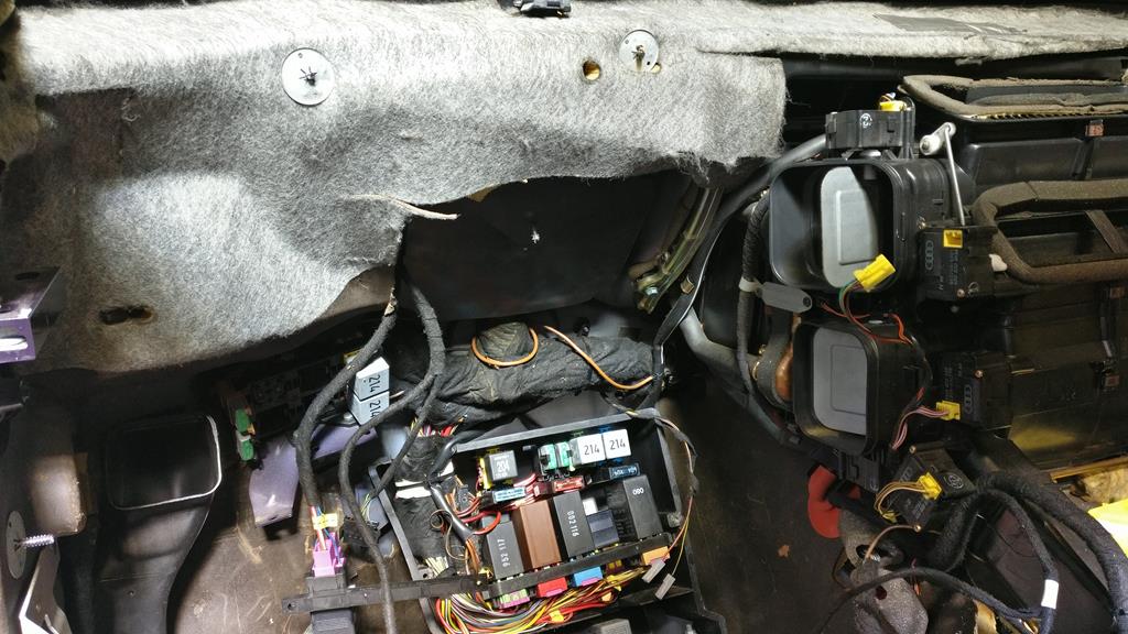

It looks like there is 4 servos here in this picture and guessing there is 4 on the other side. Is there any more of these hiding elsewhere under the dash?
Five in that picture - one at the very bottom under the vent. I think there are four on the other side though as the rear vent only has a single servo doing both sides together. So 9 inside. There are then two more outside - one for the air inlet and one for the recirc so I think 11 in total.

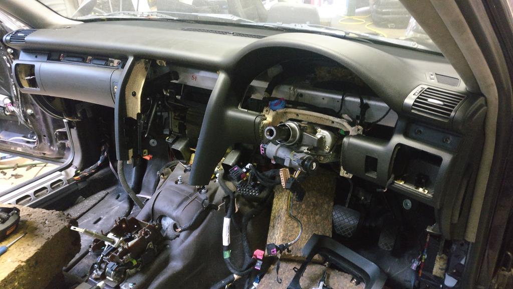

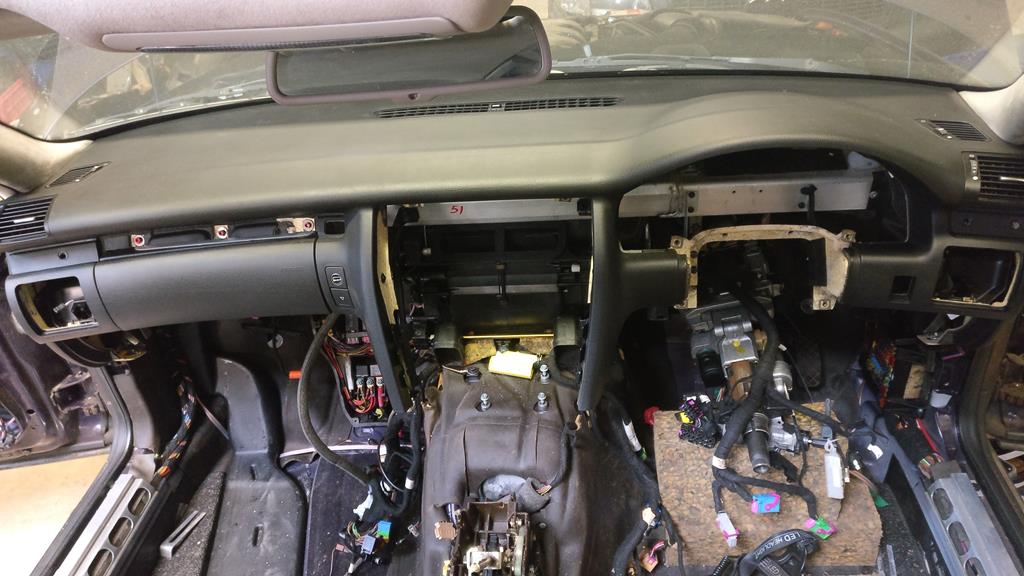

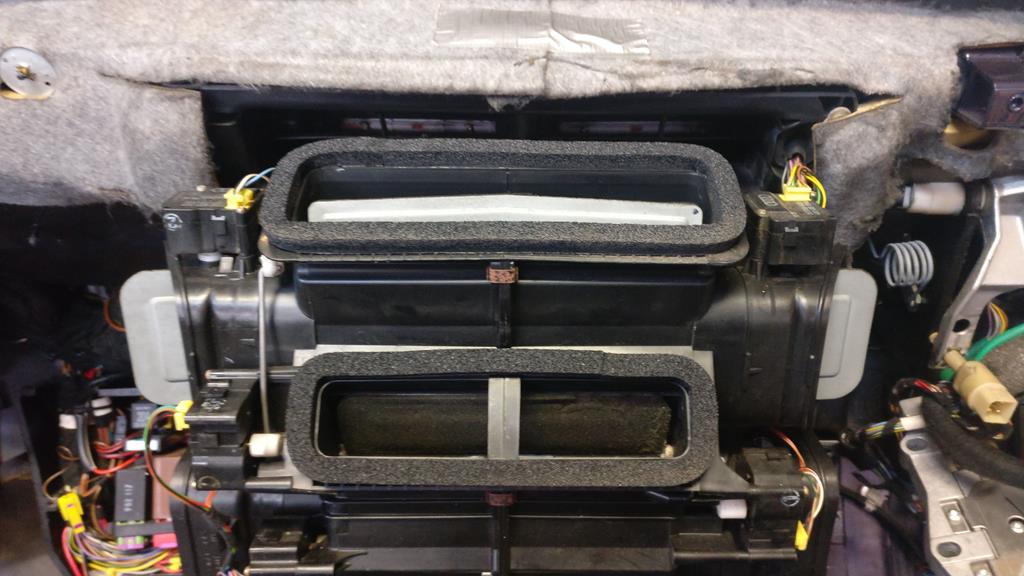

Probably the coolant valve is stuck open on one side. My grey S8 always blows hot on one side regardless of settings because the valve won't close. Replacing that valve block with something modern is on the list for this year
Replaced the foam round the HVAC joints
With that done, and the windscreen cleaned, I could think of no more reasons not to put the dash back in
Its crazy how heavy this thing is. Its something of an ordeal doing it single-handed without breaking anything!
There is only one connector for the dash which does the vent illumination and the sunlight sensor. It plugs in just at the base of the right hand A-pillar
Fitted the radio clock module
Steering column reattached
I called it a day here as I needed to tidy some wiring which I missed earlier.
The wood trim is out still because I can't decide on Maple or Myrtle. I like Myrtle very much, but I might need to keep my good set for the other FE interior I have in storage so I might use the original Maple from my grey S8.

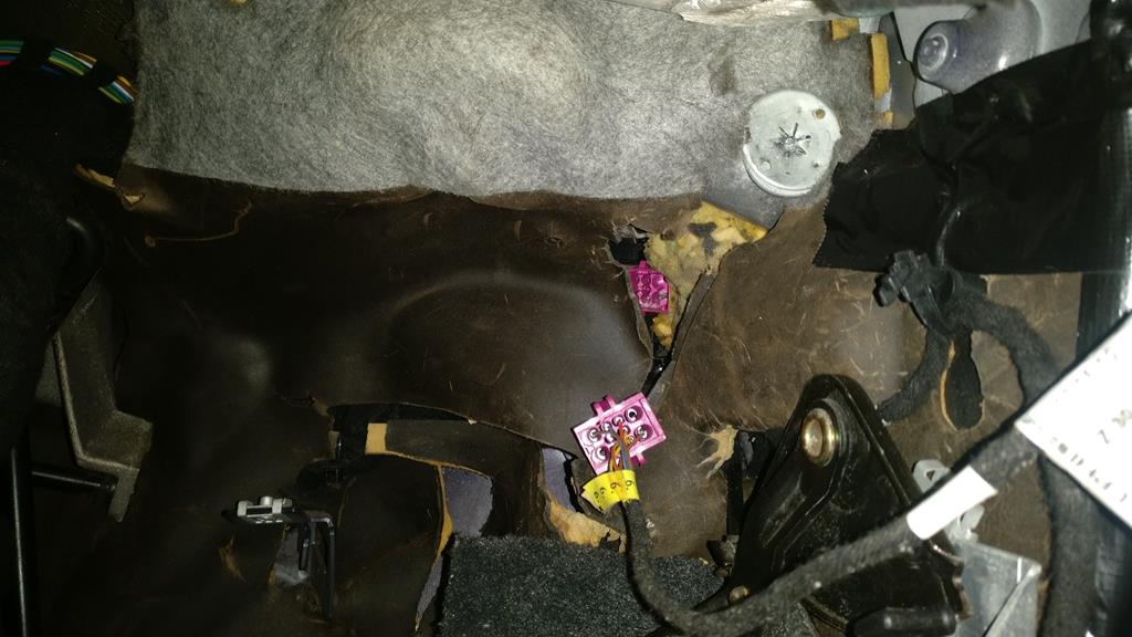

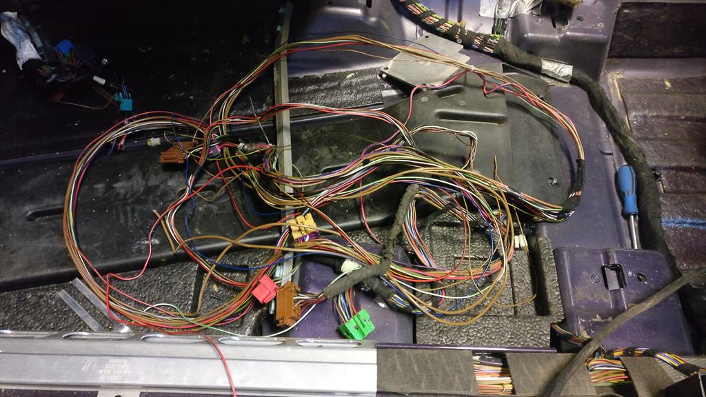

  #48
Old 6th May 2020, 04:42 PM
Obviously it was at this point I remembered the last thing I had to do before putting the dashboard back in
Fit all this lot for passenger seat memory:
Its possible with the dash in of course, but considerably less easy to do

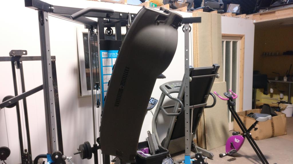

I hung the old dash off the multi-gym to weigh it
I guessed 20Kg - its actually 19.5 so close enough. Crazy for what it is. The airbag is a significant proportion of that, and the rebar is quite a big chunk of aluminium, then covered in a shell of vinyl and moulded polurethane foam. Not much lightness to add to this unless you also ditch passenger safety.

  #49
Old 6th May 2020, 05:17 PM
I did wonder when you said this "What about the front passenger airbag" and as you have just mentioned it, how is it connected?
  #50
Old 6th May 2020, 05:20 PM
That has a separate connector just above the glovebox
