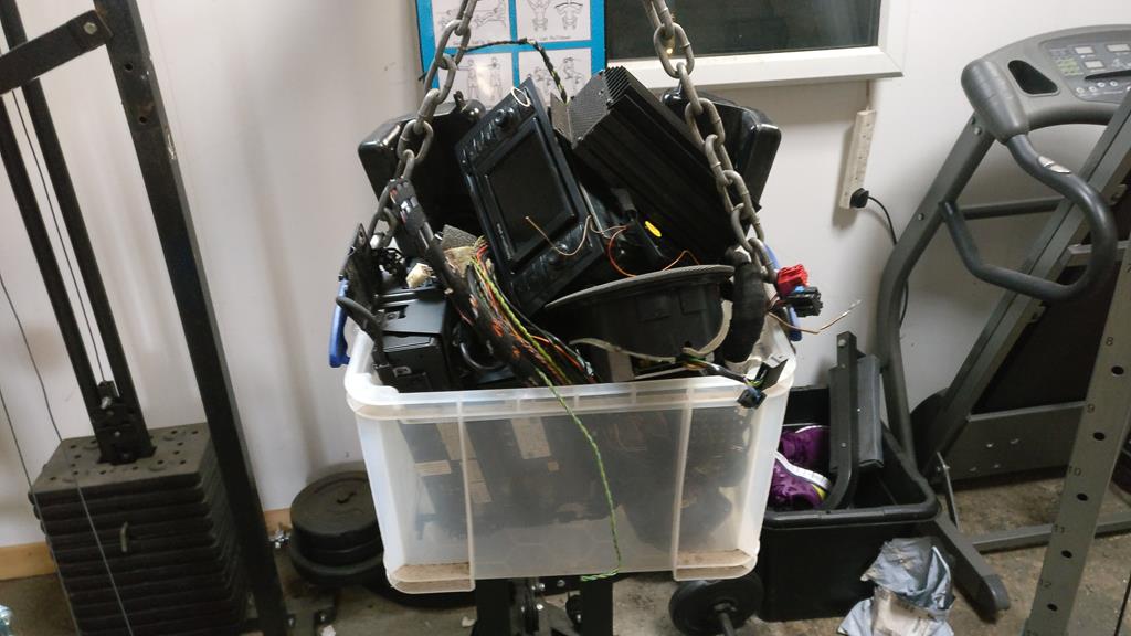

Since I have removed all the original AV stuff I thought I'd weigh it out of interest - 18Kg including a Bose amp.
Curious to see the weight of what I put back in. This is going to be a mid-budget SQ system, rather than a window-rattler so no huge subs or amps.
