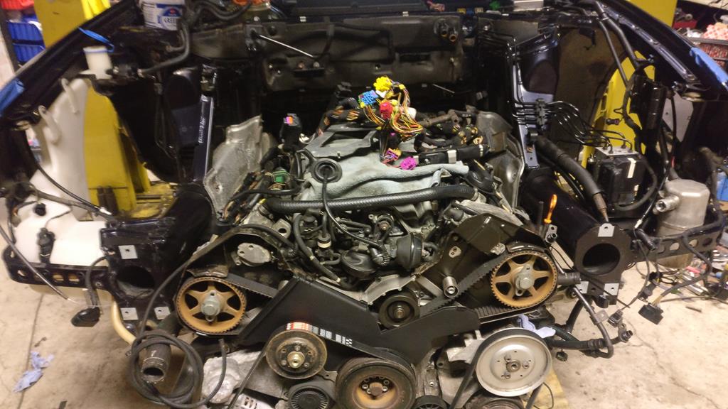

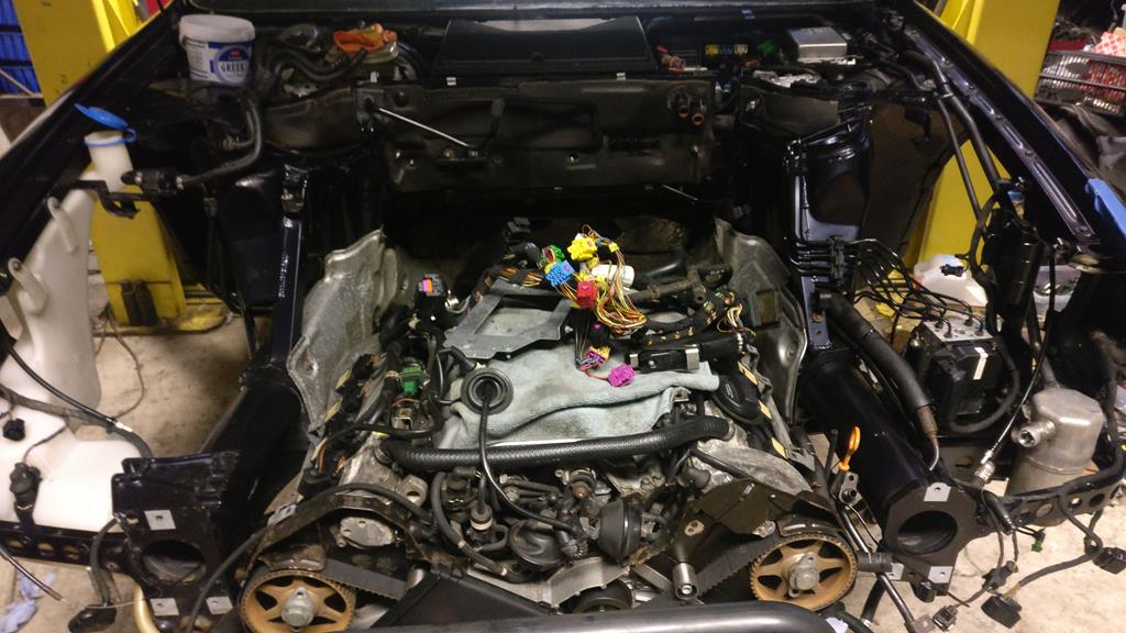

It joins the vac system here, but this the 40V. The 32V vac system is different though.
Cobwebs everywhere under the bonnet!
Nibbled! I don't have a spare one of these at the moment
So I painted it At least it doesn't draw the eye now. I'll replace it next visit
Yay new parts at last! Just cabin filters, but at least its progress.
Engine bay all cleaned up

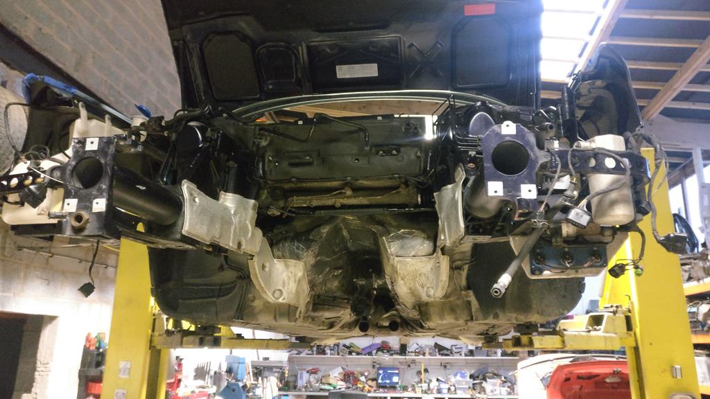

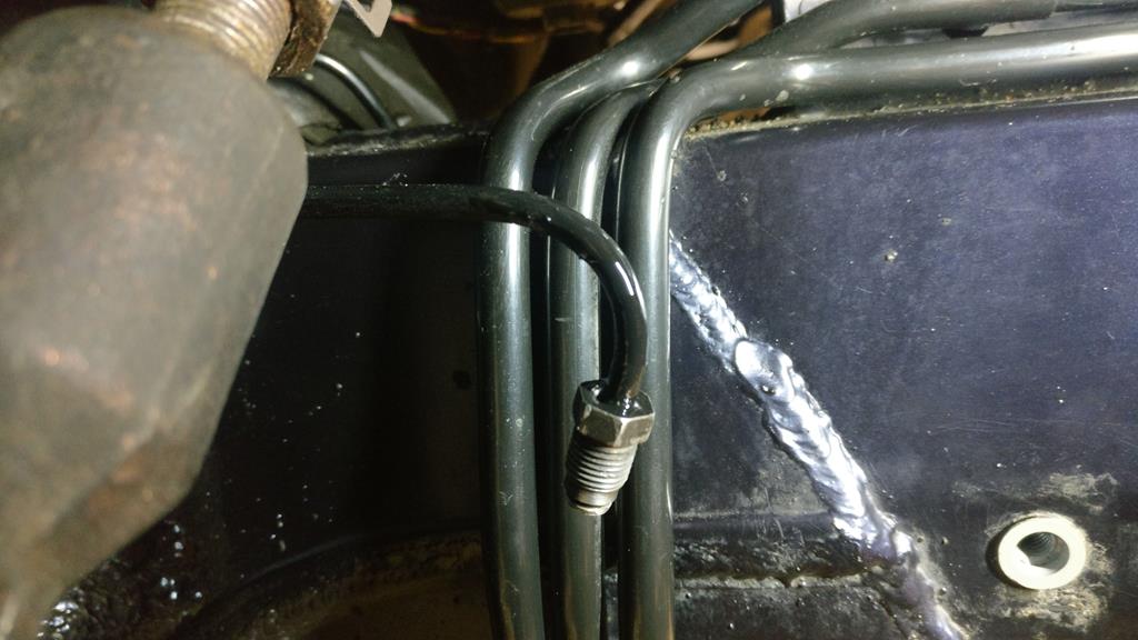

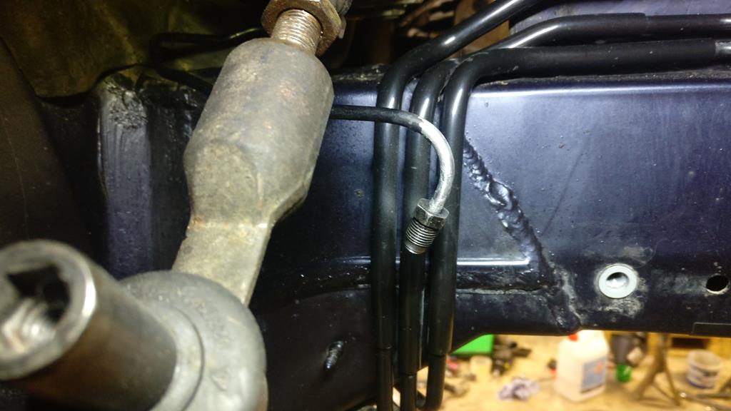

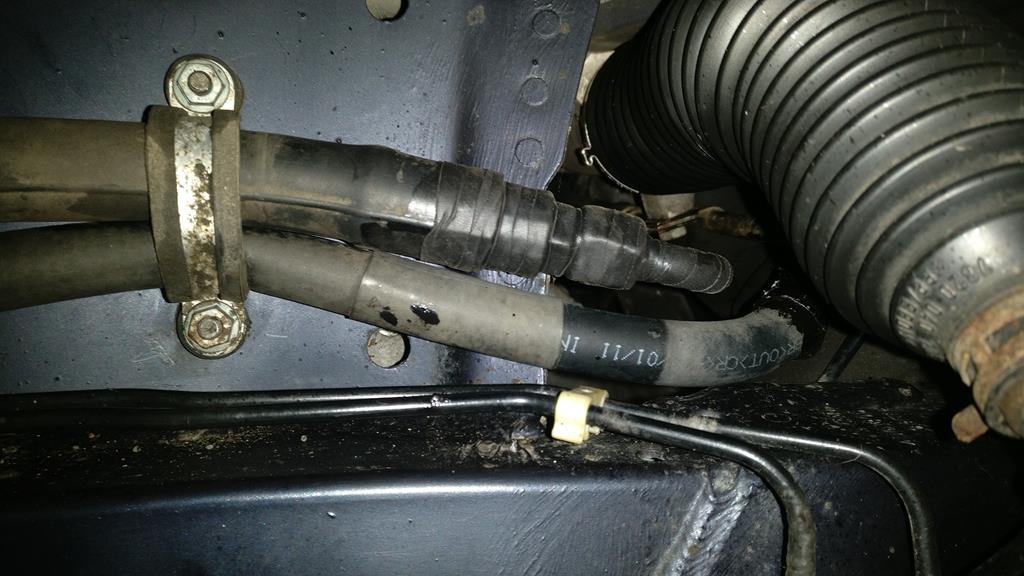

Power steering pipes back on. After removing the rust I painted the fittings with Rustoleum and then wrapped the pressure hose union with self-amalgamating tape.
One of the brake pipes was rather crusty so I cleaned it up with scotchbrite
and re-painted it

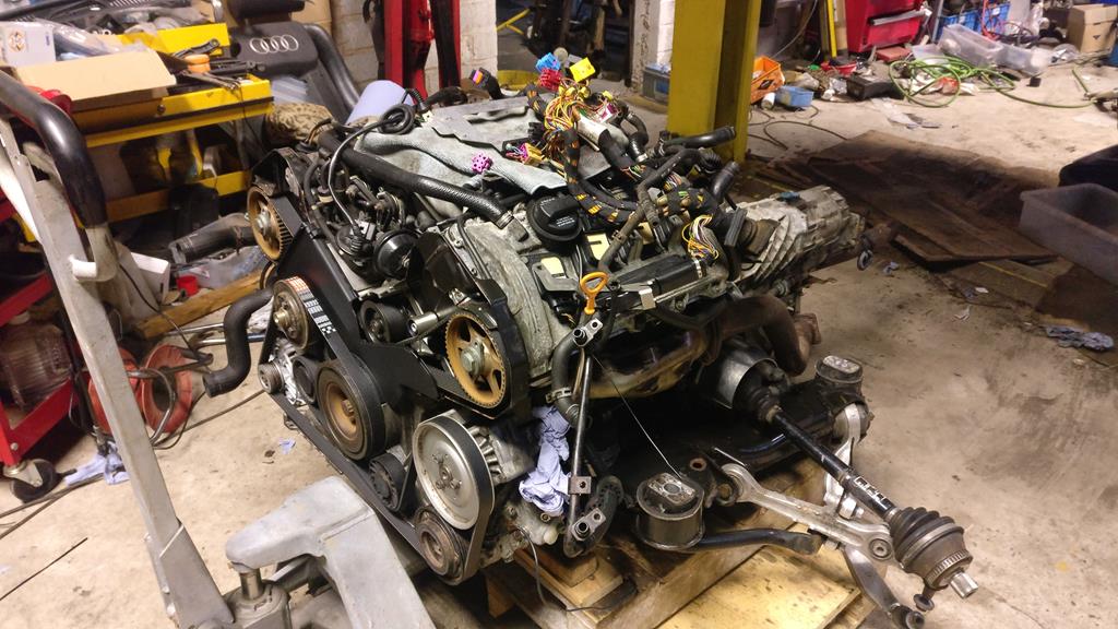

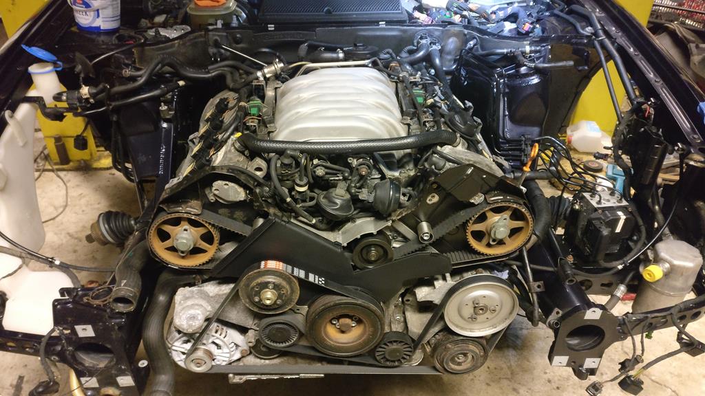

At this point I had run out of reasons not to put this
back in here...
so in it went
Hopefully I can fire it up tomorrow after an electrical systems check, adjusting the shifter and making sure the F125 is behaving, but I also have to drill some broken bolts out of the radiator which may thwart that plan.
