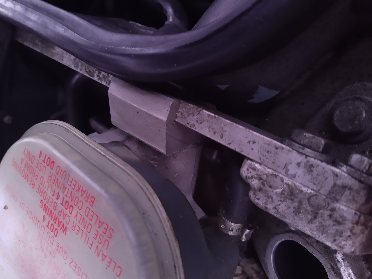

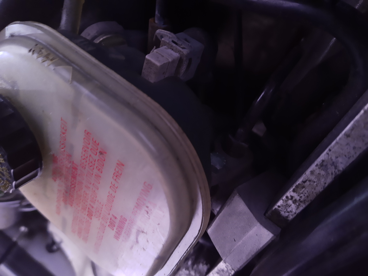

I've just taken some photos of the waterjet-cut solid aluminium brake block in place. It hasn't moved by even a millimetre! I thoroughly recommend this coveted MJ upgrade - in my opinion, the A8s should have come out from the factory like this - braking and feel is much improved.

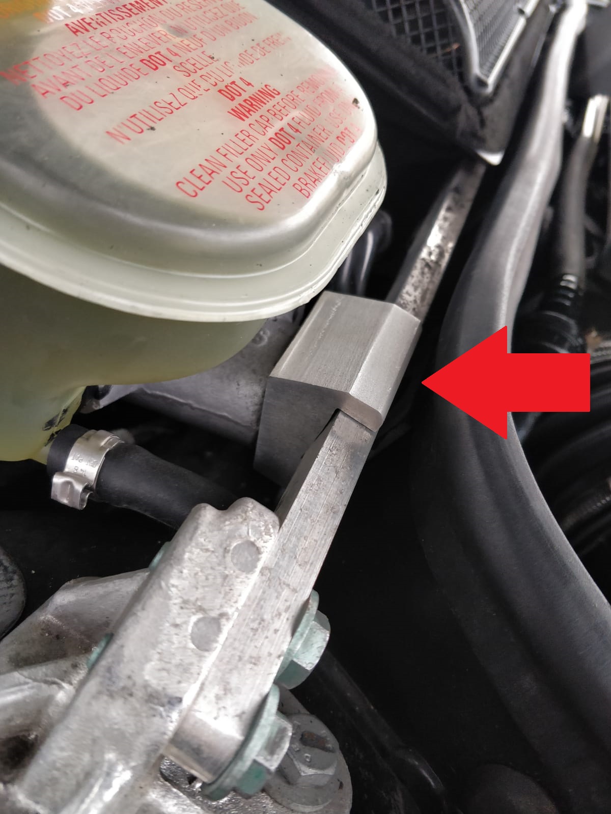

I just installed mine, I've only driven the car about 700 miles since getting it (so havent got a proper feel for it yet) but I can already tell the 'slack' in the pedal has been greatly reduced to almost nothing. Also the fit and finish matches the rest of the car tbh. good job Mikki!

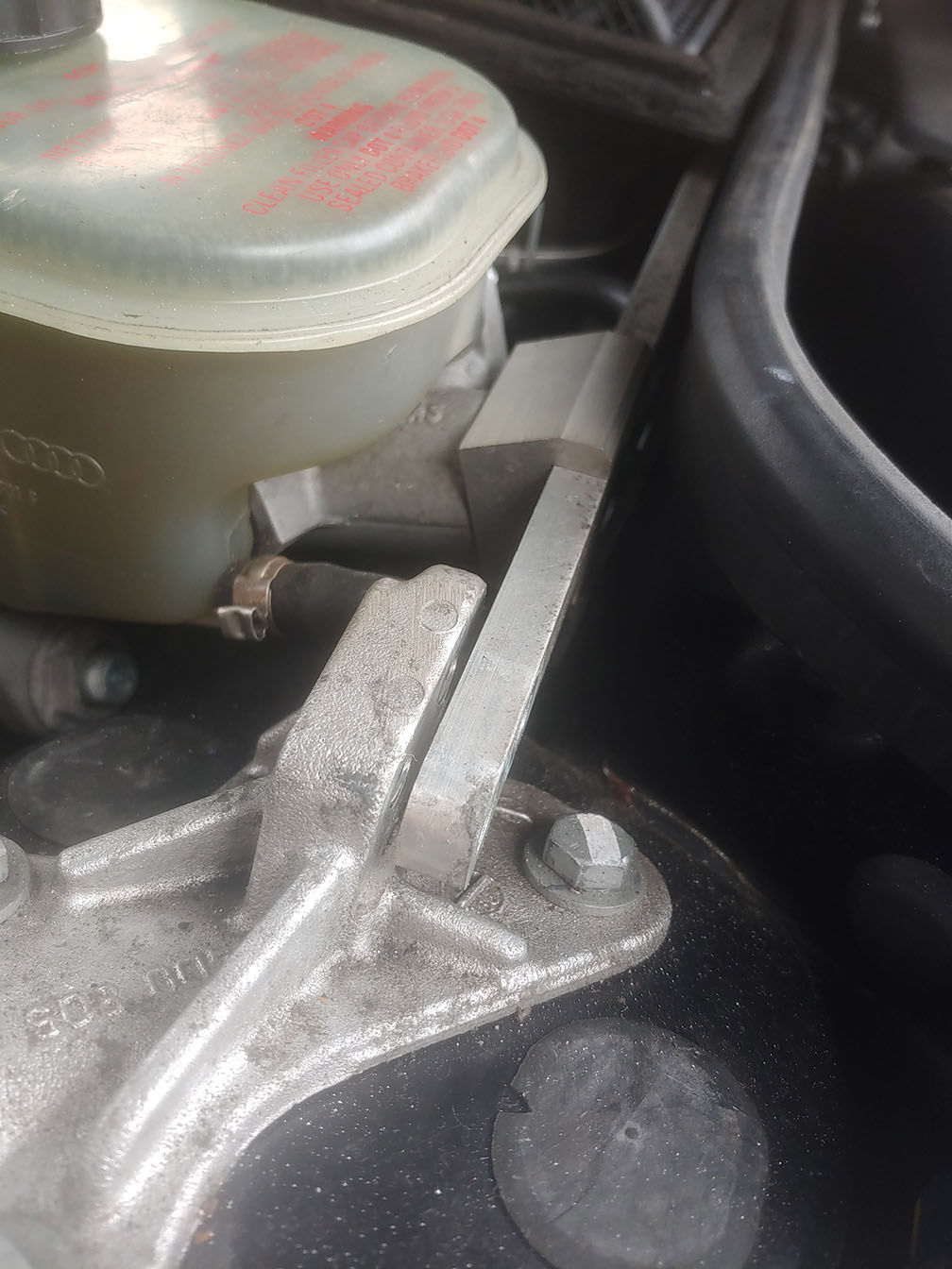

Installed mine today.
Short test drive along my daily commute route.
And WOW!
Honestly expected something along the lines of a slight improvement that you'd need to be paying close attention to notice. But no, seriously, this easy mod shortens the pedal travel, reduces the inherent sponginess and makes braking feel much more akin to the sharpness of the D3.
Feels like I've just upgraded the whole brake system. Over the moon. I've spent lots of 35 pounds on my D2 but this is definitely the most and best value for money to date. And especially for the time it takes.
Thanks MJ for going to the bother of manufacturing these!
Gregor
(Yes, I did replace the bolts )
