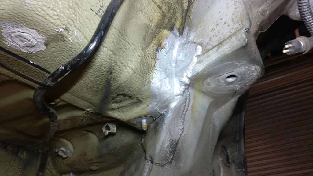

Painted the repaired area today but that's all. I'll hopefully get the tank done tomorrow.
Silver rustoleum. Not like it actually needs painting since it won't rust, but it seems incomplete to leave it bare...
